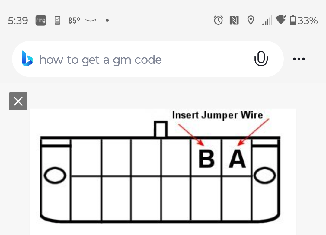

Originally Posted by s carter
Jump A to B with a paper clip, count the Check engine light pulse code 12 three times will appear then each set of codes after will pulse 3 times until you get a code 12 again

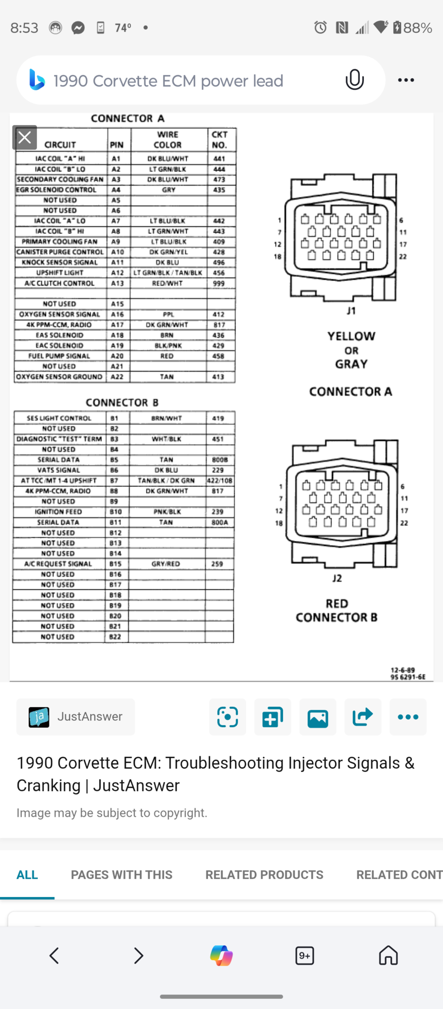

But if you just turn the key No Check engine light comes on, if that's the Case you need to dive into why no power to the ECM
Any idea which wire on the back of the ECM is the power wire? I know there’s four plugs ABCD NOT SURE ON THE PINS THOUGH

I think you need C D…post #2
https://www.corvetteforum.com/forums...post1577676583

3. Did you follow the instructions in Post #21 and retrieve the ECM codes? (If the ECM is not powering up you can't retrieve codes. I can't tell from the thread if you have an SES light or not.) Code 46, if present, means there will be no injection.
4. Is the SECURITY light solid-On with the key in RUN? (Not "flashing" with a door open and the key OFF, which is normal.)
No, the CCM can not be deleted unless you want to install different instrumentation. One of the functions of the CCM is to process the data for the Speedometer LCD. The LCD is just a dumb display, the processing for it is done in the CCM.
Using the diagram in Post #21, jumper cavities A and G. (Top Right to Bottom Left.)
Turn key to RUN, watch Speedometer. There will be a small number which indicates the module (1 = CCM, or 4 = ECM) in the fuel area and a larger Code number in the speed area.
Watch the codes, write them down including the little module number. If you get lost or want to see them again, turn the key OFF, wait 10 seconds, and turn key to RUN. It starts over.
Report back with the codes. There will be C code(s) in Module 1. This is why the SYS message is present.
Answer 4 questions, pull the codes with the onboard diagnostics using A and G. Report back.
