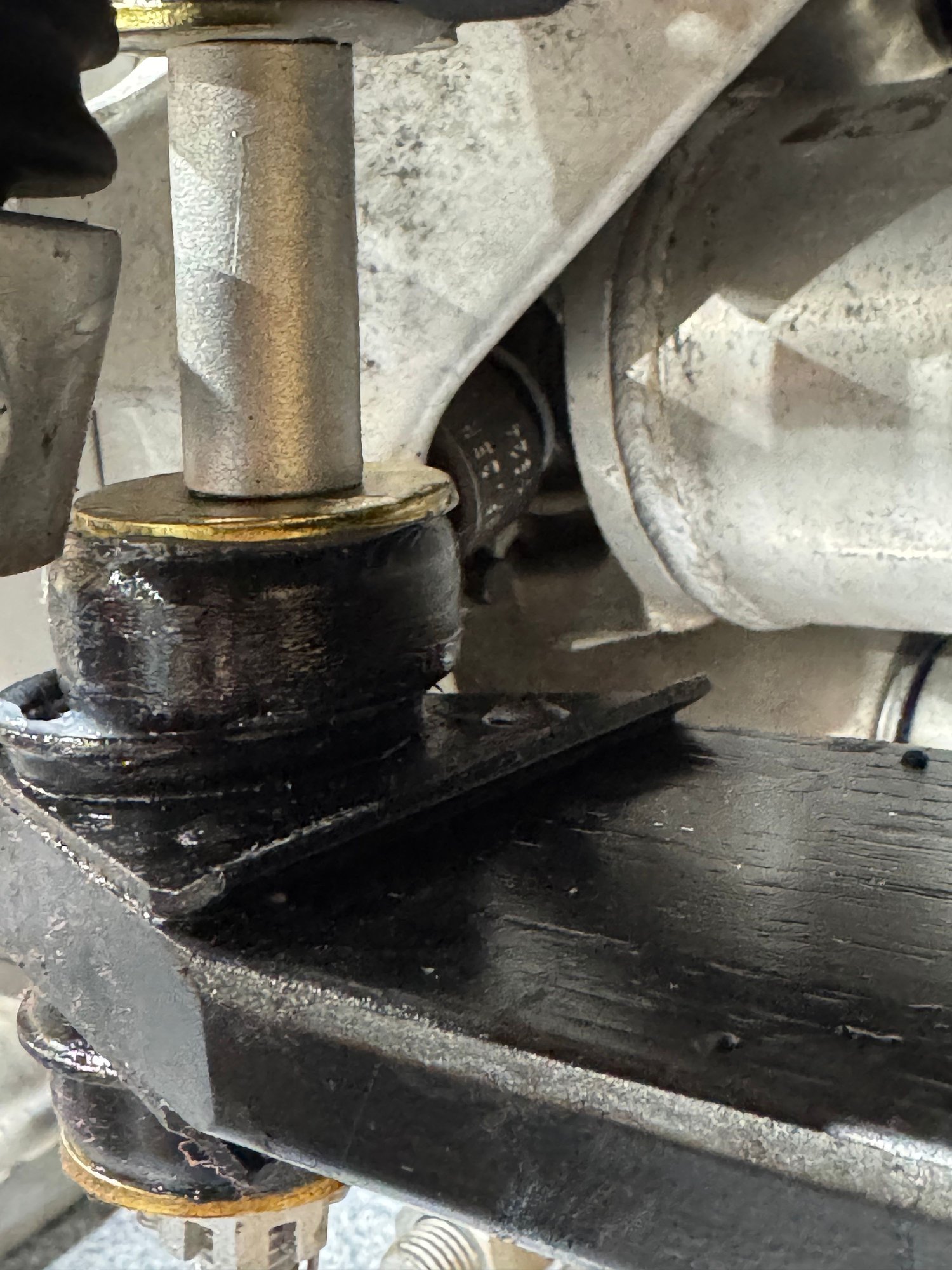

So I ordered a set of poly bushing for the rear spring and it comes with 4 bushings and 4 washers. On my 84' it had 4 bushings and 4 washers with a center sleeve like an old school sway bar link. I can't find any install directions on this subject but do I just use a bushing on the top and bottom none in the middle and no sleeve? Just confused because one kit is said to do the whole rear not just one side.

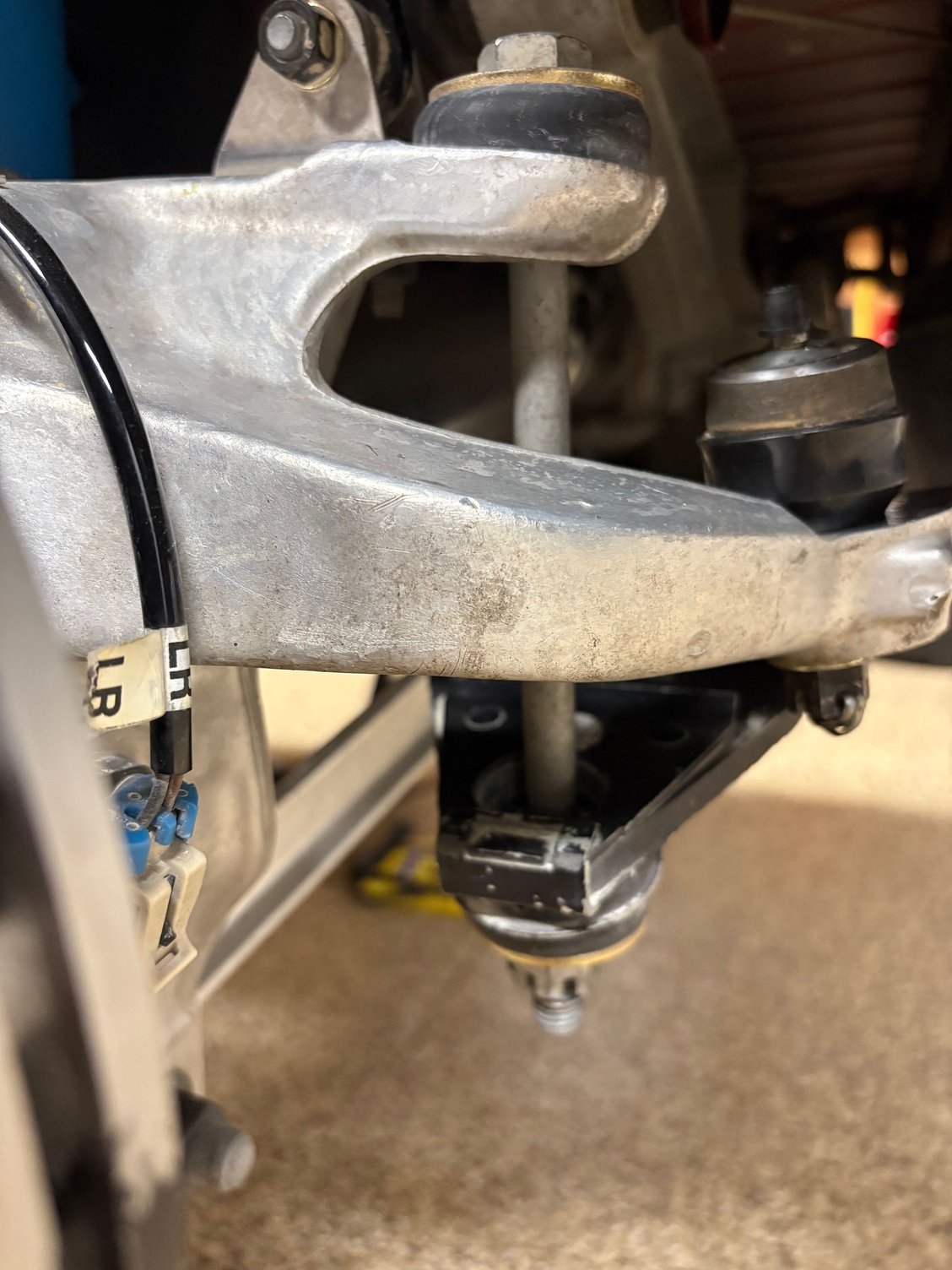

I don't know about your year but this is the setup on my 96. Dan

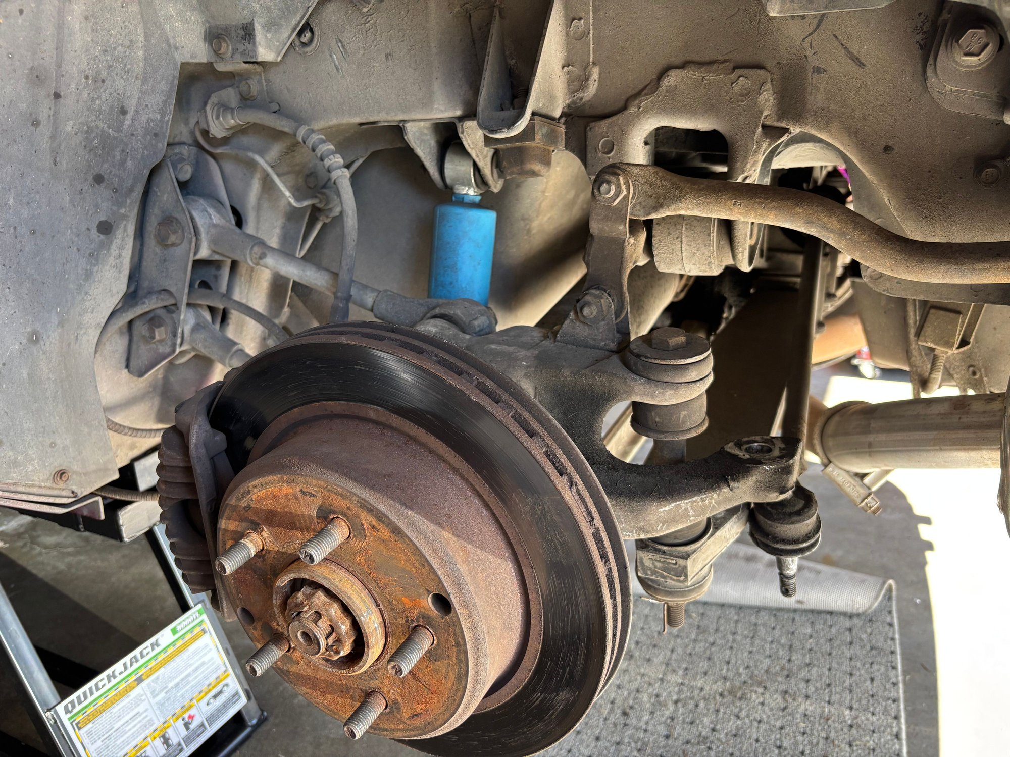

'84's have four bushings on each side. Looks like the bushing kit sent to you is not for an '84.
Here is a pic of mine in the middle of installing new u-joints.
looks like new bushings are in my future soon.

For more info from another forum member check out post #11 from my recent u-joint replacement thread.

Yes mine has the 4 bushing setup like the other 84'. I did install the poly's the same way but my issues is the bushing on the top side of the spring does not want to seat in the cup. This is while the car is on the lift hanging it may seat itself on the ground. No poly bushing I have seen specify any certain years all say 84-96'. Dont know is I should chance the poly's or get factory rubber's. Wondering if it matters if I go the two per side like the latter years and when you do the longer lowering bolts they use one two as well.

Because of the angle or the cup dimension? Poly bushings can be shaped and they also cold flow quite a bit to conform/fit over time.

Correct even when I lift it up it still wants to pop out. which is why I'm wondering if I even need the middle bushings.

I think that will pop in place when you lower the car to thew ground and the angle on the spring improves

I'm going to see what it does once on the ground it might ride to high anyways with that stiff spring so it may get lowered.
