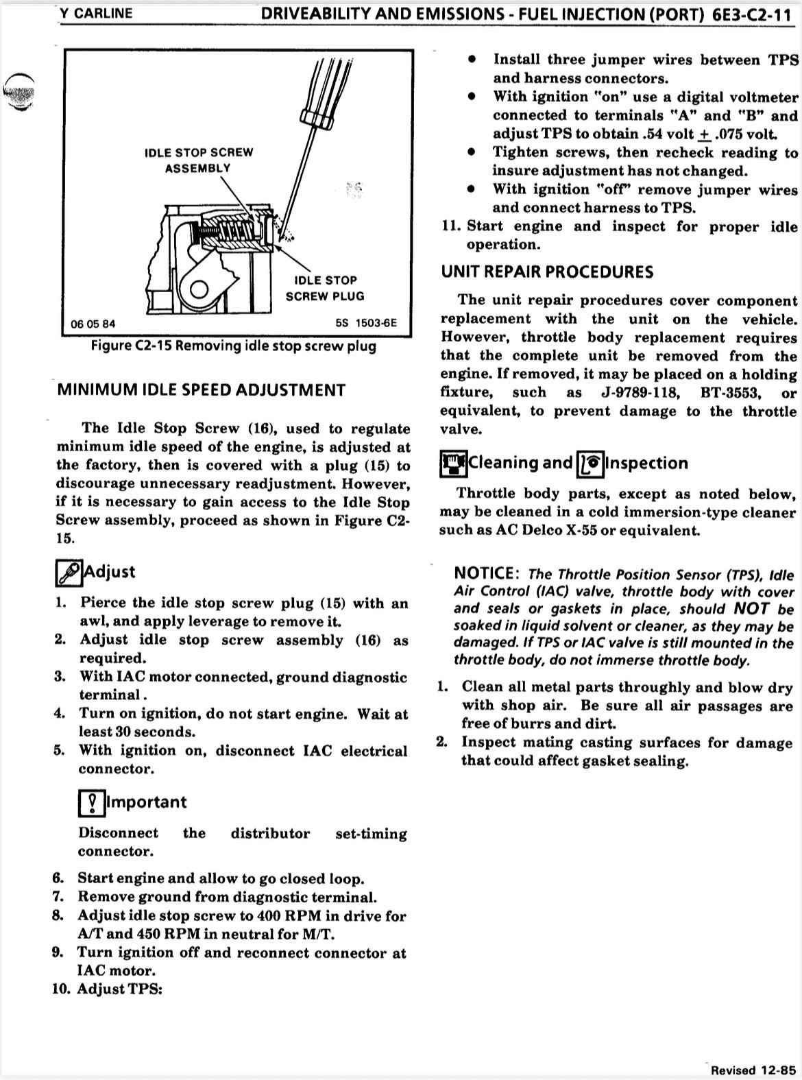

It does sound like you need to do a minimum idle adjustment since you removed a vacuum leak that was keeping idle up.
From my 86 service manual

I have followed the steps above but it made the idle worse.
did i just do it wrong?

Possibly
Were you able to get it to idle when IAC was closed and unplugged ?
Yes only after turning the screw in a bunch then I backed it down to about 550, it kept stalling much below that. How critical is it to get to 400? I will try again later tonight in case my error is the issue, is it critical to be cold at the beginning of the procedure or if I start while it is already warmed up will that be okay?

Cool. If you had to move the adjustment screw 'a bunch' then whether it fixes your stalling or not, the min-air needed to be done as a baseline.
Because, as you see, when folks come through talking about idle, 'did you do the min-air?' is one of the first things that are asked.
