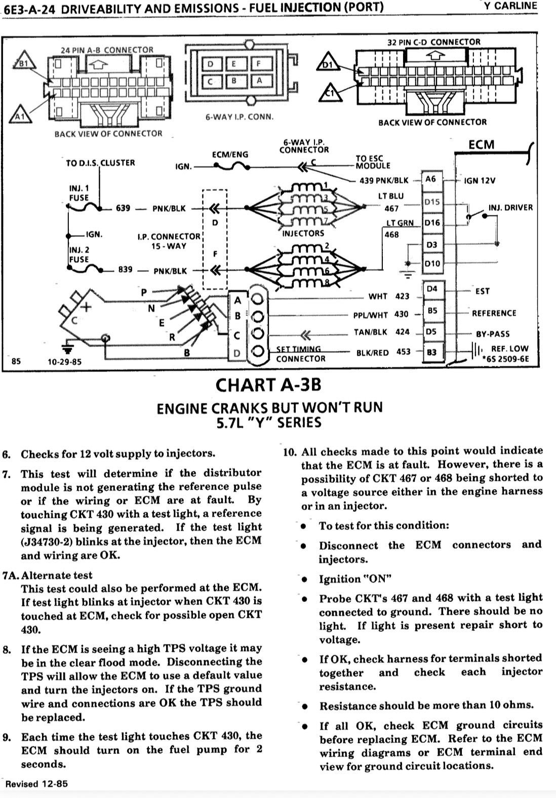

I will do the test again. I'm not that good at understanding these instructions. I didn't see anywhere that it said use a noid light. I used a test light
The test light is used to probe the 4 way connector on ECM side.
Injector test light is a noid light

Just to verify, when you did step 7, you had the test light connected to battery positive when probing 4 pin connector ?

I miss understood the instructions and what you was asking. the instructions says: did the injector light blink, no. I put the noid light back in the harness and connected the test light to the + battery post and touched the test light to the 4 way momentarily (430) and the light stays on. doesn't blink. I also put the harness back on the injector and the light stays on

The noid light should flash on then off when you touch and remove the test light from 430.
Sounds like that is what basically is happening as per the flow chart ?
As I suggested way back, you may want to try a different ignition module.

I installed a new old stock GM ICM module that I had tested at the parts store before installing and it tested good. I also installed a new vats module. I have spark and still no noid pulse when I try to start it. I started running the test that you posted. tell me if I did it right or wrong
switch on, I have power on both side of the injector harness, then I put the noid light in the harness and with a test light connected to the positive side of the battery I touch the distributor at connection 430.no blink on noid light. I did test # 8, still no blink on noid light. test # 9, I didn't hear fuel pump or relay. But I do hear it when I first turn the switch to on.
I'm new to some of the testing it says to preform. when I test connection B5. Am I testing for power or ground. I have changed the ECM prior.
Is the 4 way connector unplugged and are you touching 430 on the ECM side of 4 way connector. You mentioned touch the distributor at connection.
Is your oil pressure switch functioning properly and wired into the fuel pump circuit ?
When you turn ignition on and hear fuel pump run, check ECM terminal B2 and see if there is battery voltage there when pump runs for the 2 seconds.

I redone the test touching 430 on ECM side, no blink on the noid light but I can hear the fuel pump running. I did step # 8 and I could hear fuel pump but no noid blink.
Switch on, I did step # 9 with test light to ground on D15 and D16. No power on either.
Were the other 7 injectors still connected ?
There should be battery voltage at D15-16 with key on, unless all injectors are disconnected, both injector fuses failed, ignition not sending power to injector circuit or faulty connection between ecm connector and injector harness.
Which one is it ?

all but one injectors were connected. Remember Agent 86 this is a engine swap using a Painless stand alone wiring harness and does not have the fuses like a factor C4. I will contact Painless and ask them about D15 and D16 not having power.

Step 10 bottom right

You must have an electrical diagram from painless. Can you post it ?
