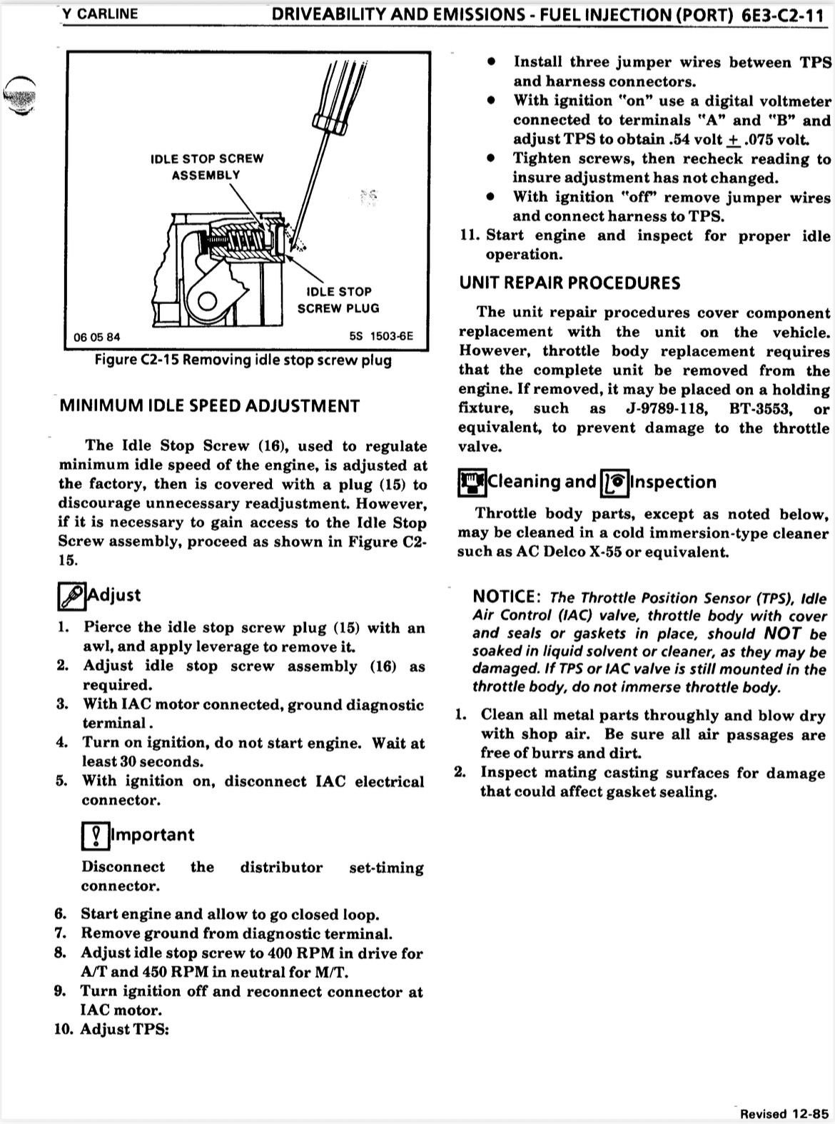

Have you tried to set minimum idle adjustment ?

Yes I set it at 6 btc for the initial timing so it can advance, but I will try that minimum idle adjustment and see if that helps it
