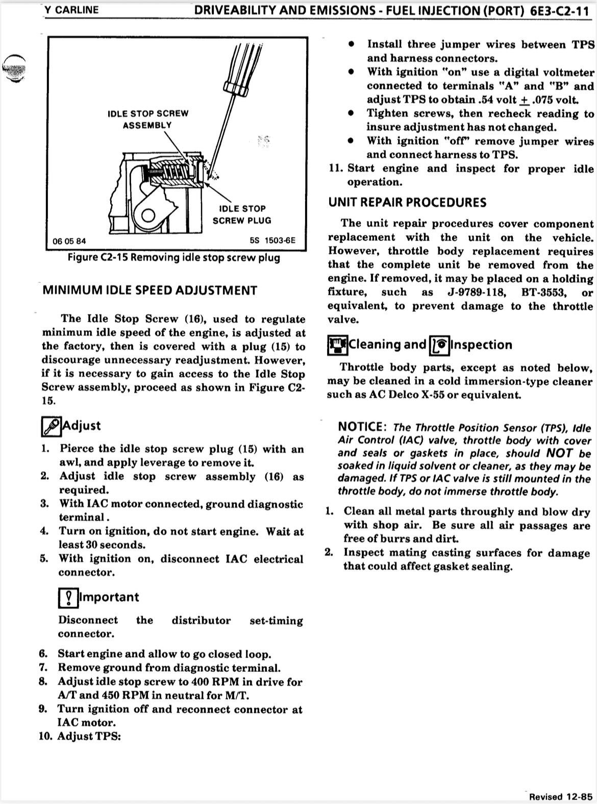

You might want to verify your timing and do a minimum idle adjustment. Should be 6 degrees BTDC with the set timing connector unplugged (single tan wire near brake booster)

Old Jan 20, 2026 | 09:19 PM
AGENT 86's Avatar
AGENT 86
Active Streak: 90 Days
Joined: Jan 2003
Posts: 20,318
Likes: 248
From: Summerland B.C. Canada
For some reason it is not showing the page from manual, maybe it will show up on your screen.
