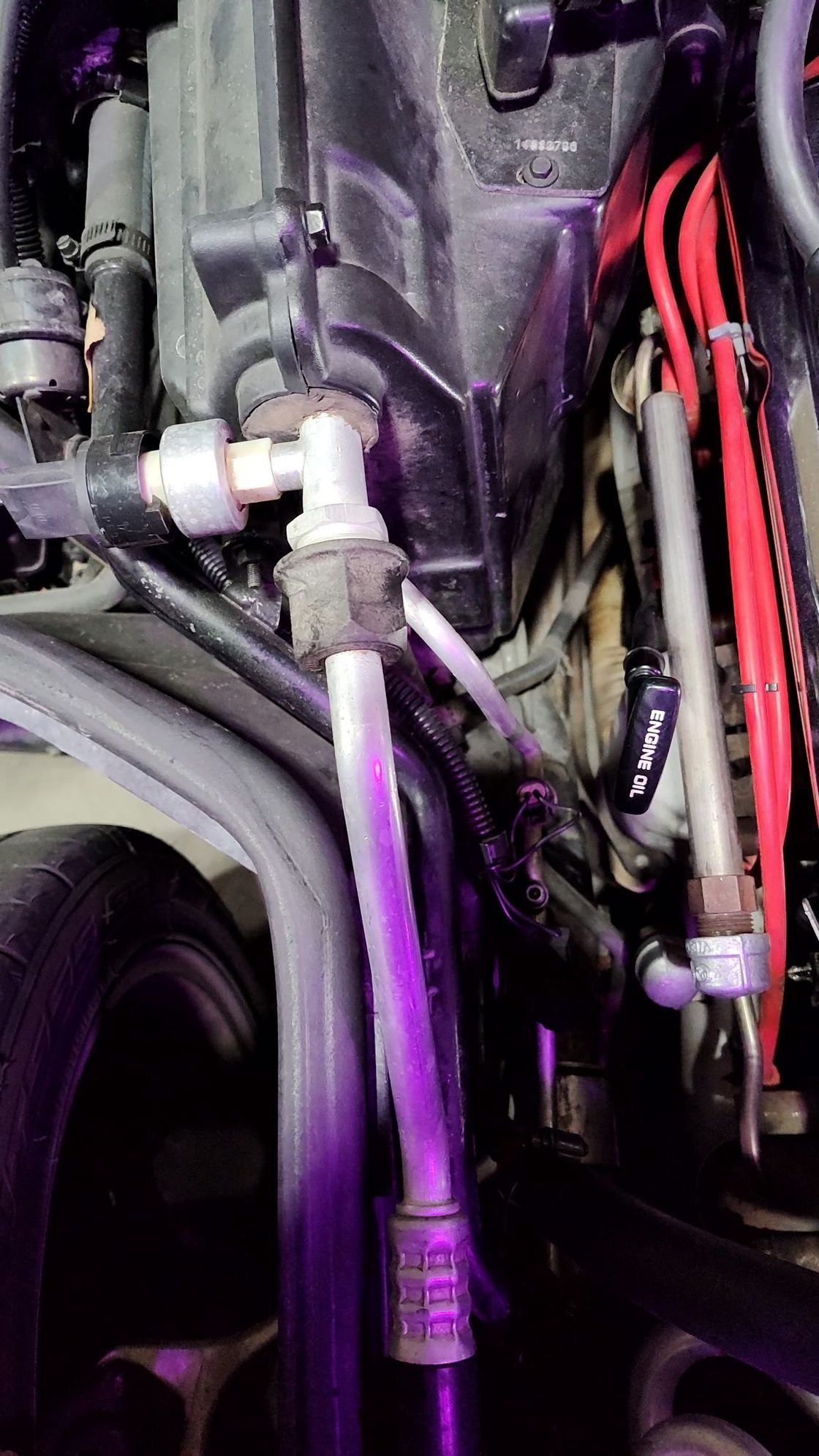

Hey all, doing some tune up changing out spark plugs. They were super tight from the previous owner and when number 4 broke loose, I snapped this sensor. What is it? I can't seem to find a direct replacement as I originally thought is was A/C but the female fittings are all too big (1985 z51).

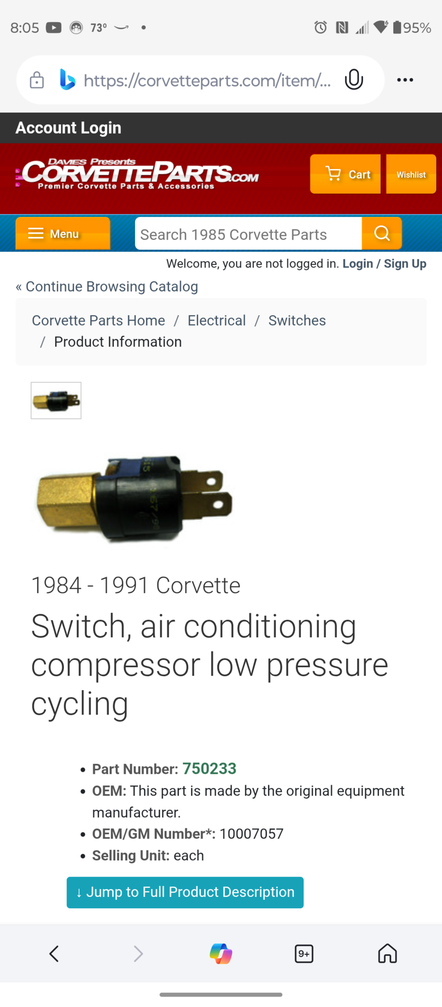

Is this it, working from memory only.
If so you might need to climb under the hood of some old GM vehicles in a Junkyard.

It could be, I've bought a few low pressure cycling switches and they were all too big. Are these no made anymore?
That is on the liquid line so it is a high pressure switch.
EDIT: The original part # is 10007057 but may be discontinued. You'll have to trace from here.

I ran the number you gave, available
https://corvetteparts.com/search?q=10007057

This is the problem I've been having, the low and high have the same part number but different female sizes
There are (2) switches on that line. Both are Normally Closed contacts, but have different pressure thresholds and different connectors.
The one that is broken (larger connector) is the Compressor Clutch Cut Out. Basically a safety shutoff if high side pressure gets dangerously high such as if the electric cooling fan malfunctions.
The other one (small connector) is the cooling fan request switch. It opens to send a "fan request" signal to the ECM to turn on the cooling fan. (This input is independent of the Coolant Temperature input.)
^^^^^^^^^^^^ Not sure where you are getting your info from but definitely wrong. The low line cycling switch operates ~25 - 45 PSI. The high line high limit is ~450 PSI.
Well, I know it's not wrong because I've given the part number to multiple stores and have received different switches. The switches themselves have the same part number, but do not thread on as they are larger. I do appreciate your assistance, it looks like I'll be going to some junkyards! Lol
^^^^^^^ Well, in my books, if you receive two different switches but have the same part number, then that would qualify as "wrong".
