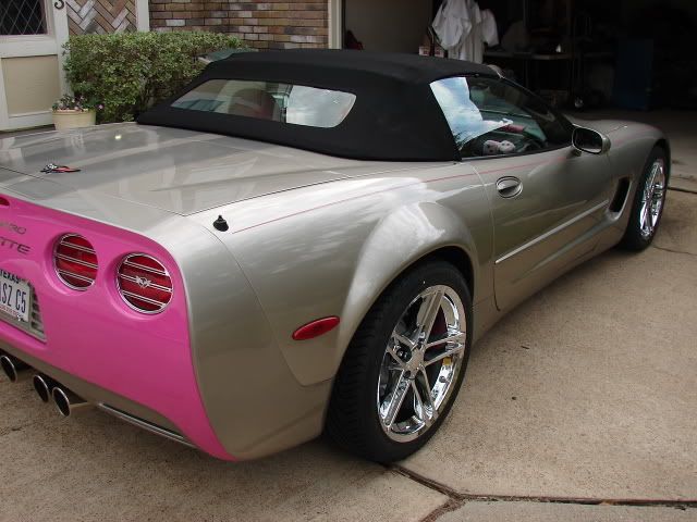

My MPS 345/30/19's have a 27.4" OD and they occasionally rubbed even with Lingenfelter Mini-Tubs. Now with my flared rear quarters & 3/4" spacers all is cool. Offset is critical
sweet!!
who fenders and hows the quality
http://www.lewisfivemotorsports.com/index.html
Thanks Bro...Quality & Fit is excellent, they are fiberglass...Cajundude sells em, I believe you know Jason
