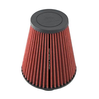

Something I was looking at, but it's kind of objective too. For one, I think the rating is subjective given the FI on the car. There's two turbos feeding the motor, so couldn't you say that two 450cfm filters would feed the motor??? I'm looking at getting rid of the APS inlet issues being both the collapsing inlet tubes and the pancake tubes which I'm sure aren't helping either.
The filter I am now SPECIFICALLY looking at trying to make work is the Spectre hpR #889609. It's got a 2.5" ID throat, 5.6 to 3.25" taper and from top to base is 8" long, and has a CFM rating of 705 according to the manufacturer. The length is going to be the killer I think as I don't think an 8" filter will fit on there.
Here's a pic of the filter itself:
Link: http://store.summitracing.com/partde...art=SPE-889609
It's essentially the same thing as a K&N, oil cleaned, warranty, ect.
Even if the filter is more restrictive than the APS dual entry whatever brand it is filter, I think that a slightly more restrictive filter will still negate any power losses seen with collapsing intake ducting on the APS inlet system in the first place.
Remember the 350ci engine needs about 630-650cfm or so.
Boost it to 14.7psi and you need 1300.
450+450=900, which would only support about 450 N/A cubes.
Realistically, my goal was to get as large a filter in there as possible without changing too much.
Just making sure there is LESS restriction overall was my main focus.
I, too, think you may have space issues with that filter, but it's worth a try.
The length is the killer.
If you can make them fit, and they flow 700cfm as stated, you will flow total about 1400cfm, which theoretically supports about 750 cubes(or750-800fwhp)
My goal was to put an even larger filter on my car, but since I stuck with the 2.75" hose, I did not have ready access to one.
One thing is for sure, the mods I did to the inlet piping seem to have done the trick.
The car is making about 1.5psi more now at the same evc setting.
I haven't tried turning it up yet, so no higher boost results yet.
One other thing.
Have you actually SEEN the steel reinforced APS hose collapse under vacuum?
I honestly have a very tough time believing that tubing will close due to the vacuum from the turbo.
I mean, it's steel reinforced!!
Tough stuff!
The only possible reason I could see that hose collapsing would be to restriction in the crush section(slightly possible) or restriction at the filter.
I don't know, just curious, as at least one other has mentioned it, but I think it may be one of those unseen urban legends.
