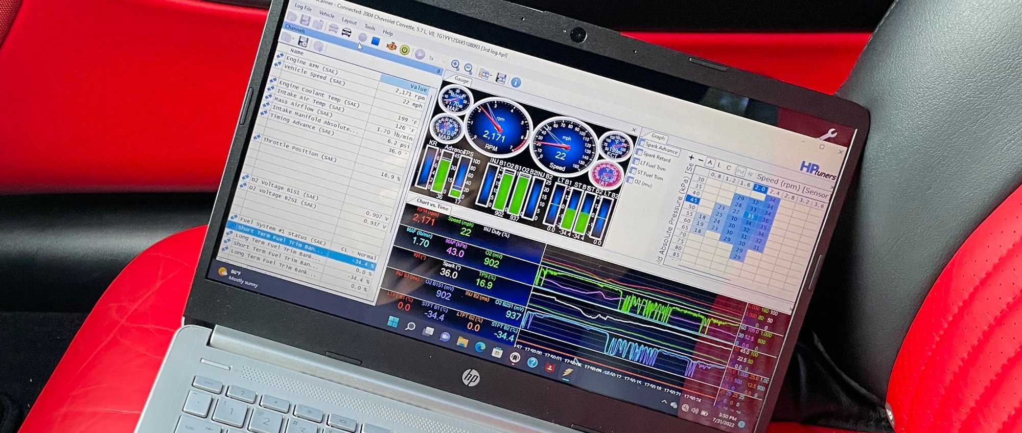

Small update. I temporarily disconnected the meth setup and capped the external fuel pump / FPR / return setup, so now it is running a basic stock C5 returnless setup with the new 80# injectors.
Before:
After:
I am still logging -34% STFTs. Sent some logs to Vengeance this week. Will hope to figure out a solution soon.

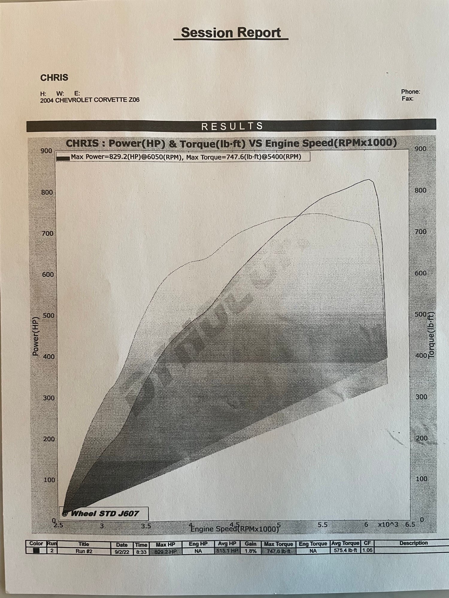

Boy what a day! I ended up taking the car to a local LSX shop last week to sort the tune issue and got a call today saying they had street tuned the car and were about to put it on the dyno. They looked at multiple issues and think the problem may be an O2 sensor related issue. Ultimately they ended up doing a speed density tune in open loop to get the car running.
So the car ended up making 829 / 747 at 13 psi lol. I was expecting maybe like 650ish but wasn't even close. And this is only with 14 degrees timing. Honestly we didn't want to push it any more since I'm still on the stock bottom end.
The car drives so well right now. There is no surging, no idle hunting, no bucking or stalls. It's like a night and day change from the way it was running. Shout out to Calibrated Speed and Performance here outside of Birmingham. Austin there really did a great job and I'm very pleased.
Now I've got to figure out what to do moving forward lol. I think I'm going to have to either do a forged rotating assembly with the stock block or just go with a new forged motor / bigger displacement and pulley down. Then we can sort the fuel trim issue at that point. I would have liked a closed loop tune, but honestly I'm just happy to have the car running normally again so I can cruise around town.

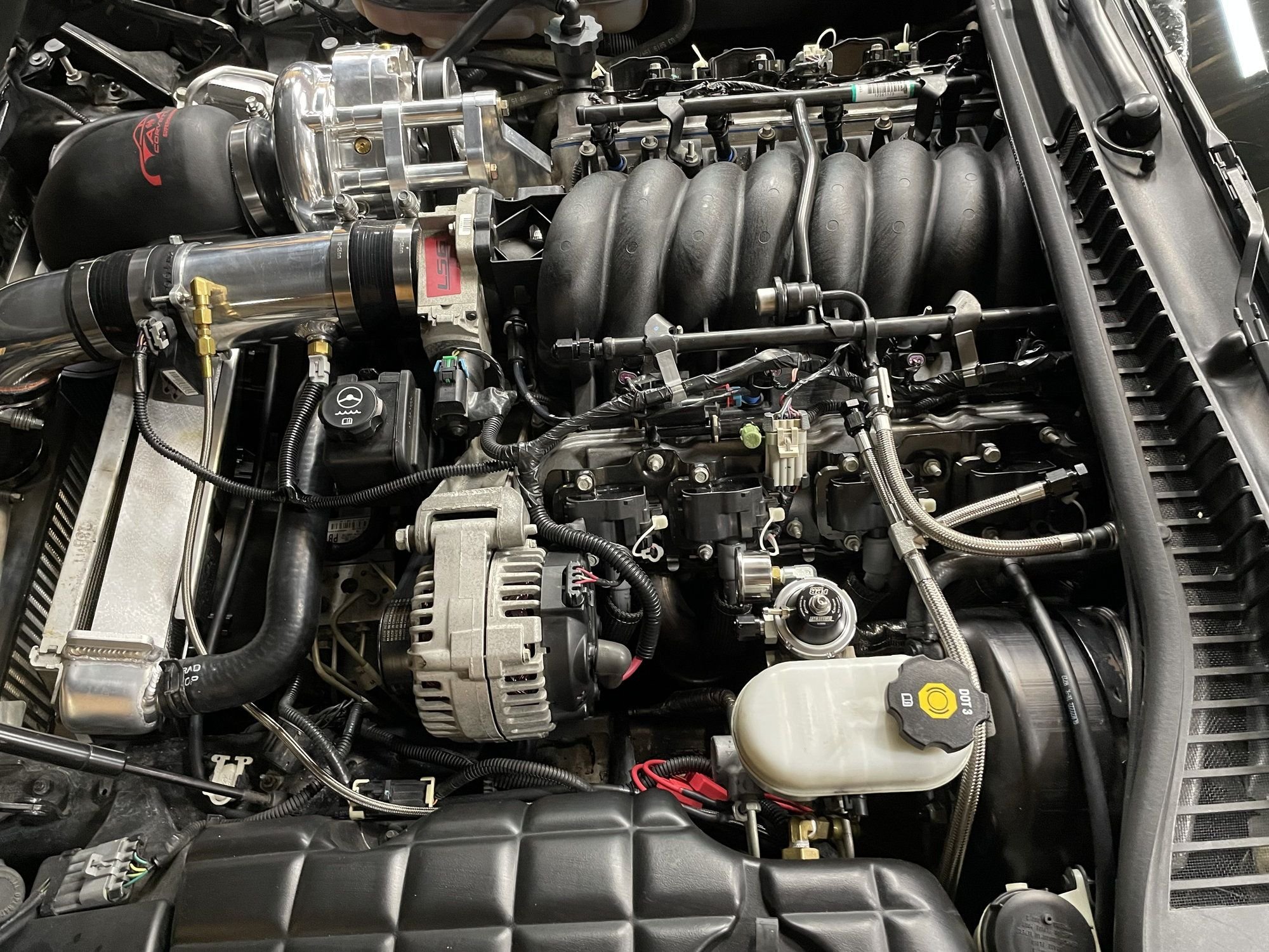

Thanks. So the final mod list...for now lol:
A&A V3 Ti with 3.6" pulley
80# Deka injectors
52mm Turbosmart BOV
NGK TR6 plugs
2 bar MAP sensor
IAT sensor spliced post MAF
A&A external dual fuel pump with return
Turbosmart FPR2000 - static
Alky meth injection
Tick stage 2 blower cam (227/243, .625"/.615', LSA 116+6)
Straub trunion kit
Tick hardened pushrods (7.375")
Tick .660" dual valve spring kit
Stock lifters
Stock heads
Stock bottom end
ATI stock sized balancer - pinned
ARP crank bolt
Katech C5R timing chain
C6 PS pulley
Melling 10295 high pressure oil pump (red spring / black o-ring)
Dewitts cut down radiator / cradle at stock height
SPAL fans
Stock thermostat
LG pro long tubes 1 7/8" with catless x
Borla stingers
ECS diff brace
Mantic twin disc ceramic with lightened steel flywheel
Hurst short shifter
Antivenom mod
New TOB
New stock slave cylinder
AEM wideband
Autometer boost gauge
Air pump delete / exhaust block off
EVAP delete from driver's intake manifold
Vibrant vacuum block to T fitting in brake booster
(2 lines to external fuel pump hobbs at 4 psi / 7 psi, 1 line to BOV, 1 to boost gauge, 1 to alky meth kit)
New fluids (diff / trans / oil / clutch / PS)
New intake manifold gaskets
New valve cover gaskets
New water pump gasket
New front timing cover gasket
New rear main seal

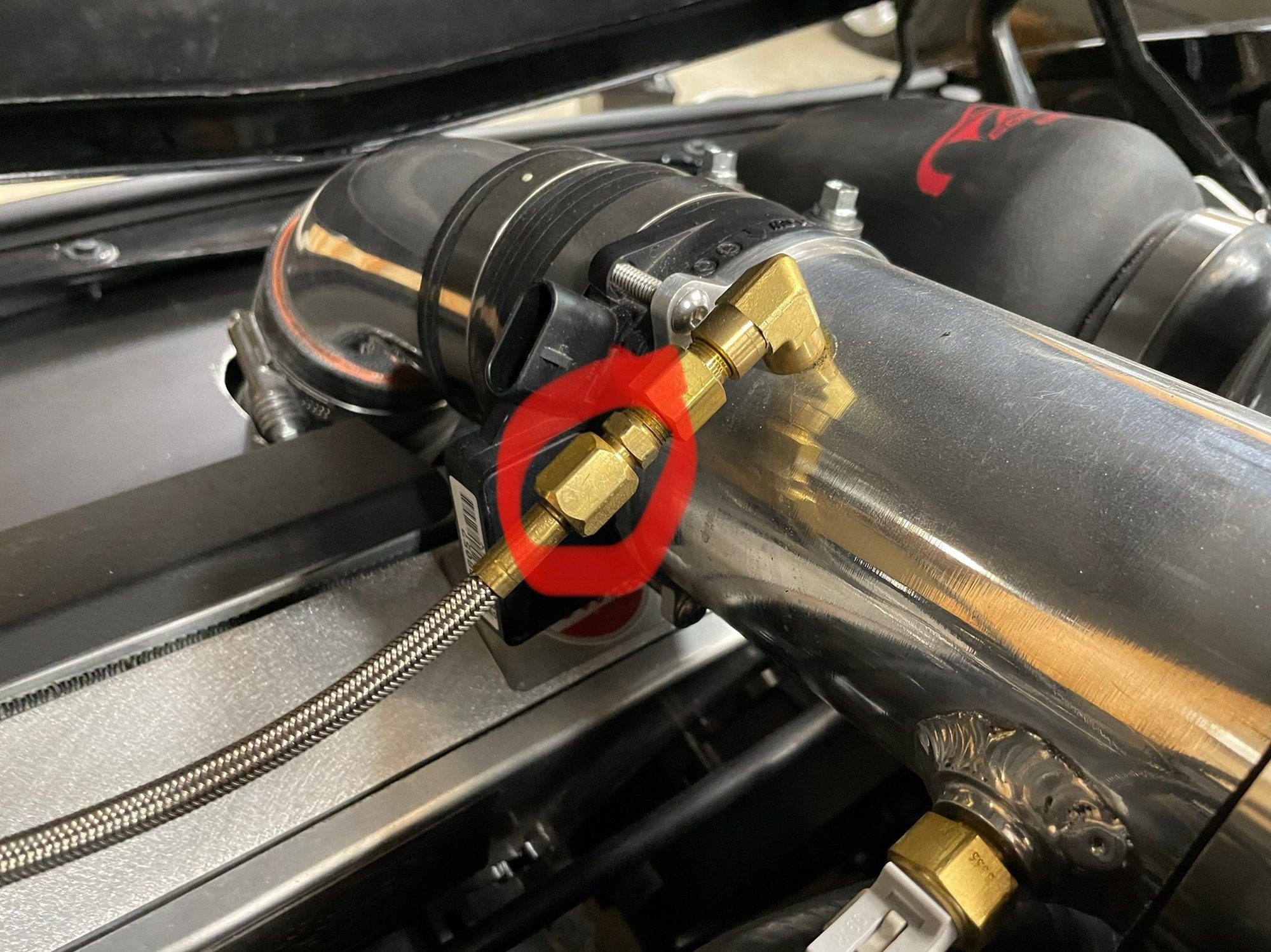

Hello,
Been following this thread-Great results!
Question: How is the meth nozzle connected? Is it threaded into the pipe or a nut on the inside?
Thank you,
Steve

Its a pipe fitting. On the inside you typically have a washer with rubber gasket as the center to seal the pipe, and the actual nozzle itself screws down into the external fitting through the hole in the charge pipe. It ends up being a nice small part which can vibrate loose and catch the breeze down into your cylinder. (!) So it is worth loc-titing the heck out of the bugger. If I still decide to run it again on mine I'm going to toss a spot weld on the tip just to be certain. I'd rather have a fugly charge tube than nuke my block.
