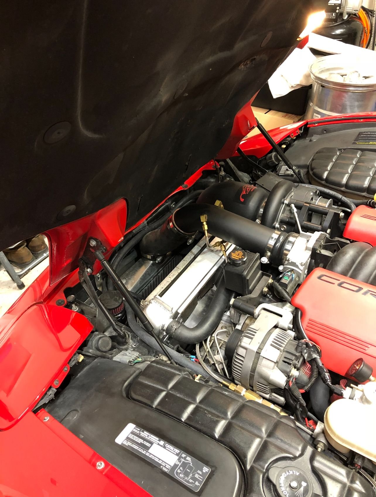

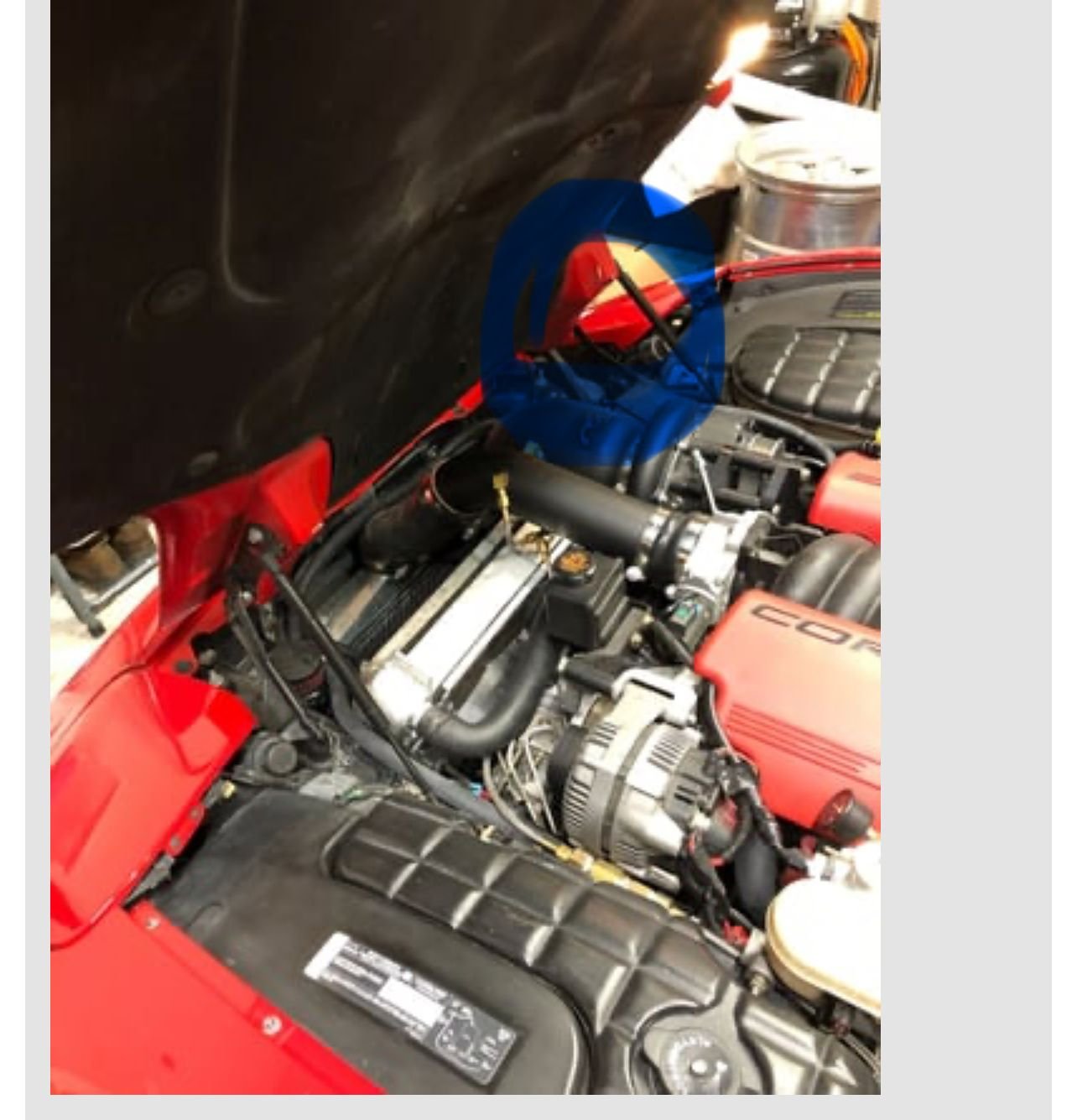

Wish I had some better pics before I removed it to go with a Huron kit. This is with the cradle at the factory position though.

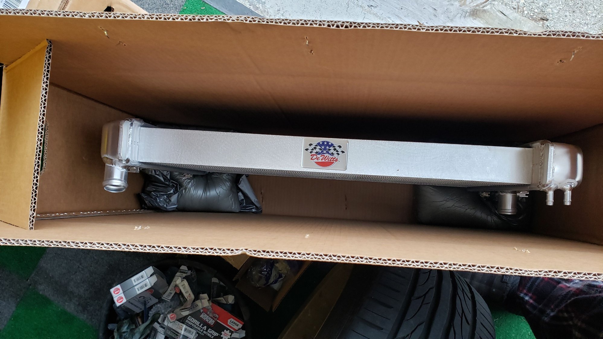

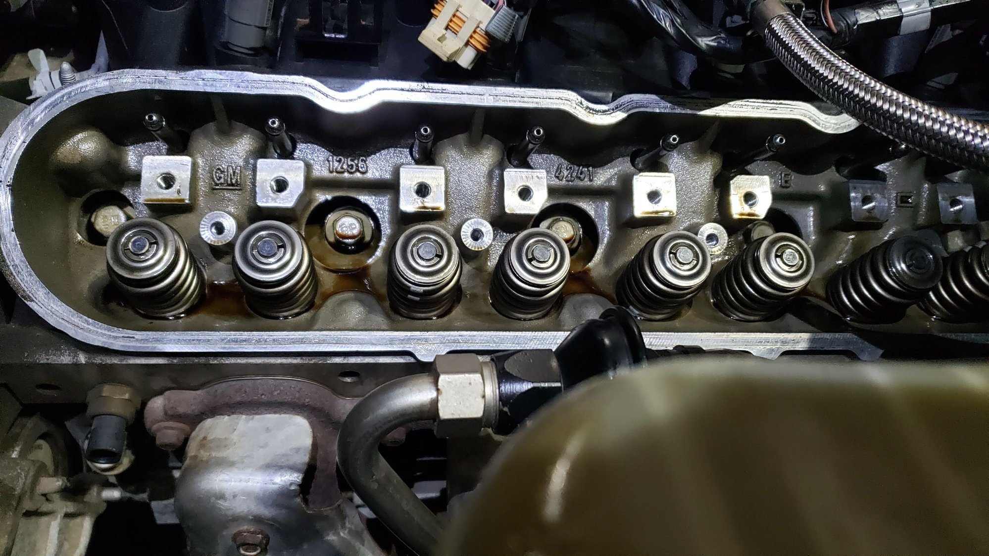

Well, I got my order from Dewitts in a few days ago. Still in the boxes so no real eye candy yet. BUT, here are some pics of the progress I have made so far.

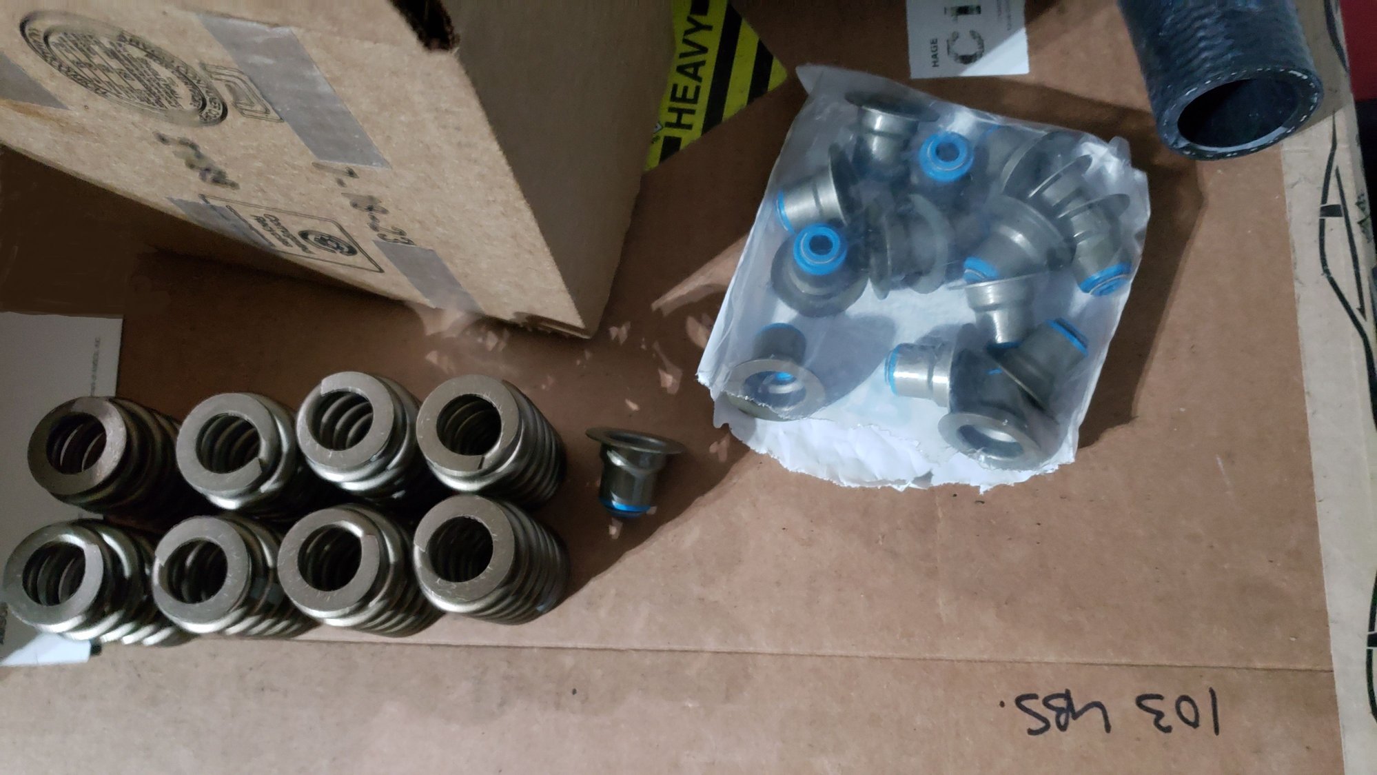

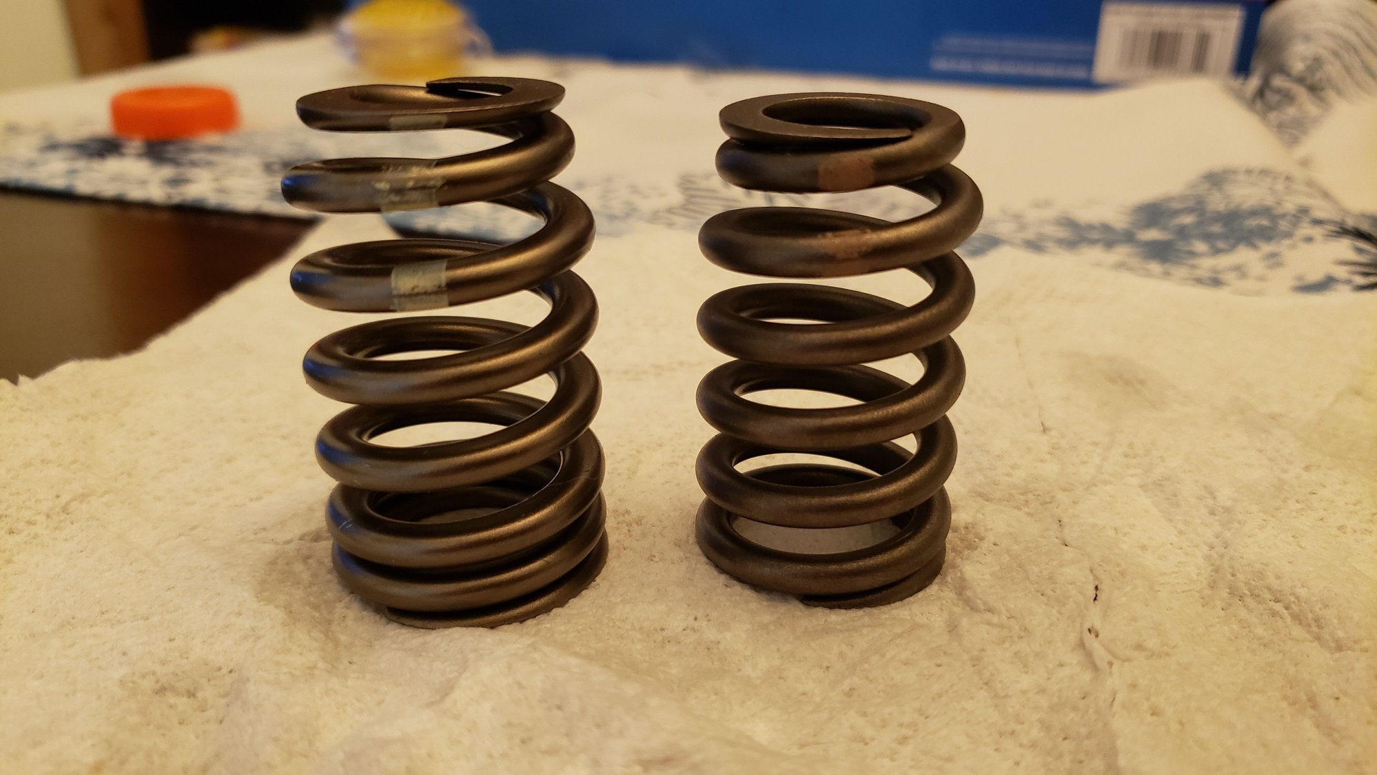

Here are the LS6 GM Performance springs I bought to replace my current 20 year old LS1 springs. Not changing the cam, so these will provide plenty of valve control.
Here are the springs. No they are not supposed to be blue anymore. I contacted Brian Tooley Racing, and they confirmed I received the correct springs.
Got new seals along with the valve springs from BTR.
Valve springs and new valve seals

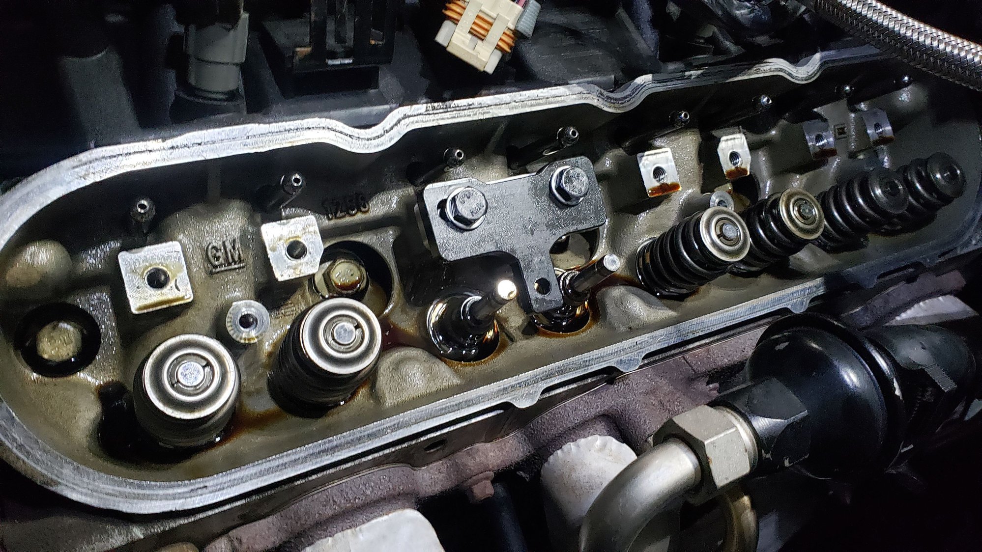

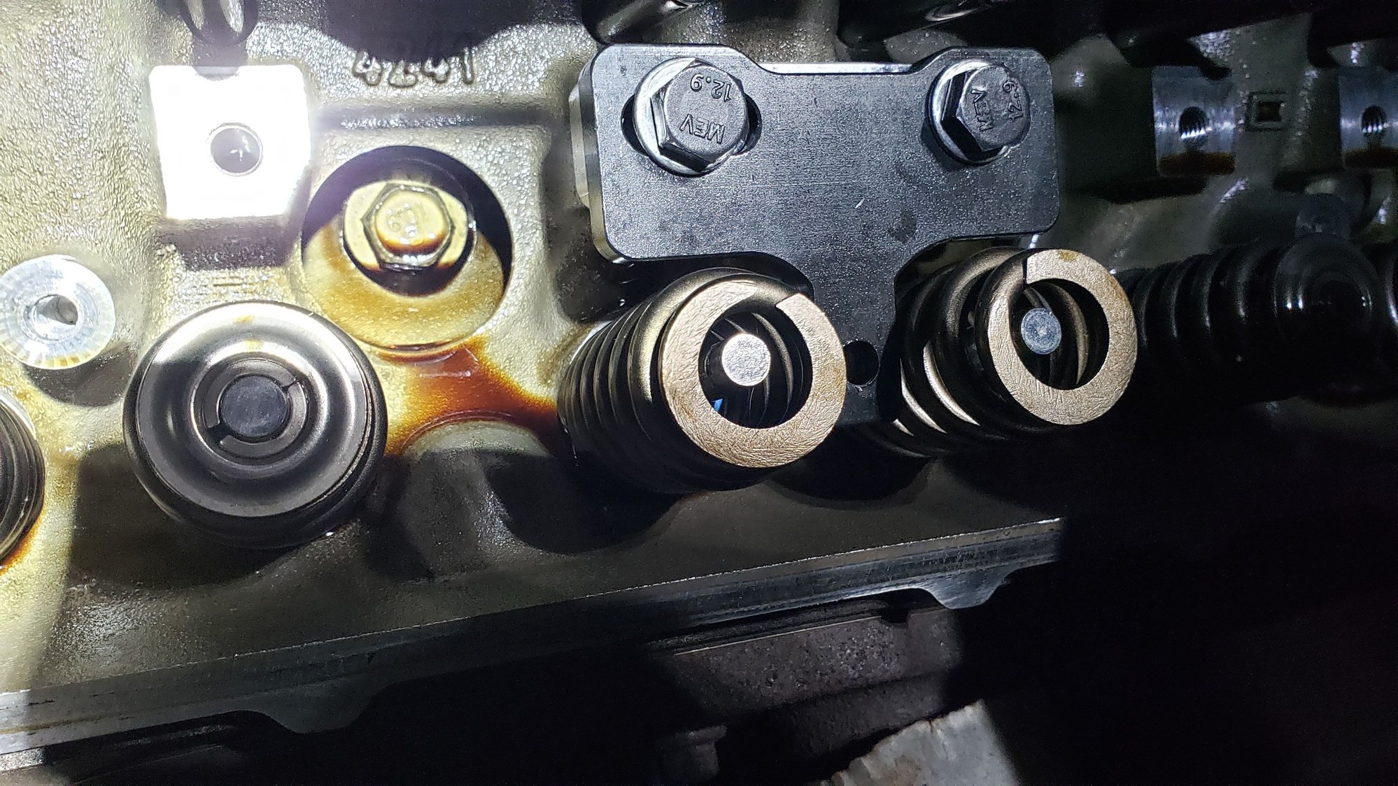

I used an air compressor, and screwed in a connection to the spark plug holes to hold the valves up. I ran it at 80psi, and did not have an issue at all.
Old springs and seals out, new seals in. These were much easier then the last 2 piece seals/valve seat I installed on my T/A.
New LS6 springs ready to be compressed
All springs installed.
Rocker arms ready to go back on in the order they came off. I did NOT upgrade the trunions. I did not feel the need to with stock 2003 ls1 cam.
Old LS1 springs and valve seals.
Here you can see the LS6 spring on the left, and the LS1 on the right. The LS6 does look taller, but I assume that is due to wear and time on the LS1. The LS6 spring diameter is bigger though, as well as their appears to be one more coil on the LS6 springs.

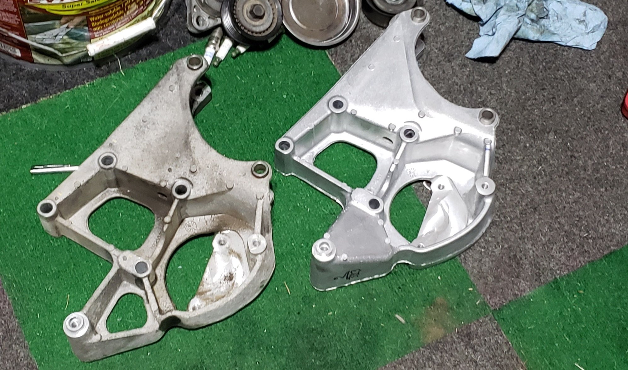

I changed out my old power steering/alt bracket for the new 2004 style one. You can clearly see where they changed it.

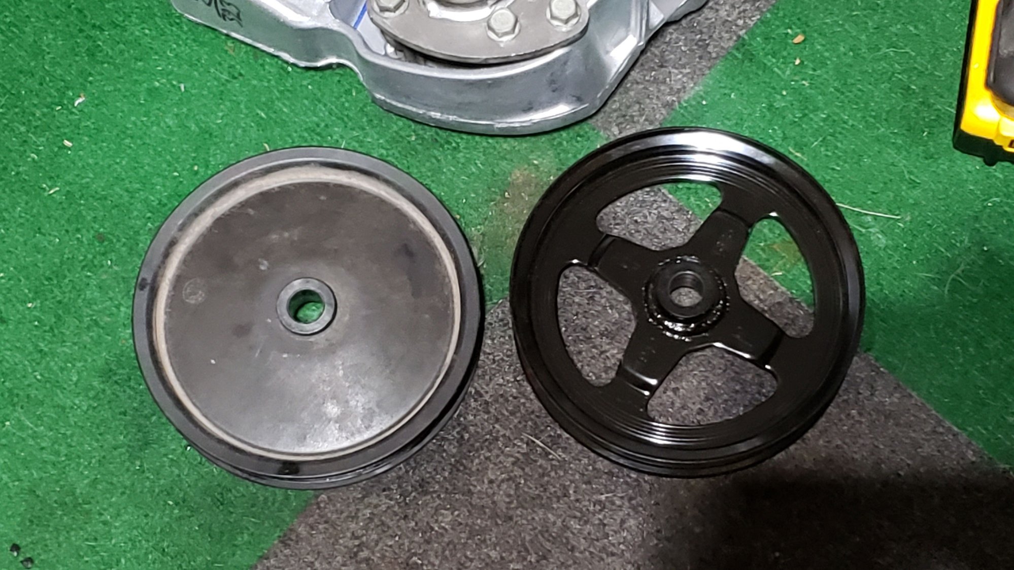

I also swapped out the power steering pulley to an LS2 style one. It is much stronger, and you can bolt the pump on without taking off the bracket.

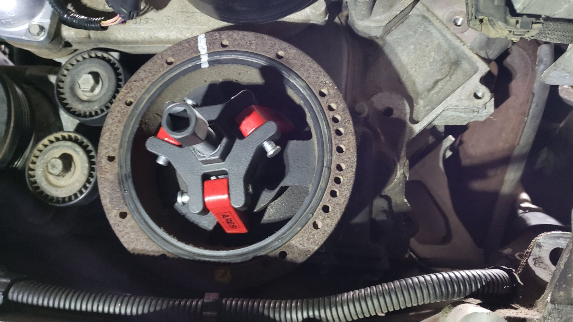

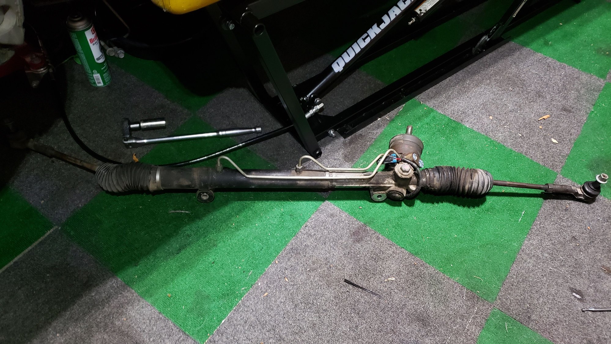

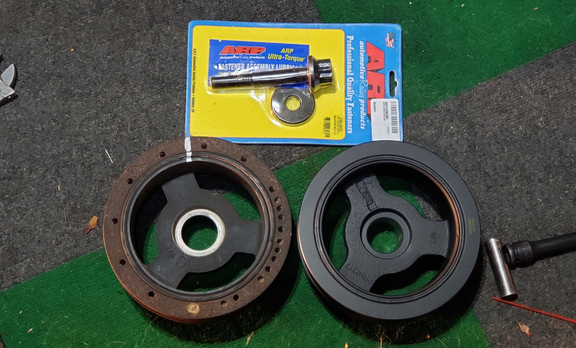

I removed my rack and pinon to remove the balancer. I was going to change the seal as well. Wanted all the room I could manage. The front seal was also change, as it was the only thing that was leaking on my Vette.

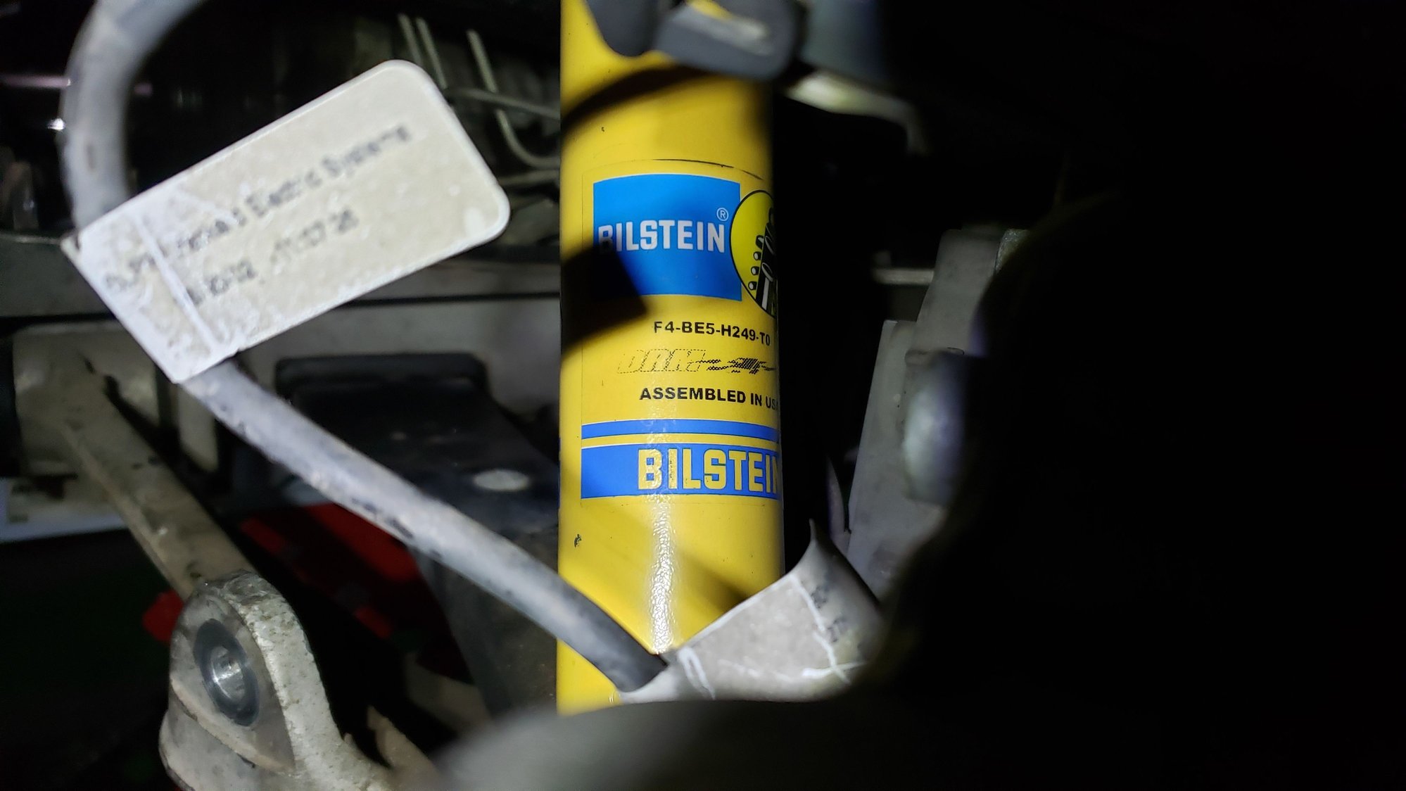

Here you can see the DRM Bilsteins I have on my car. I have the factory 2001+ Z51 springs, with C6 Z51 sway bars as well. This combination is AMAZING on the street. I am so happy with the way it handles. I have my alignment set to factory C5 z06 settings, except I only run - up front -0.4 and -0.3 in the rear.

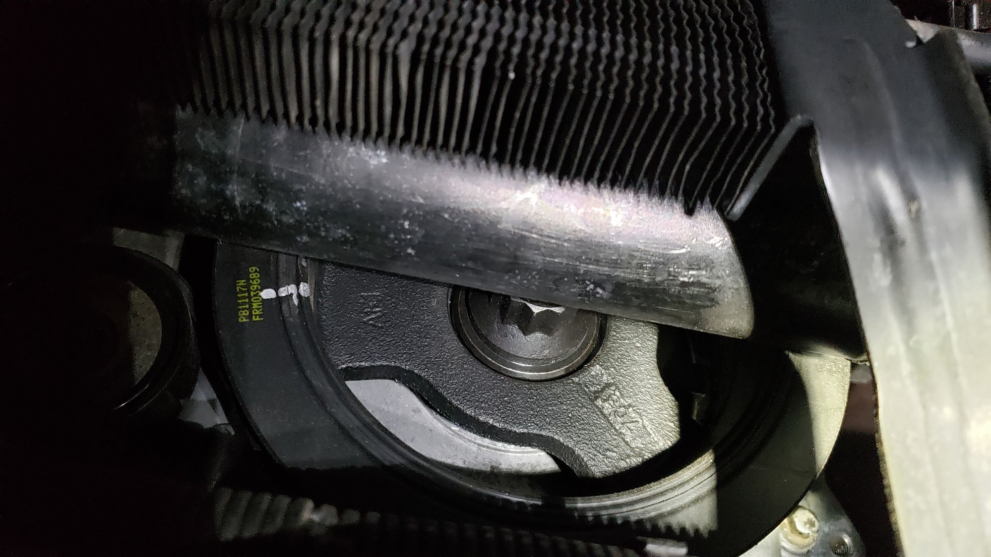

Removal of the factory balancer. You can see the silver paint line I put on the balancer about 5k miles ago, some time in 2021. My balancer did not fail, but I was already in there, so I replaced mine with a factory replacement power bond, like @Toys4Life did. I followed his video on this one.
I removed the front seal by putting screw though it, and simply pulling it off.
Here is the new balancer with the old one. I will draw a line on this one when I get around to installing it. I am also using an ARP bolt, just cause it makes me feel better about myself. Nothing wrong with the GM one, I just like the ARP torque sequence better.
Hopefully I will find time to putting some of this back together this weekend, and hopefully get the blower parts installed. I will post updates as I get around to them

I noticed in the picture that you do not have any upper radiator mounts on here. I was trying to use the A&A provided ones, and they are too short, and require about an inch spacer from the frame to the bracket to fit right. What solution did you come to for the upper mounts with the Dewitts radiator, while not lowering the radiator?
There is a mount on the passenger side. The driver side wouldn’t fit with how the catch can was routed. I used a spacer under the top mounts to make up the difference. Might even be able to use the ones designed for dropping the cradle, not sure if they will have to be shortened or not.
You know, it is funny that you should say that, cause that is exactly what I was doing! Now two of the spacers are different height in my kit, so I went and got fender washers for 1/4" x 1.5" bolts, and just installed it that way. Since you have yours set up that way, i assume it clears the hood just fine. Thanks for the advice!

If I remember correctly, I think I had to trim a tiny tiny bit off of one of the humps of the hood, but it was very minimal, and worth it to me for the added ground clearance. When you close the hood for the first time, just be cautious and slow, if it rubs anything, you will be able to tell before you out pressure down to latch it.
Edit: I think it was right in this area, and it was just a little notch.

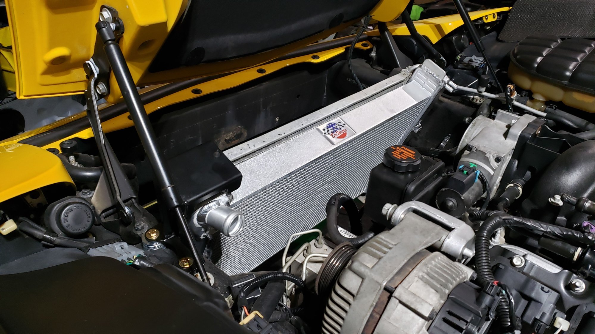

Some updates for you guys. Got the Dewitts radiator installed with the help of this thread.

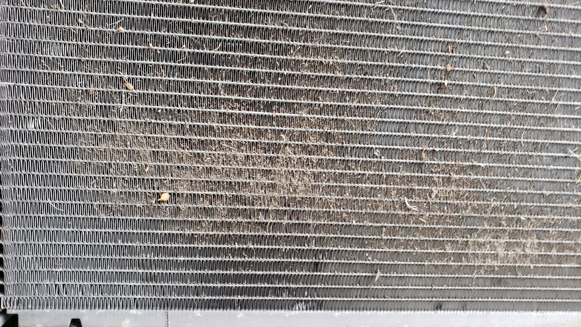

Removed the old radiator, that thing was in there pretty good and had no intentions of coming out.
Mine was pretty clogged up. My condenser was as well. I probobly spent about 20-30 min cleaning out the condenser with an air compressor and a shop vac. There was little rocks, dirt, hair, and other things that did not belong in there at all.
A closer look at all the clogged fins
Here is a picture of the ARP bolt installed on the crank after pinning int.
Dewitts cut down radiator!
Installed. Went in much easier then the old one came out. Needed to slightly bent the bottom a/c line to make room for the angled drain petcock.

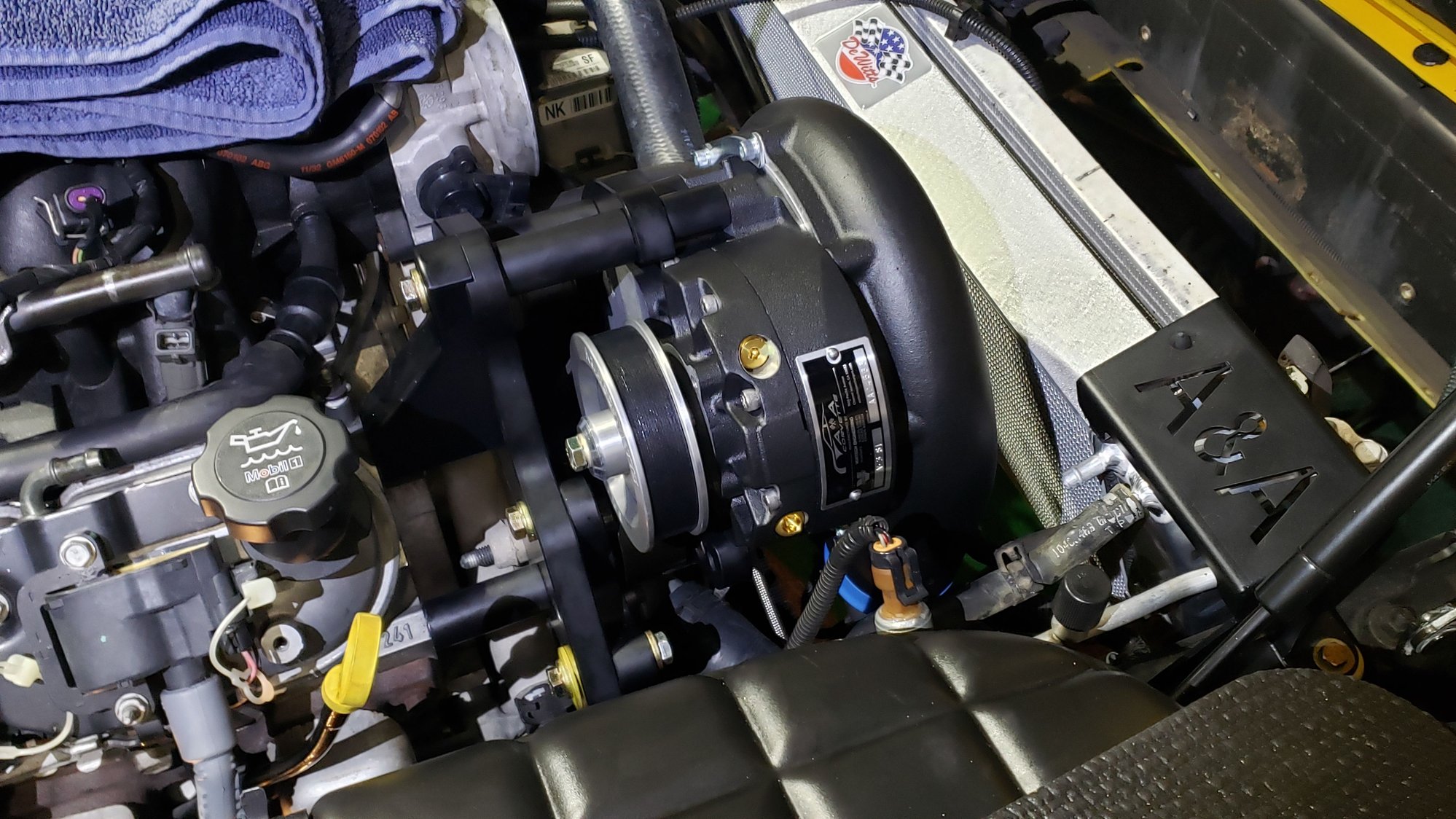

Just a quick update, got the blower installed, and noticed a potential issue. Did any of you guys run into this? The blower bracket is touching the radiator hose on the waterpump side.
Blower installed.
Blower bracket slightly touching the radiator hose on the waterpump side.
Hose also touching one of the bolts on the blower housing itself. Anyone else run into this issue? Will cutting the hose at the end by about an inch solve this?
