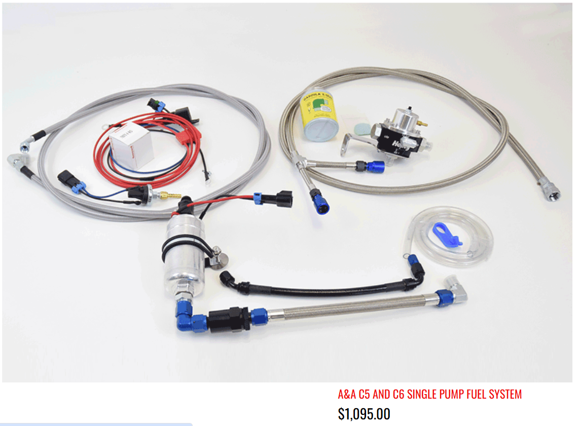

Hello all, new here and new 2002 c5z owner. I've been combing through the car since I got it and finally ended up taking it to a tuner to see if she's healthy. The car is a&a blower, heads/cam, methanol on pump gas. I have a dyno sheet for 670whp from the old owner back in 2018. My tuner said the car loses fuel pressure up top and is totally methanol reliant for fuel which is horrible and what I feared. I pulled the rear wheel off and see its a oem pump with a kenne bell boost a pump. My question is a&a makes a single external pump kit that looks very easy to install. If i go with this option do i leave my boost a pump hooked up to the stock pump or just take it off? I'm not chasing power here and a nice "reliable" 650 wheel would be fine with me. Any input helps here!!!! Thanks!

I just underwent this entire scenario on my car which has similar mods (no meth though), and decided that I did not want to risk my car to a Hobbs switch and an aux pump.
I just completed the install of a Chris1313 fuel system with the -8AN feed and -6AN return.
It was quite a bit more spendy ($1700) but now I have one dedicated fuel system that is considerably oversized for my application.

Most of the time, if guys add the external fuel system they will remove the BAP. In a few cases I've seen the BAP moved over to the external fuel pump if they still needed to stretch a little more from the fuel pump.

Thanks for the response brother! I’ve seen these kits and determined to go the external route as $1700 is quite pricey compared to $1050 for the a&a external kit. I’ve heard great things about chis1313’s pumps though.

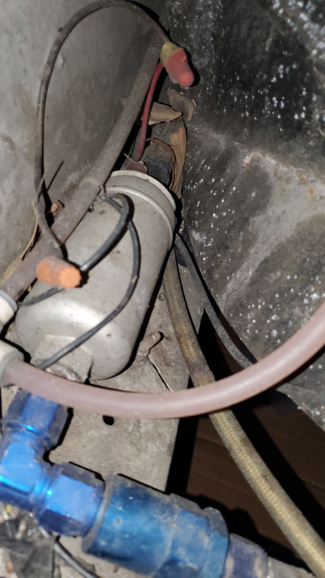

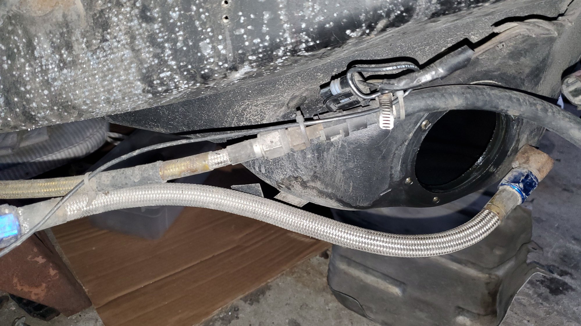

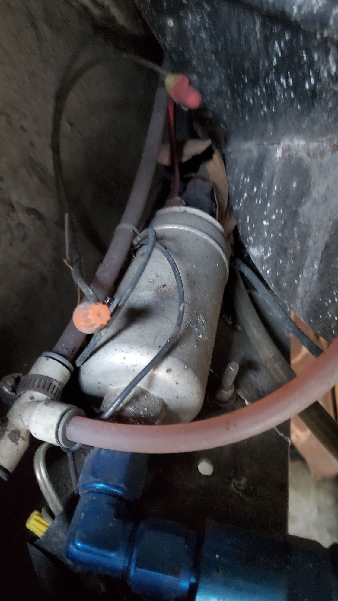

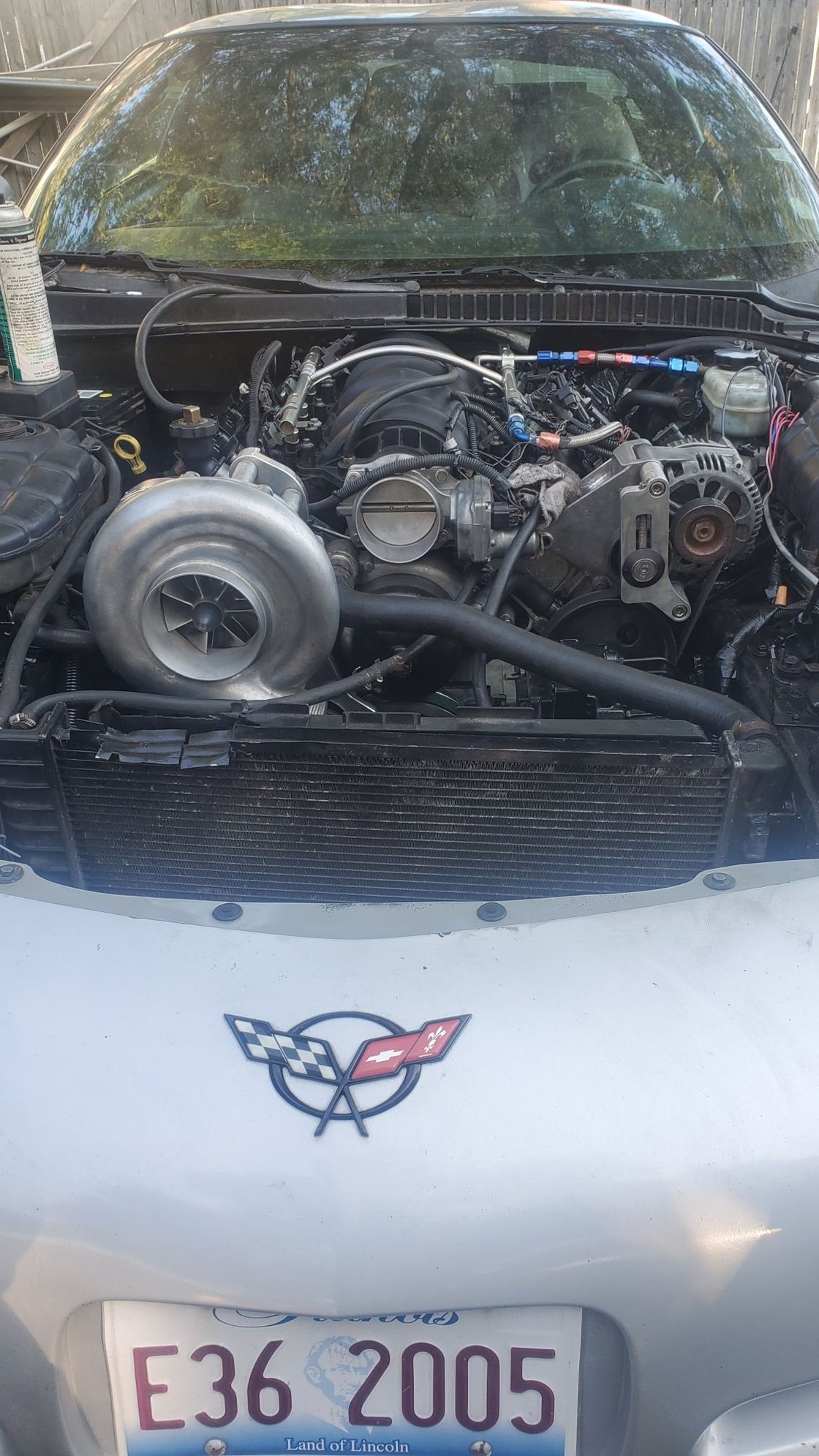

Here's some picks. Im sure your going to keep your's nice and shinny and in a controlled environment, My car is daily, If the roads are clear, my driving, Chicago area is not for the faint of heart to drive their c5's all yr round like me
So tit's been through every condition possible and will continue to as long as i'm still around. So you got a lot of catching up to do. GL with your new and updated system.
