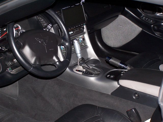

Sure Bri-
I guess the big question would be what kind of **** you have. I got this one... it has the shift release **** in the middle. I just measured out how much I needed and inserted it into the ****. It filled the gap.
