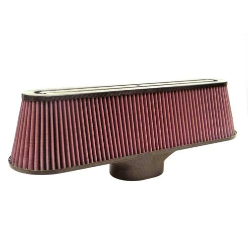

Originally Posted by Vette Ed
what is the small filter for?
There is a small hose that plugs into your stock air filter housing - I beleive it is a fuel pressure or crank case vent hose that vents gas back into the intake to be burned. Since the new filter housing (and my old one as well) did not have a connector for it, I just picked up a small filter at Autozone for $4 to connect to it.
Besides acting as a filter, it just looks cool.

No offense DERJ, as your design looks sharp and the price is right, but just asking questions for the fellow that asked about the potential cons of a homemade CAI or any CAI for that matter,
How much noisier is this setup than the stock airbox?
Does the z06 have a provision for an IAT (Intake air temperature sensor) in the airbox? If so, how were the readings calibrated? Resistor/pcm flash?
How much closer would you say that the air intake is to the ground as far as the risk of picking up water/debris?
How often do you have to clean/oil that filter? a clean paper filter will outflow a dirty K&N 9 times out of 10.
Sometimes if the overall effective length of your intake setup (not just manifold runners) is too short you will end up losing low end power for a trade in greater power at an rpm which your engine is no longer effective with the stock heads, intake, cam, or rev-limit. Do you notice any sort of low-end loss? Any dyno results before/after?
Also, don't get me wrong I definitely am not one of the aftermaket bandwagon boys as I believe in a modified k.i.s.s. rule (keep it stock stupid), after VERY highly modifying several cars myself, in my experiences, there are mods out there that only cost the pocket book but they are rare.
No offense taken and glad for the extra questions (good for thought...)
It's no louder (as I could tell) than a WCC Hurricane.
The IAT is not mounted in the porton of the air box that has been replaced so remains untouched.
How often to clean? About as often as a Blackwing... (Can't compare to stock filter as I never had one in the Vette...)
This setup is actually longer than the WCC Hurricane that was previously installed - based on looks (not exact measurements) it is about the same length as a Blackwing or Raptor.
Honestly, I noticed no performance gain or lose over the WCC Hurricane previously installed. Besides the size of the filter, I can't find any difference between this and the Blackwing besides the air pump connection (and the price...)
I'll continue using it and report back on anything I find.
Actually I have often read & seen some tests that state just the opposite. The dirty KN flows more than the clean paper.
