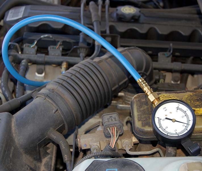

The typical FP gauges you find at the parts houses will push in the needle valve. Mine does:
To Z06 engine died
Jeep 4.0?
