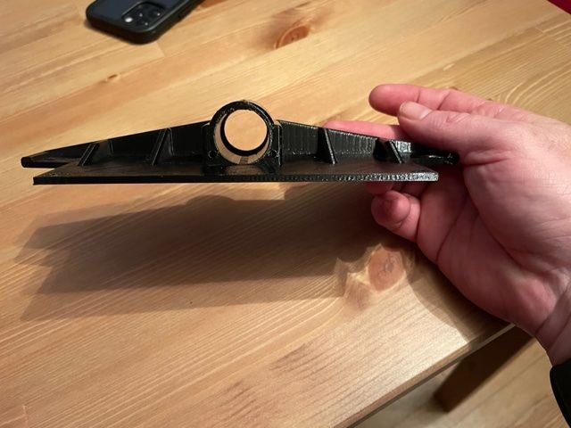

Im a few years late to this post.
I 3D Printed Backup bracket

Very nicely done! I'm not currently looking to do this mod. However, I'm certain there are others on the forum who would be very interested in purchasing these from you. This is one of the better mounting solutions that I have seen.

Default Files
Thank you
I posted the files on Thingiverse for people to download and print for free.
https://www.thingiverse.com/thing:4903592
If someone doesn't have a printer I'm sure we can work something out.

Well done. Where did you route the wire to the camera?

The Wire Comes from the camera goes to the clip that holds cable on the camera mount that puts the wire right there at the opening of the rear passenger side plate light.
if you look to the right the passenger side hatch latch there is a set of wire holding clips that route factory wiring. I made a small hole to the of the latch. Epoxied a grommet ran my wires through that then used 2 pieces of sound deadening material to cover it up with on both sides. I also used the few small strips of sound deadening material to make the wiring in the back car(outside be car inside taillights) route a path so later I wouldn't get vibrations and foolish tapping from the wires. ( just enough sticky stuff to hold did not cover all off wiring just strips to tape it to body.)
I also soldered a plug to the wiring coming from the reverse light to power the camera. with another wire going into the car from the reverse light to the radio to tell radio when car is backing up.
