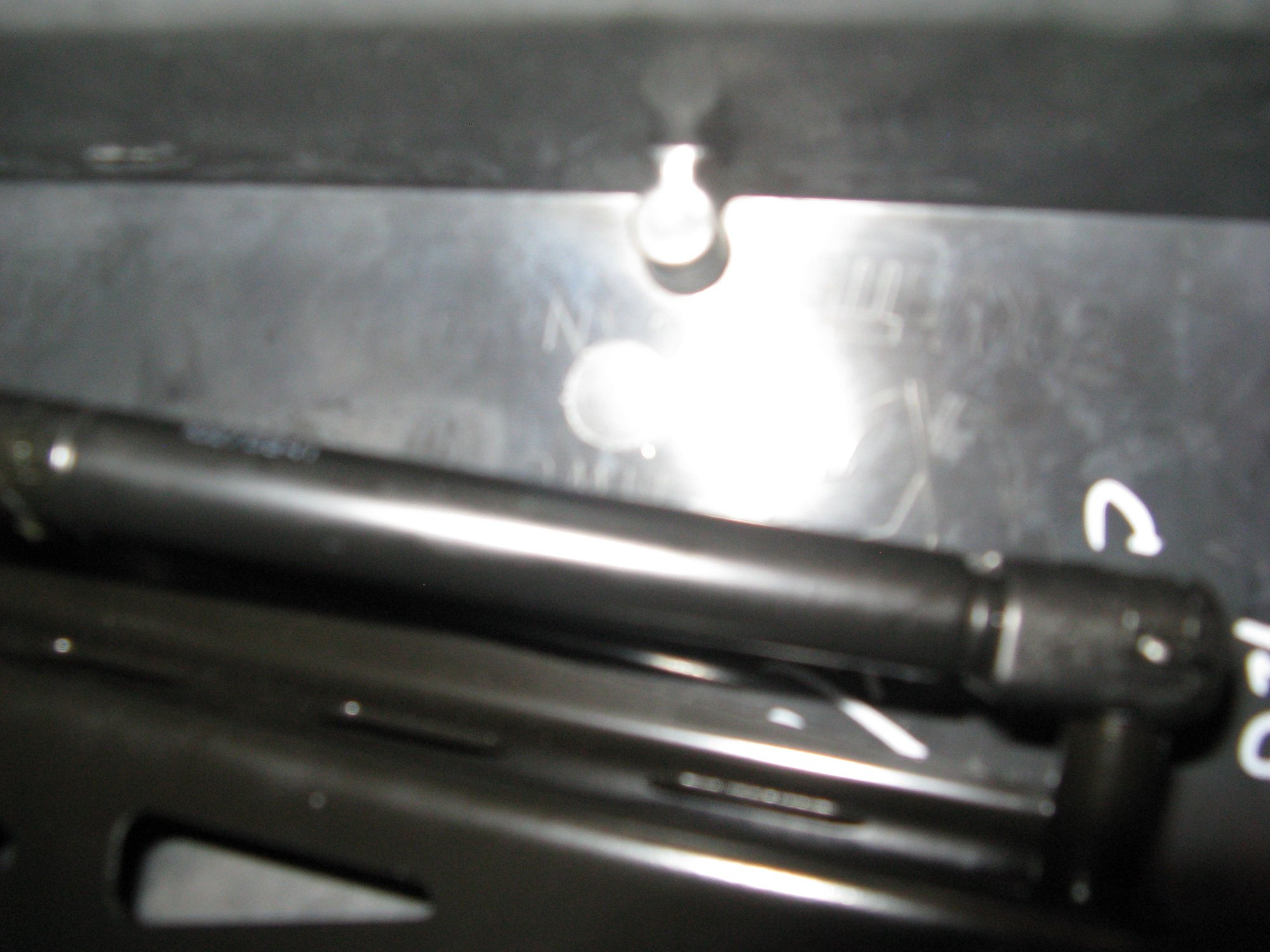

Just replaced mine. Took about 30 minutes and needed someone to hold roof and cowl up. The struts are located further back than I initially thought. Not a hard job. I did stick the awl into my thumb. Superglue to the rescue.

I replaced my struts today- they are difficult to see and the photos really helped! My suggestions:
Open the trunk lid- feel underneath the top of the fender (I found feeling for them was the best way for me to find them- reach up underneath the rear quarter panel and feel around and eventually you will feel them).
Prying the spring steel clip off of the strut socket to release from the ball was the most difficult part of the job for me--- and it wasn't all that hard- it just required a flashlight and a bit of bending. I removed both of the struts where they connected to the bracket in the trunk, then closed the trunk lid.
Next I opened the deck lid, propped it with a broom stick, and again feeling for the struts found them and simply pulled them off of the ball of the deck lid (this can be done by hand).
The new struts are very easy to get back on (no need to go into the trunk)- with the deck lid propped open, take the cylinder (thick end) in your hand (left hand for driver side, right hand for passenger side) and reach back through to the rear most ball, feeling for the ball, once you feel it, simply snap the new strut on (no need to fiddle with the clips to snap struts on), then move your hand up to the socket of the smaller rod end and snap that onto the deck lid ball.
The only things I add, to the above suggestions by others is that you might want to feel for the struts first- and that you can snap on the new struts via the propped open deck lid by feeling for the rear most ball with the strut in your hand. No need to go back into the trunk.
Once you have new struts on, you will be rewarded with a deck lid that will automatically pop all the way open and stay up!
