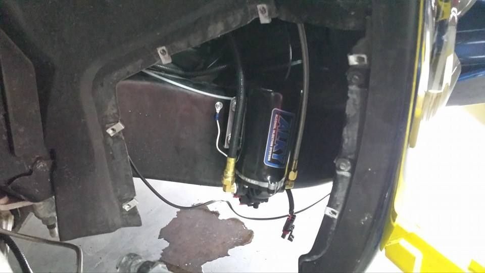

Alkycontrol Meth kit installed.
Meth and gauges going in
