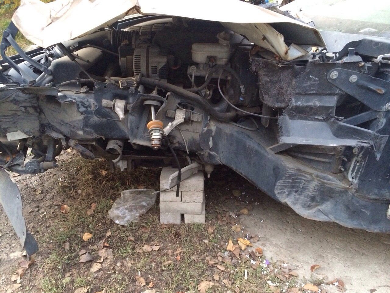

Dear Corvette owners
I need ur advise on the corvette that i am willing to buy. It is a corvette 2001 which has been involved in the accident. Why i would buy damaged corvette? Because in my country you cannot import cars older than 2008. So that is why comes this solution to buy the one of the few corvettes in my country in damaged condition. So i post here to get the advise should i buy the corvette in such condition. This will be my first corvette if i buy. And owners of corvette will know better what parts need to be replaced. I dont know nothing what should be there. could you help me to find out the list of parts that need to be replaced? Please see attached pictures. Looking for ur help.

That looks like a ton of work to be honest. The interior looks to be in great condition, which might speak for what kind of overall care the car got before the crash... It all depends on what kind of money your willing to dump into it.
What's your budget for fixing it? That would help us determine if it's possible.

The car originally brought from Dubai in 2007. The mileage is 50K km. which is very low. After the accident the car was left for almost two three years that is why the paint looks so bad. The engine after accident is not damaged. The only suspension and bodywork. The price for it 13k $ which is very cheap in my point. But im not sure the condition of the engine and gearbox because the car was left on the open surface for quite long period of time. by budget to fix the car with the new paint and brand new rims plus bodyparts and suspension is 6000$. but in order to find out how much it will cost me to fix i need to know what parts should be ordered and part numbers, especially for suspension. so that is why i posted the pics for you guys to identify what need to be changed. of course it is obvious that i need bonnet, front bumper, driver side fender, the driver door, headlamp. what else?

STAY AWAY.....FAR, FAR, AWAY. You will probably spend more on repairs
then what the asking price is. It has some very nasty frame damage.
What puzzles me is, with a front end collision like that, why didn't both air bags go off ?

That car can't be fixed on your $6000 budget.

Looks like a lot of damage would need to be repaired, not only to the frame, but lots of body panels too. I would guess that your $6K budget will be eaten up in very quick order and the car will still require a lot more repairs.
It's nice to want a Corvette, but that one is priced too high to begin with and I would bet the cost of repairs will exceed the purchase price.

This is my opinion as well. I have spent close to $9000 on repairing and upgrading my 99 C5 and it was running with very few issues when I bought it. I found out that many service items hadn't been maintained properly and those resulted in $5000 worth of repairs (air conditioning, brakes, wiper motor, other issues), plus the $4000 I spent on wheels, tires, and trip pieces to make it nice.
That car is a wreck, sorry to be so blunt. I would estimate you will spend around $15-20K USD on parts w/import fees, PLUS LABOR to fix it.
Run away from this car as it's got too many issues to feel good about fixing.

Extent of the real damage cannot be determined from your pictures. But there is obvious frame damage in at least two places where the frame is the strongest. That alone is going to be very expensive to set right again if it is even possible. Your $6000 estimate is way under estimated in my opinion from what I can see and the $13000 sale price is far too high, again in my estimation.
You mentioned there are very few Corvettes in your country. That being the case most if not all parts are going to need to be acquired from outside your country. Shipping and perhaps import duties just add to the final cost and will certainly delay any repair attempts.
Add to that the unknowns of the drive train.
I would keep looking if I were you. JMHO

Actually it looks really bad.. but the collision was from the side to the divider due to loss of the control. That is why airbags didnt go off. it wasnt straight impact

do you think frame is damaged a lot? because the frame actually in corvettes very strong. i have no estimation on what it will cost me. but to fully repaint the car will cost approx 1300USD to the premium color plus body panels and suspension replacement costs. i have no idea what parts should be replaced under the driver fender. that is why i cannot estimate the costs.

The frame is damaged.
the suspension on the right side is gone too.
Unless you know a really good frame shop, and then can do the rest yourself, stay away.
