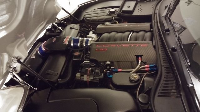

I have an LS3 based 427 stroker, heads, headers, etc with the LS3 TB and never had codes. I know this may sound odd but check the location and connections of the MAF. Also with the LS3 TB, what adaptor harness are/were you using? I have read about some issues with certain harnesses used. Do a search based on the brand you are using to make sure yours isn't one of the ones people are talking about. It could be a few items to include TAC module, grounds, connections, the tune can be a big one, etc. There are quite a few items to check.

Well I wont take the credit nor blame, I can assure you that the shop started with an LS3 crate straight out of the box, no new TB ever put on. Its been in the car since 2013 without issue. Tuning and know how is all I can say.
