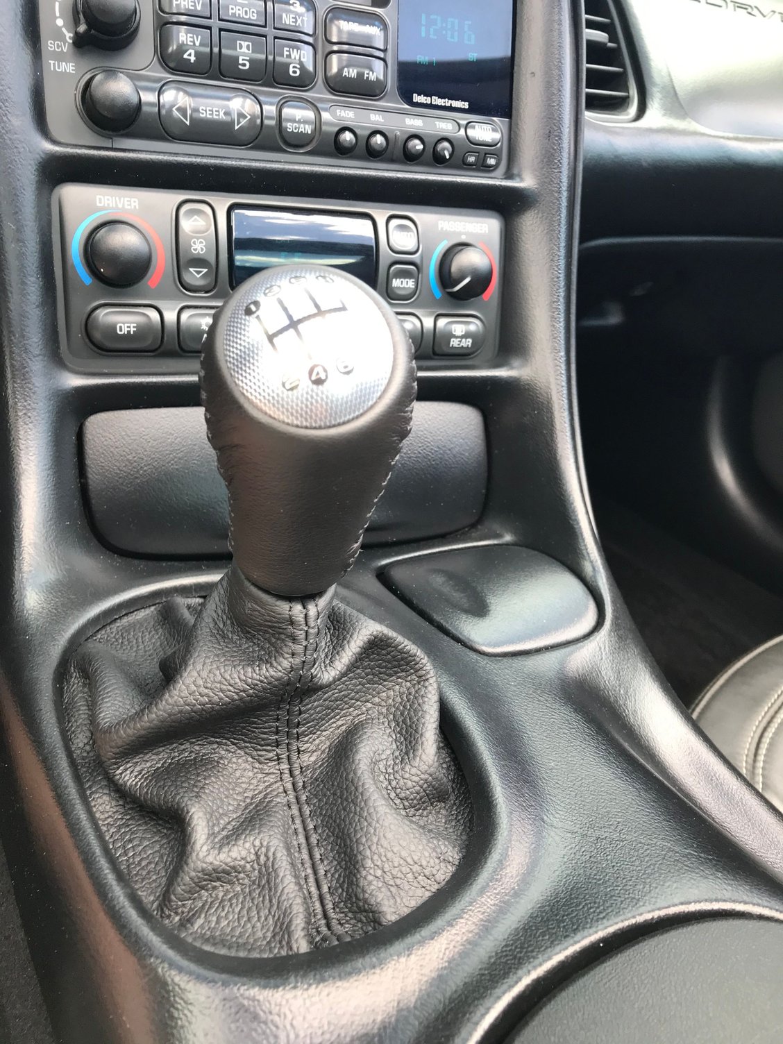

Old Dec 18, 2020 | 05:29 PM
rockymountain1999's Avatar
rockymountain1999
Joined: Aug 2019
Posts: 412
Likes: 205
From: Castle Rock, CO.
2021 C6 of the Year Finalist - Modified
I went with the newer version of the C6 shifter. The angle is much better. I also removed the Anti-venom mod once I installed this shifter. Very smooth with good engagement and no rattle!

Since you did, question. What boot do you have on there - did you have to mod the stock or did you get a custom boot. Also, in your opinion, how big of a difference is there in the C6 shifter compared to the C5 unit? If they looked exactly the same - would you do it again (C6 **** does look much more modern).

That’s a custom Redline Goods boot. I once had the metal wire ring under it but I never liked how the fit was around the plastic console area. I just have it tucked under the console. I have a couple of foam pieces around the shifter to fill up the void below.
The press-fitting inside my C5 shifter failed and I could never get the **** to fit tight. It was just too sloppy for me and it rattled.
This C6 shifter is shorter and the **** sits down lower. There is also a slight angle in the shaft and the **** is shaped better towards the driver.
After installing this, I removed my 1-washer Anti-Venom mod and that ended up having the right feel.
I purchased the complete assembly. I recommend it.
