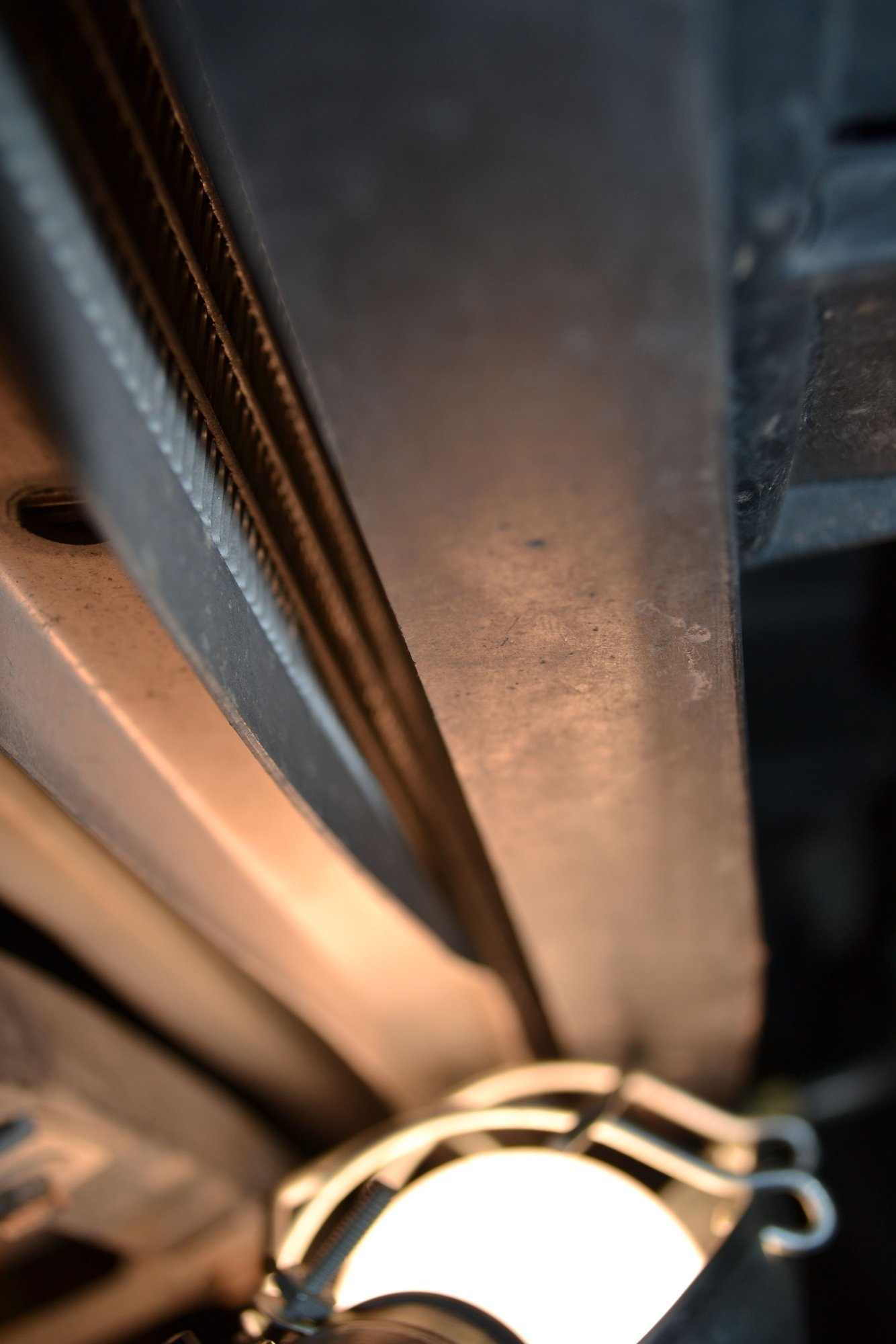

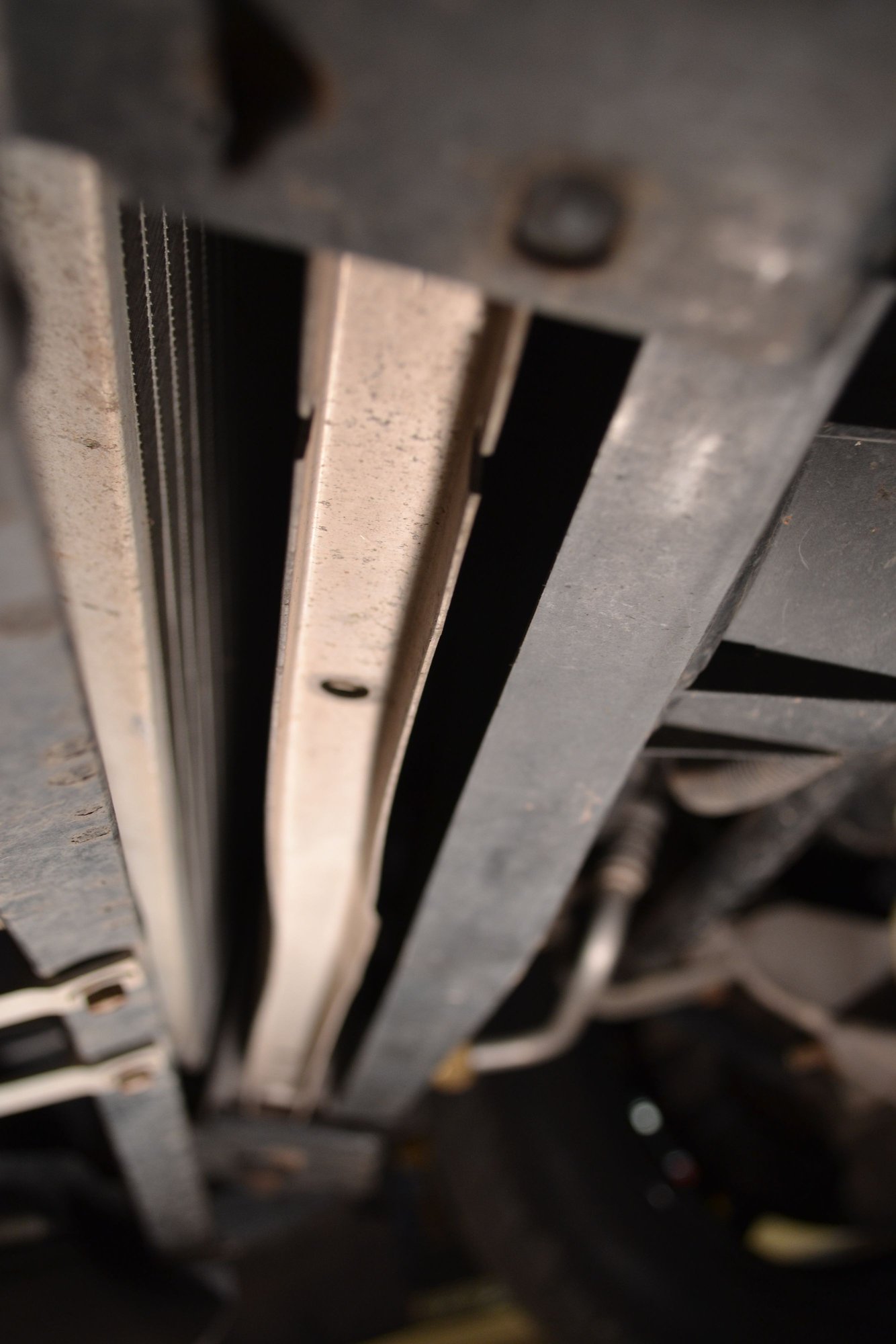

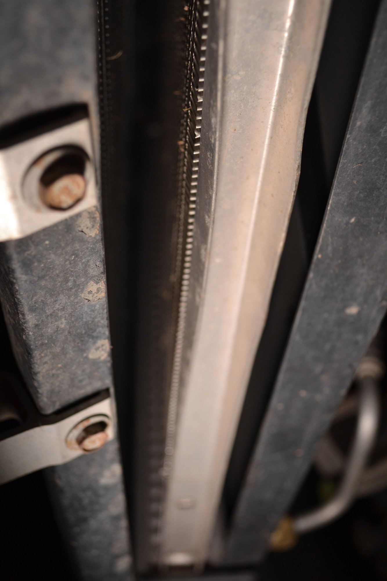

For the sake of more bickering here are the pics..you can clearly see the gaps in front of and behind the radiator...if you shine a light in these gaps you can "casually" inspect the radiator
front of radiator gap about 1 1/2"
Back side of radiator... you can't see as well because the bottom of the radiator shroud is fairly close, about 1/2 to 3/4 of an inch
Now the part I thing we agree on, is that you can't see inside the fins, and that removal is necessary to inspect for absolute certainty that nothing is obstructing flow thru the cores...
