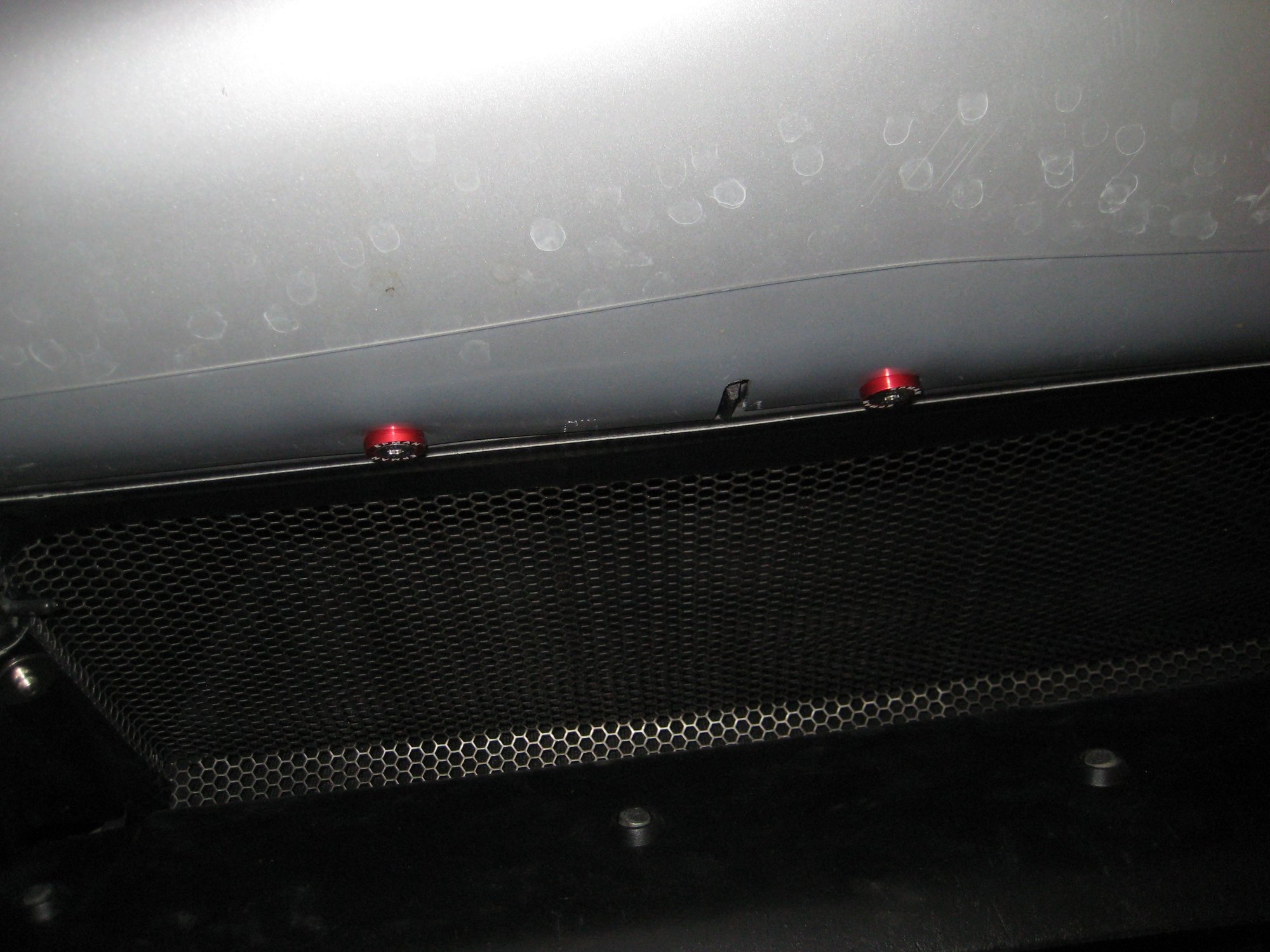

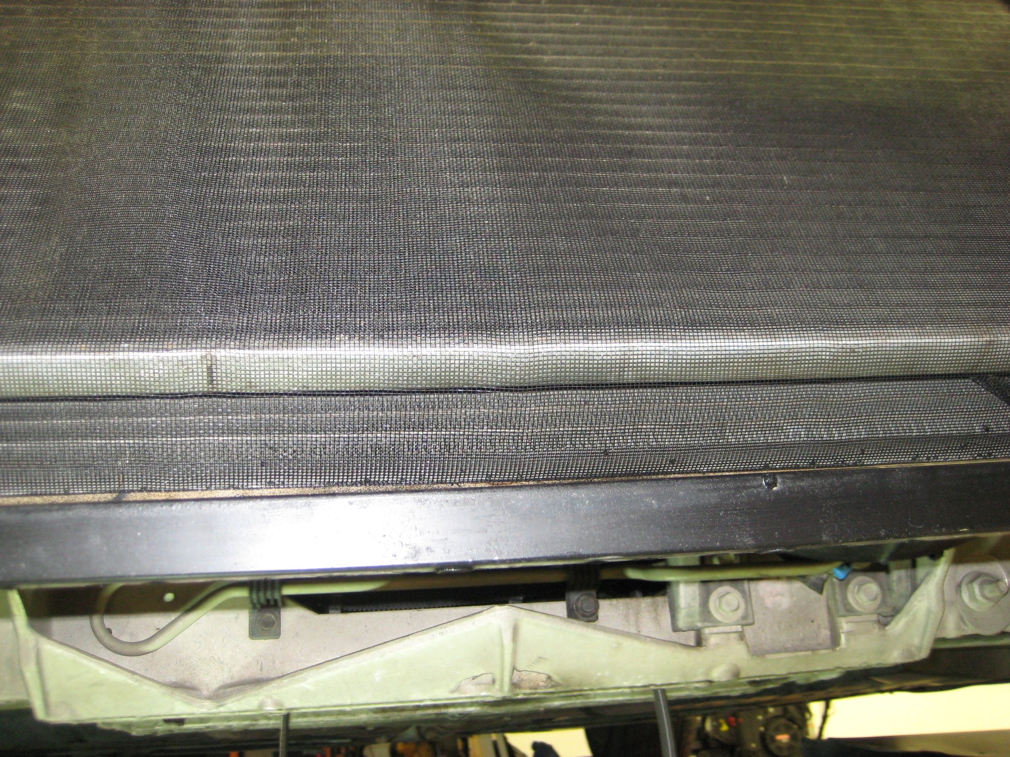

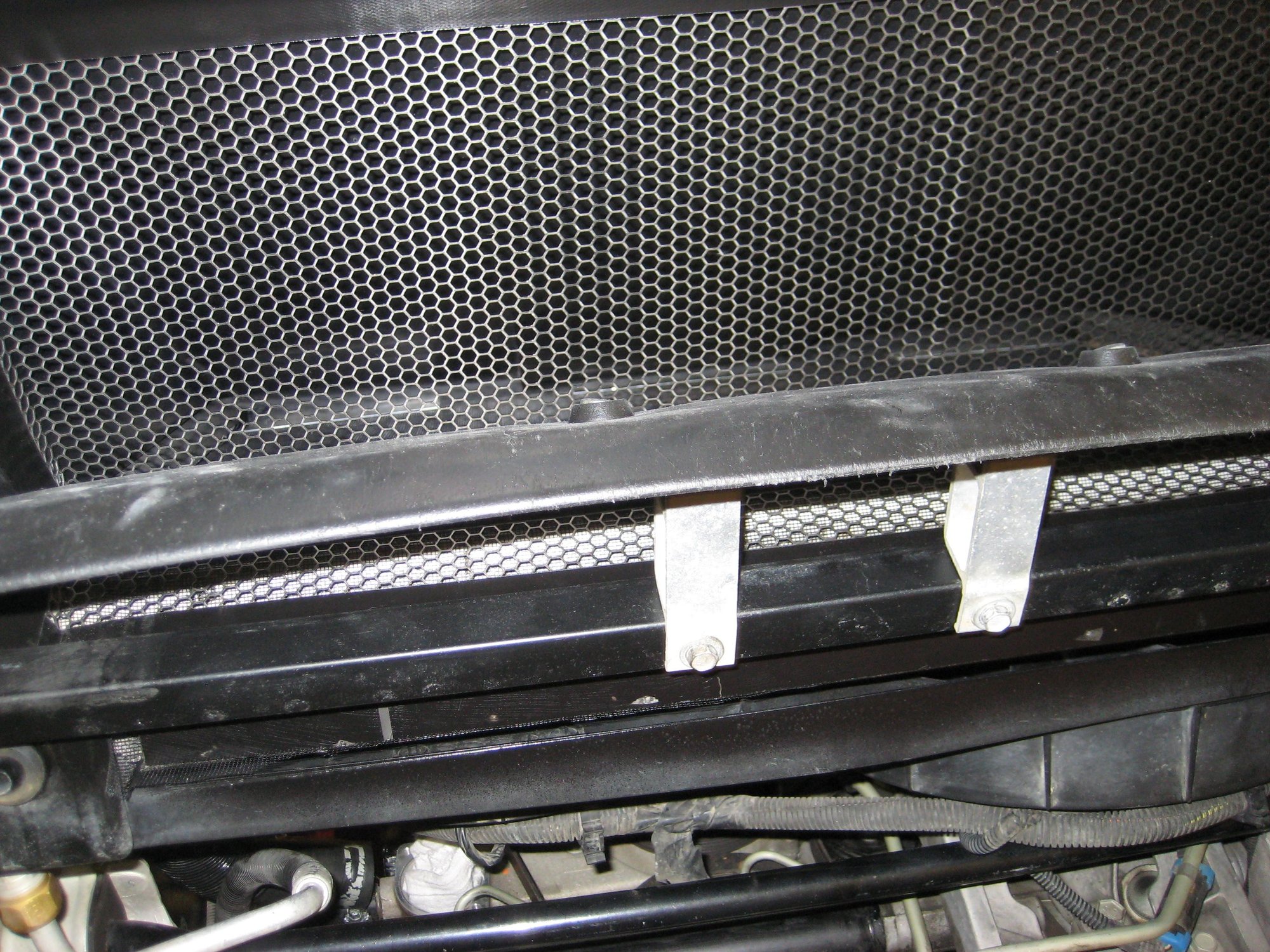

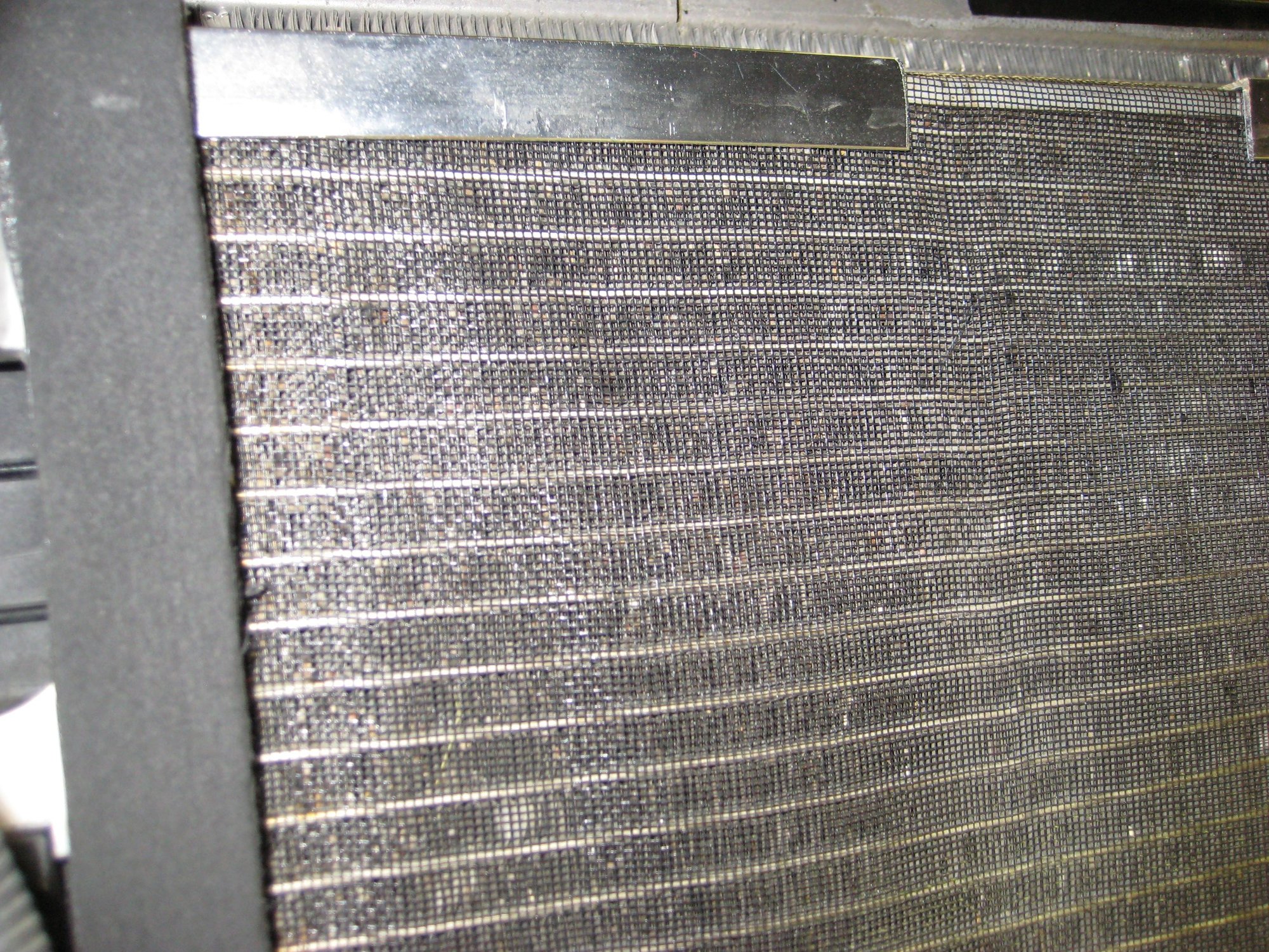

This winter one of my goals was to clean the radiator and condenser, with all shrouds off I blew air to the front of the car, tons of crap, still could see crap in the condenser, took the hose with 40 psi of pressure, still was not clean. Took the fans and radiator out of the car,sprayed again with 40 psi of water pressure, could not believe the crap that still came out, but thought it was clean. After the fans and radiator were back in the car I decided to put a screen in front of the condenser wrapping the top and bottom of the radiator. (plus the lower screen at the air inlet) in the process of adding the screen I used channel aluminum on the top and a piece of wood cut to fit on the bottom of the radiator. To install the tight fit piece I had to tap it with a small hammer to get it in, could not believe the sand and small stones that fell out of the radiator. My car never went over 230 degrees !!!!
