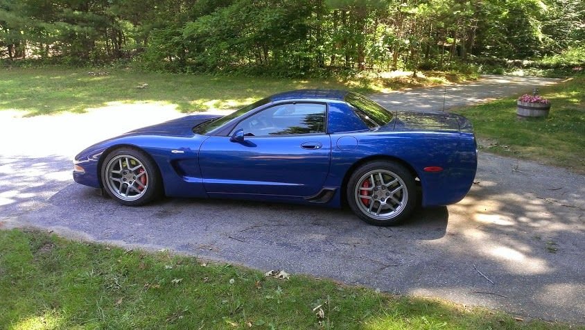

Okay, so I've been pretty busy with work and getting our boat squared away. Plus it has rained here nearly every day this month...
After some initial problems, Speed Depot got things sorted out. The tires/rims look fantastic and, in my limited driving so far, are quiet, less darty/nervous and sticky to the point where I am considering mud-flaps...
Don't mind that my C5Z looks like a lifted 4x4 from this perspective (maybe I really do need mud-flaps), it doesn't look as awful in real life.
The 275/35 looks great and no regrets versus a 265/35.
If I ever get some decent time/weather, I'll get them on an auto-x or my own back-road test site for a better review.

As for the tires being flush w/the (top) of the fender.
The stock rear Z wheels. The tires, w/weight on the ground.
There is 5/16" where the tire extends past the fender. (no spacer)
The repro wheels measures at the same spot with a 1/4" past the fender. (no spacer)
So w/the reproduction wheels, I will try a 5mm spacer to give some room from the liner.
I won't be driving the car hard (w/these wheels & I check my air pressure & tightness of lugs often.
With the square set up, of course I wont need the spacers.
