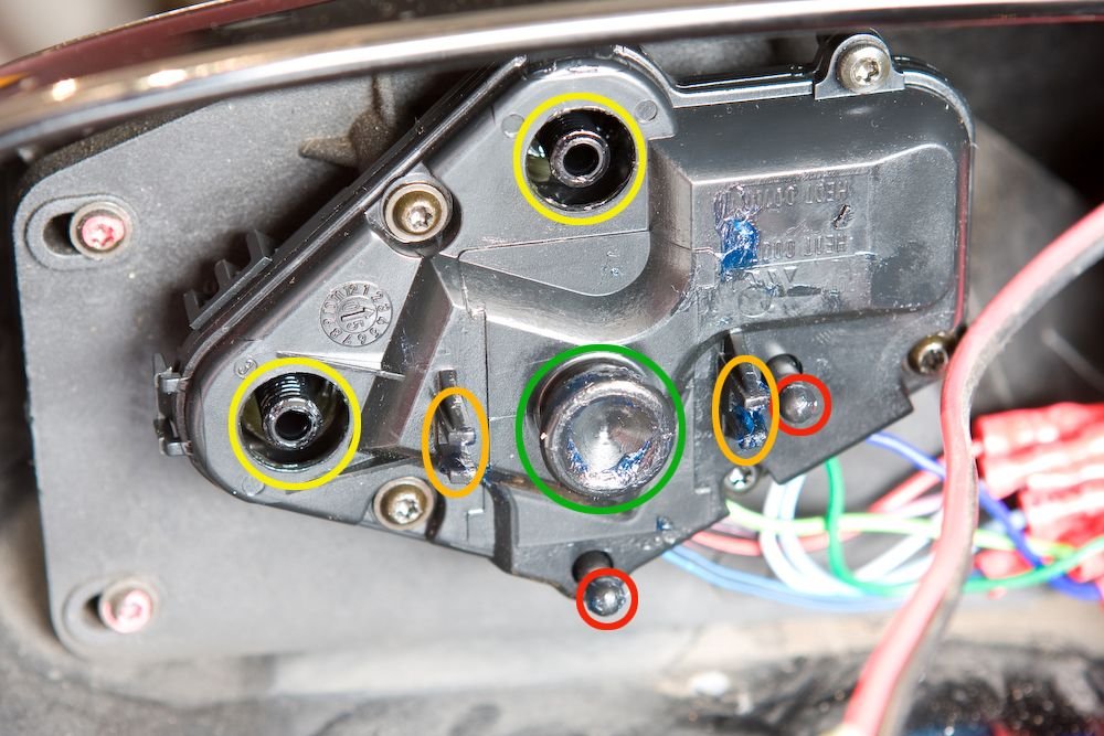

May be a better pic to identify what you are looking for...

I need the post that connects to the sockets circled in yellow in your great pic.

Still not sure what actually broke? Are you sure it actually broke or did it may just stay connected to the mirror when you removed it (this is common).
You might review these Muth Signal Mirror instructions to get a better idea of how this all works. Scroll down to page 5 and read it carefully. These are the instructions I used when replacing my stock mirrors with Signal Mirrors...
http://shop.muthco.com/content/pdf/install/21001070.pdf
Also the post you have circled controls the up/down motion, not the side-to-side. You "may" not have anything "broken", just may need to pull to off the mirror and reinstall into the motor?

I have pulled off the mirror again to check and I used the same instructions. On the end of the positioning post there are three fingers whose tension is held by a metal ring. When I reinstalled I managed to break off one of the three fingers on the end of the positioning post and so now it will not hold on under power.
Jim
Now I get the picture. Did you ever try contacting Vettenuts?
I would imagine your only options (without rigging something up custom - which is an option) is to find a used C5 mirror from salvage and strip it down or find a "mirror expert" (there is probably one somewhere... but only one) to see if that part is used on some non-Corvette mirrors?
The good news is there are probably at least 10,000 spares rotting in a parts bin somewhere in Indonesia left over from the GM purchase order .
