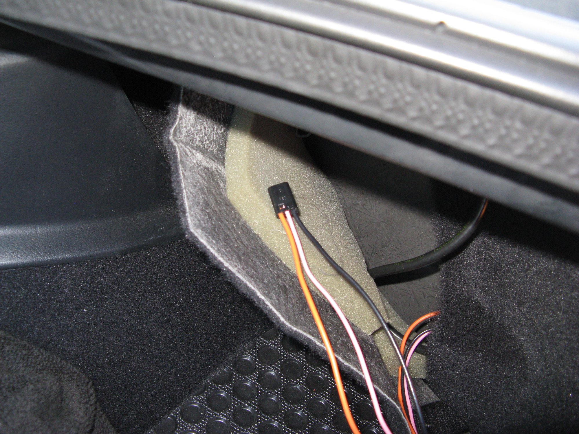

I decided to do a wireless switch for my antenna. Here are the instructions and pictures:
Wireless switch for power antenna
It works great and is a viable alternative to a hard wire switch that has to be mounted somewhere in the cabin. Here is my installation of the wireless switch.
Picture 1 shows the items I used for the installation:
• #1- Wireless Remote by FIMCO with on/off Key Fob. Key Fob has batteries installed. Remote can be ordered through Amazon or I found it at Tractor Supply.
• #2 is an Extension that will be plugged into the remote. It was purchased from Tractor Supply. I cut the extension in half for installation to the Remote.
• #3 is a 3 wire connector I found at Home Depot for an easy connection of the 3 ground wires.
The antenna power connector wires to be cut are behind the passenger side rear trunk area. Just pull the carpet away from the side and the 3 wire connector (orange, pink, black) to the antenna is found. Detach the connector.
Picture 2 shows the various connections; the cut extension to the Remote pig tails, the one ground wire from the power-in side from the radio to the 3 wire connector, and the two butt connectors on positive wires. The curled white wire is a negative wire not needing any connection.
Picture 3 shows what wires to cut from the antenna connector; pink (the cut wire closes to connector goes to the power-in side of Remote) and the black ground. The black cut wires (after stripping the wire ends) are put in the 3 wire connector.
Picture 4 shows the connection of all the wires.
Picture 5 shows the mounting of the remote to the side of right rear inside panel using Velcro.
I did not attach the on/off key Fob to anything. I just put it in the ashtray to use when I need to listen to the radio (albeit not very often).
The total cost for the project was about $44. Now I can listen to my 12 CD changer without the antenna popping up and just as important, not drilling into anything in the cabin area to mount a switch.
