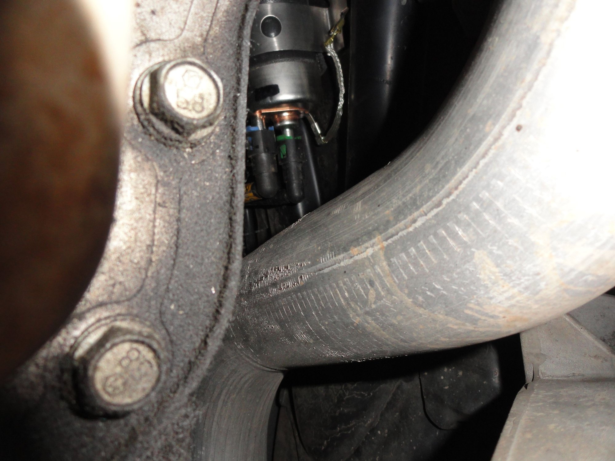

I just jacked my car up and thought I would look and see where the fuel filter was located. After finding it I am glad I did not try to replace it myself. Unless you have baby hands there is no way to get to it without dropping the exhaust and without a lift it would be a nightmare. It was definitely worth the money to me.
I never dreamed the auto tranny was that much larger than the 6 speed.....WOW!

This posting made me decide the filter probably needed to be changed with 66,000 miles (I have owned the last 10,000). I got a Wix filter locally and paid $45 with tax and a $3.99 plastic tool to remove the front fitting. The Wix filter was stamped Made in USA. I pulled the #35 relay in the under hood fuse box and cranked the engine a few revolutions to relieve the fuel pressure. The whole operation took 15 minutes once I got the car raised. Since my wife and I use this car for several vacations a year I have piece of mind with another maintenance item done.

Did mine last week used Wix filter 33737 and removel tool at local auto parts store $50.00 out the door 45 minutes from start to finish.

Resurrecting a month old thread as I'm curious what filters you guys are using
I was under the car yesterday doing the Anti-Venom mod and noticed the fuel filter. It got me thinking about replacing mine since I have never done it and have no idea if the PO did it. I'm seeing some varying prices at my parts store:
BWD-$148.99
AC Delco- $116.99
Champ-$84.99
WIX-$45.99
Microguard-$19.99
This would be for a 2003 Z06
And here's a link for a how to if anyone needs it:
http://www.corvettelegends.net/html/...eplacement.doc
