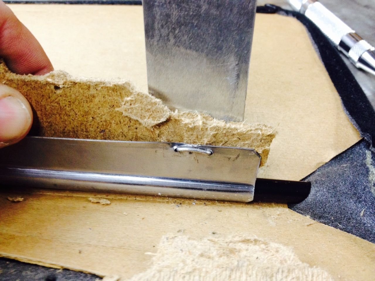

After cutting the threads around the perimeter of the visor this was what I found.
I used some pieces of aluminum as my stiffeners. I made them 1.25" wide by 4.5" long. I cant tell you where the aluminum came from but I can tell you it had green reflective tape and white reflective letters on both sides , its been in the shop for about 10yrs now. With a wire wheel on the grinder I removed the reflective tape from one side.
The visor had 4 staples that went through the two metal sides of the hinge and through the fiber board. They were not much fun to remove due to their thickness. It took white a bit of prying and pulling with different tools to remove them without doing any more damage to the visor.

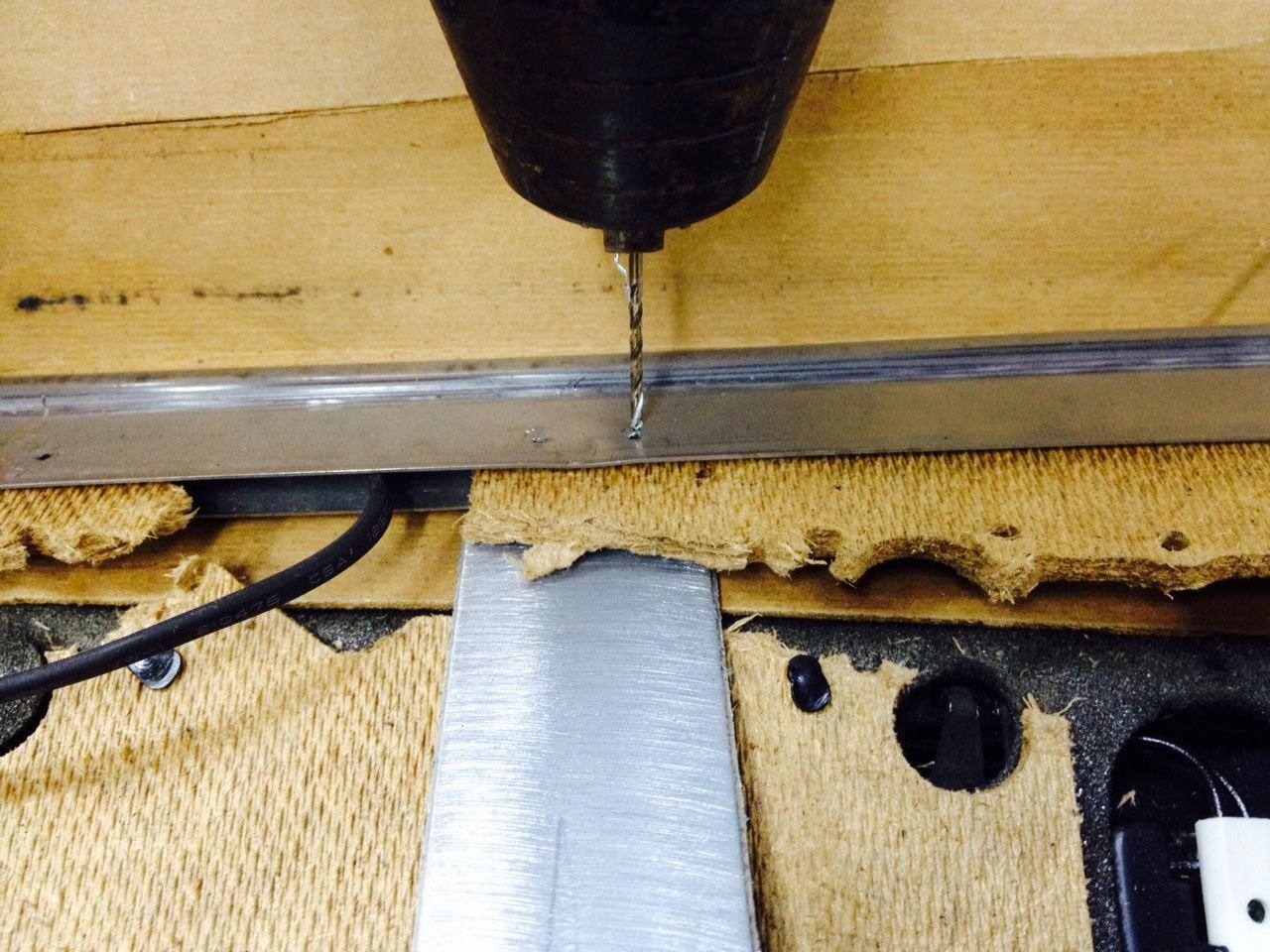

The staples left behind 2 holes each that were 1/2" apart. I drilled out the holes so I could pass the stainless wire I had through them. Remember to place something on the other side of the metal hinge to prevent your drill bit from poking though the fabric of the visor.

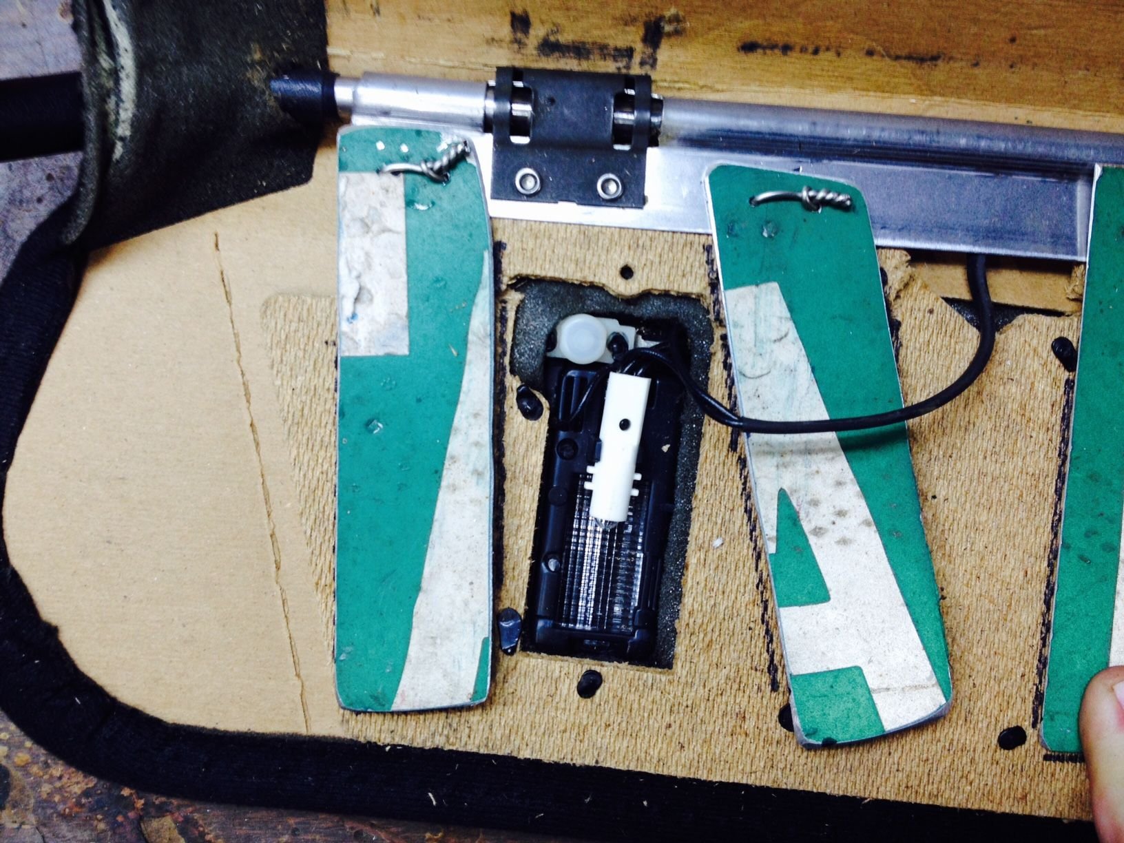

I drilled two holes (1/2" apart) in each of my aluminum stiffeners & bent a 3" piece of stainless wire to go through them.
After passing the stainless wire through the metal hinge and the aluminum stiffener, I twisted the wire tight.
This is what you'll be left with once you do all four.
The holes in two of the stiffeners will need to be positioned so that the stiffeners don't lay on top of the vanity light. You will also need to trim the end of those same stiffeners so they lay flat on the metal hinge. Remember to cut off the excess wire and lay the twisted section down the best you can.

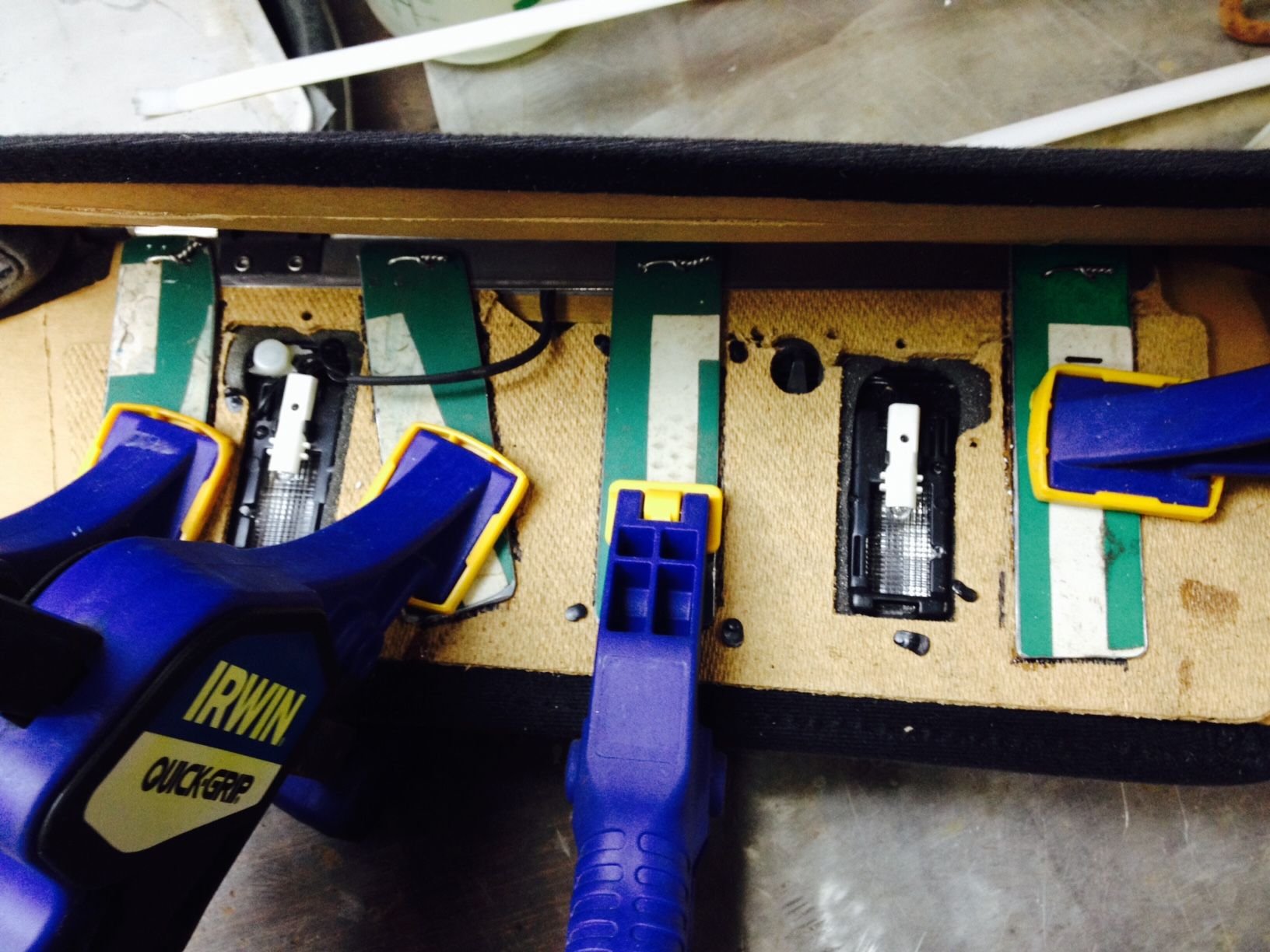

Now a very generous amount of super glue beneath each, a few clamps and your visor is no longer FLOPPY. Don't tighten the middle two clams so tight you break the mirror or the plastic cover. Just tight enough to get the stiffener to set flat on the fiberboard and engage all the super glue.
