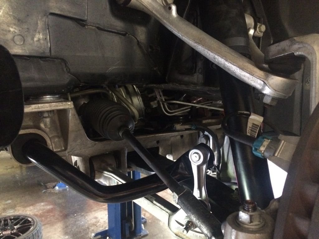

C6 suspension upgrades and caliper covers installed (for now).
