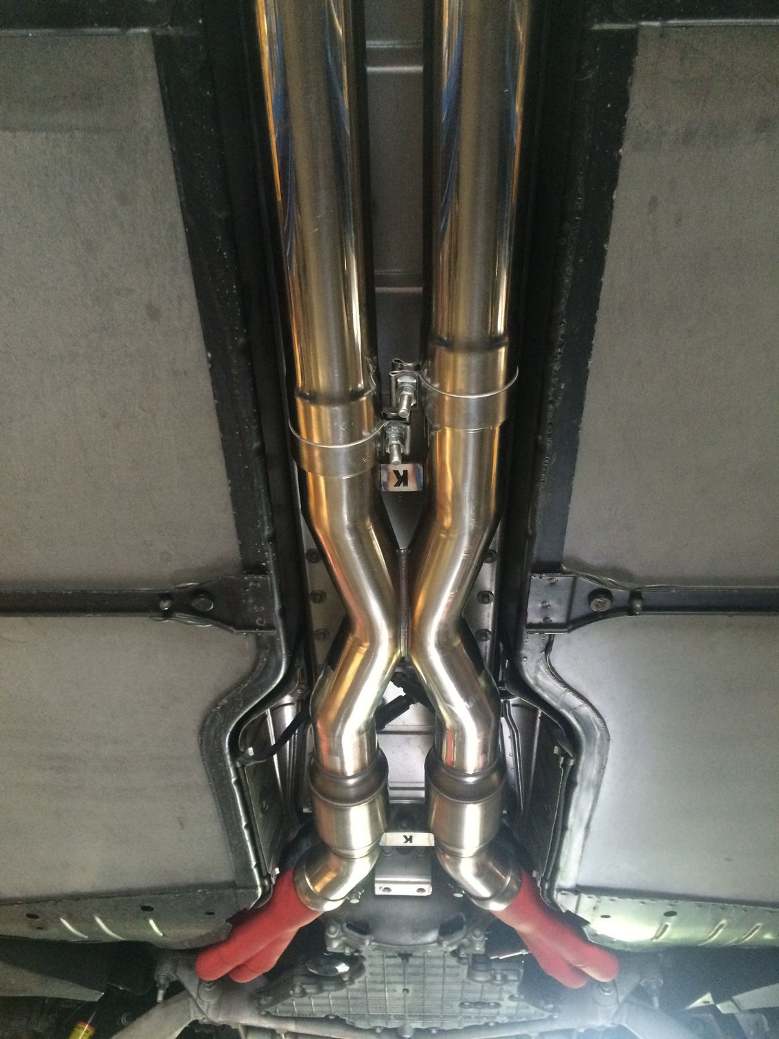

Couple pics from end of day 1:

Update:
Full exhaust is on, and I should have some pictures later today. The single tip has been a bit of a pain to get centered, but it will be perfect when done.
Unfortunately, Nick Williams black 102mm throttle bodies are on backorder. We were going with FAST 102mm throttle body, but turns out what we thought was a drive-by-wire setup turned out to be cable only.
It won't be dyno tuned until that shows, up but we are getting closer.
