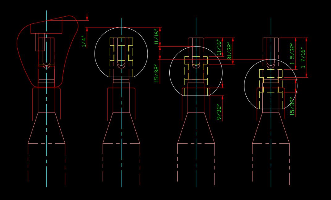

Originally Posted by jackthelad
Sounds as though it will work very nicely. Post a pic when done?
I bought a 1 7/8" shifter **** from TwistedShifterz, but the way they worded it I assumed the threading wouldn't be as deep as I wanted; well it is! The way this **** is built is almost identical to what I had planned (only smaller ID at bottom, so harder/impossible? to tuck boot up inside at lowest install option). I have no need to make my own. Ref; upside down red U is shifter boot "at rest".
Pictures of: **** install drawing, bottom side of TS ****, installed with no shaft mod.
Left:
Factory ****/shaft (key/keyway rotated; ignore)
2nd:
TS ****
No shaft changes
~1/4" lower than stock
Some shaft showing
3rd:
TS ****
~13/16" sawn off top of shaft
No threading required
~15/16" lower than stock
**** will push boot down ~1/4" easily
Right:
TS ****
~1 1/4" cut off top of shaft
Must extend thread ~1/2" down
~1 3/8" lower than stock
Boot likely needs to be trimmed or forced up inside (don't think it can be moved down the 3/4" needed)
I'm off for 9 days, will likely do 3rd step only, as I think this will get the **** to the height desired. Will post final picture and actual height measurements.

Originally Posted by grantv
Curious, do you have a Z? If not, did you install the Z solid mounting bushings or rubber?
No to both. I dumped the GM Torx bolts for proper hex head bolts, and put machine quality flat washers under them and screwed them down good and hard - no movement at all there. The other thing, which made a considerable difference, was I took the riveted on top plate off of the shifter mechanism, and ground it down a hair, then reassembled with make a gasket goo and nuts and bolts - this got rid of the looseness which had built up over 70k. The same treatment to the joint to the shifter box, and voila, no play anywhere, except in the transmission itself, most noticeable in the 1-2 plane. In 3-4 it's about 1/8" side to side at the shift ****.
Drove it around for a while with the trim out so I could be sure I was seeing no play in the bits I had had apart. BTW, the starter is really loud when there is no trim in place!!
Like your new set up. If you have, or have access to a pillar drill, you could bore out the lower part of the **** a little to fit over the top of the boot. Probably could also do it by hand using a burr on a hand drill or a Dremel.
p.s. how are you locking the **** to the shaft?
Good stuff, your bolts and washers = the same effective mounting or better than the Z shifter. And nice job on the further improvements! Including keeping a close watch on things wide open...
If I feel the **** needs to be lower than the 3rd sketch, I'll bore out the bottom, trim the boot, force it up inside... something. I think I'll be happy without threading further down however. Right now the **** feels like an inch lower would be just perfect.
TwistedShifterz includes a small tube of thread locker with the ****; Vibra-tite blue 12102 specifically. I'm more familiar with Loctite products, but I'm sure this will work more than fine. TS mainly recommend not tightening down against the top of the **** inside; thread down lightly to bottom out, back off to align pattern.
For now I'll leave it "loose" until I'm sure I'm happy where it is. Then pull her off and install the blue thread locker.
