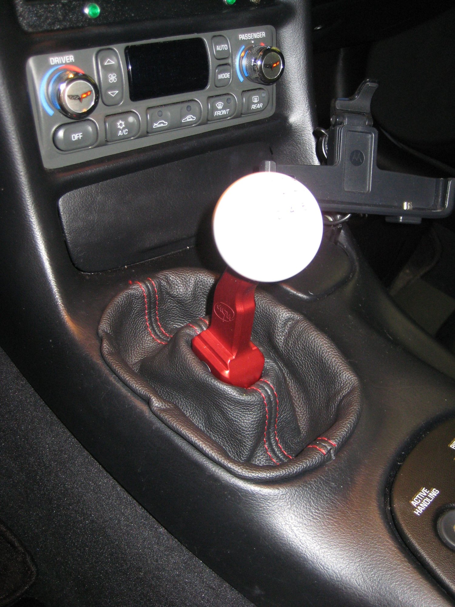

Originally Posted by akapounder
I'm old school !!!!!!!
Wow that's an awesome shifter. I love how the stick is red. That would look great with the red stitching in my interior. Where can I get one and how do you like the shifter?
https://www.mgwshifters.com/shifters/corvettes
MGW and I love the shifter !!!!!!

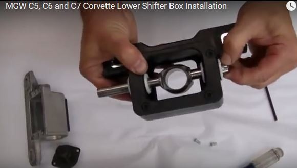

The MGW does have nylon bushings on the lower rod (not necessarily better than stock), but it uses the same GM shaft to connect to the shifter, and I actually like that GM uses a plastic bushing on the ball at the end of the stick instead of a metal ball against a metal shift rod.
Any wear will be on the plastic bushing and not on the shift rod.
Long term, the MGW box is open to the dust and dirt that will enter the tunnel. Guess I don't understand why they would design a fancy box and not enclose the working parts.
I don't know what your referring to, mine has no opening to the elements !!!!

Just that the MGW lower box does not have a bottom, so shift rod is not enclosed like stock box.
you mean like shocks ????? the tolerance is too tight to be a problem ??? but I will call George and discuss it with him !!!!!
