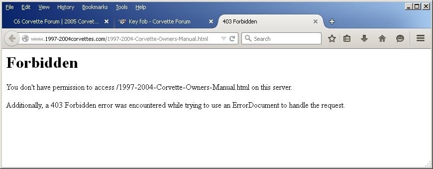

Having trouble accessing the web site for the owner's manuals. It says Forbidden, you don't have permission to access the site on this server. Any other link to owner's manuals?

Interesting. My PC has no problems with the link.... Anyone else??
Tried IE, Google Chrome and Firefox. No problems with any of them.
I'm using Chrome, and I also get the forbidden page.

I'm using Firefox. I get the forbidden error also.

The link worked for me on Chrome.

Link worked fine for me as well. Since I do IT work, I tried in all 3 main browsers. IE, Chrome and Firefox and it worked perfectly in each one.

Not for all of us.

Can you go to this link?
http://www.1997-2004corvettes.com/
If so, can you then go to the C5 Manuals link? Just curious. I did some research on the 403 error and it could be a problem with their site.

That site doesn't work for me either. I am curious as to why.
It is just curiosity though since I already have all of the downloaded C5 manuals.
