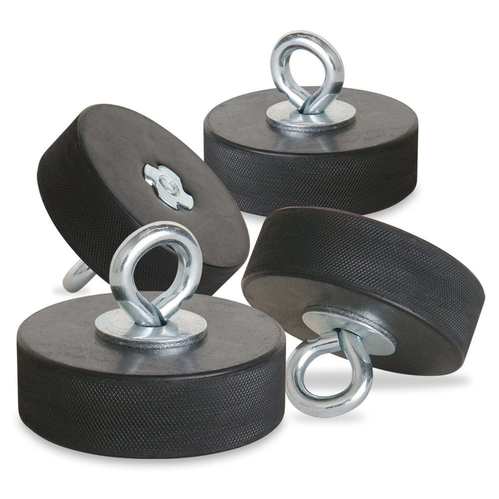

Parts to make the jacking pucks:
5/16 thread dia
2 1//4 length
1 1/4 eyelet
5/16 t-nuts
5/16 washers
Hope this helps.
Howard
