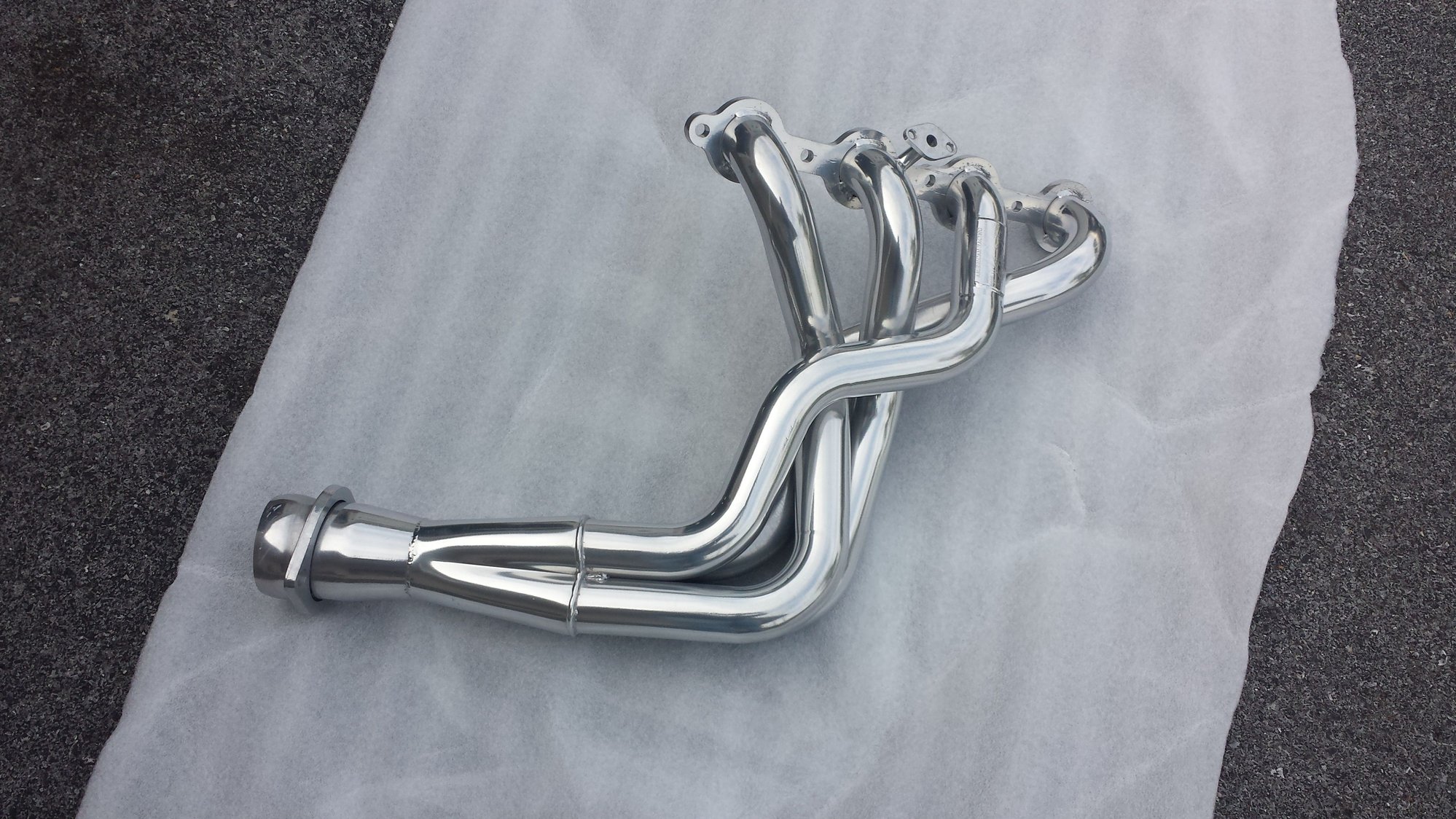

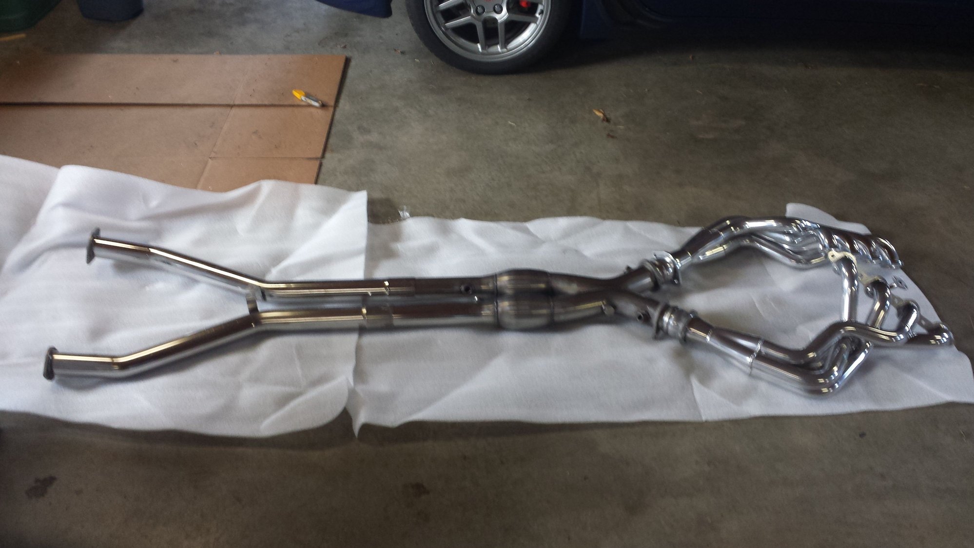

I installed ARH 1 3/4in headers and catted x pipe on my 02Z, I had the headers jet-hot ceramic coated for heat. I also installed a spark plug boot on the wires going to the starter and included the sensor wire going to the oil pan on that side in the boot. I also replaced my original starter with an AC Delco part #88864301, it's a 2 long bolt truck starter, it is smaller in size, and higher torque than the OEM starter for these cars. I paid $180 at dealer after core charge. Yes it's a remanufactured unit from GM.
wires in spark plug sock, was able to install headers with the starter in place
ARH system with coated headers
coated for heat management but love the finish also
