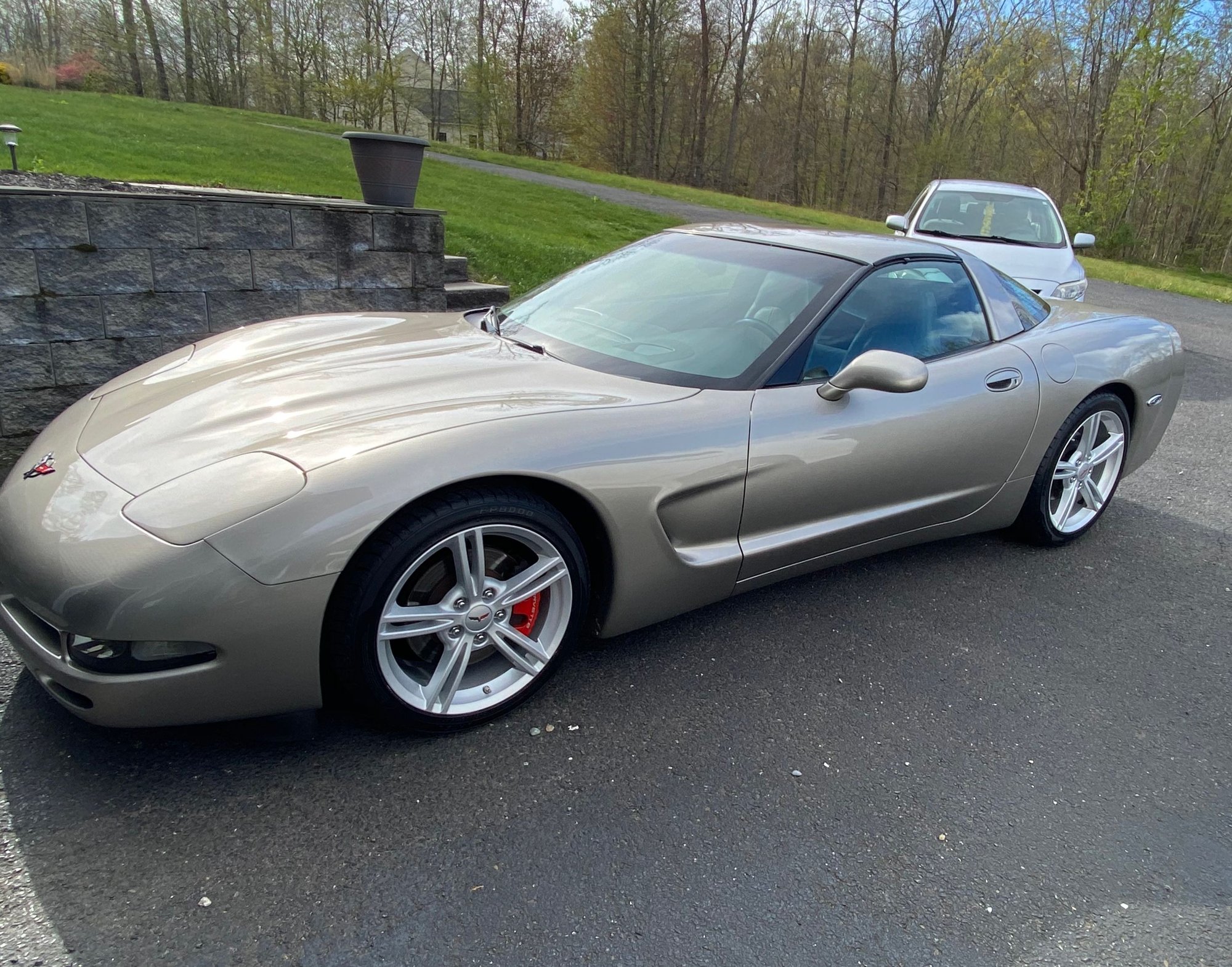

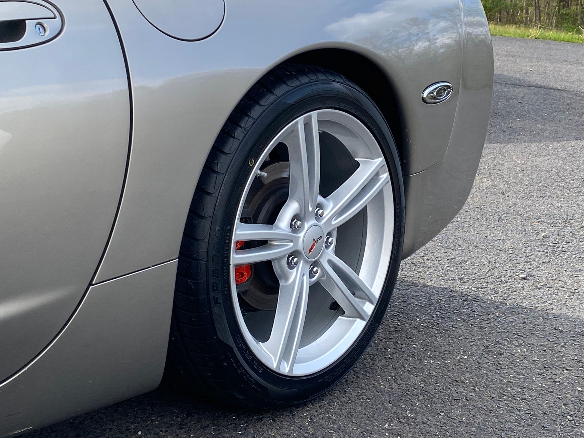

Just did this on my 99. 20mm hubcentric did the trick and is what all the cool guys are using. I have the twin spoke C6 wheels and the rears are right where they need to be. About .75 inches was needed.
Are you putting those on a Base C5 or a Z06?
Did you add a spacer to the front?

Base coupe. Fronts were same offset as the C5 wheels. Spacer for the rears was all that was needed. 3/4” was just right

Very nice! Did you have to trim the studs to accommodate the spacer / rim?

I used the same size spacer 20 mm with the split spoke wheels on my C5. The split spoke rims have a recess on the back flange that allows the studs to fit without hitting anything. So depending on the wheels you use, if there is a recess you won't have to trim the studs. If the recess isn't large enough then you'll have to definitely trim them.
