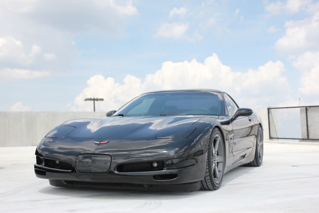

^1” spacers on my c5

Just did this on my 99. 20mm hubcentric did the trick and is what all the cool guys are using. I have the twin spoke C6 wheels and the rears are right where they need to be. About .75 inches was needed.
