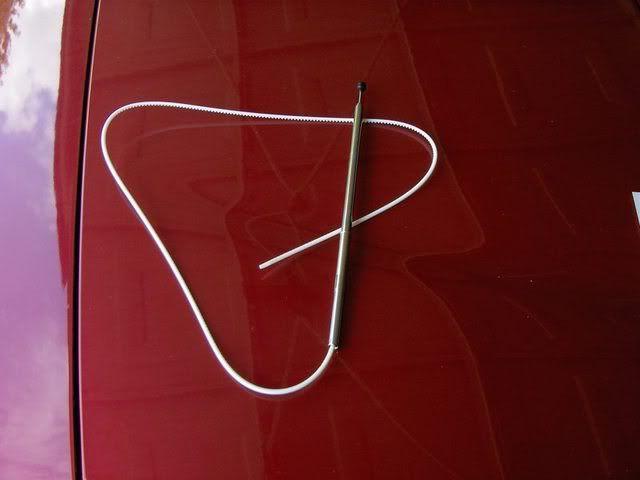

I have never seen other than the entire assembly for sale, but also know most power antennas have problems with the nylon teeth getting old and falling out, and the mast section only, with the geared ribbon attached, is the commonly used repair.
If the motor works, it might be possible to find a replacement mast and gear drive, these are common parts with radio installers. I don't know who made the antenna originally, but that is my plan for the future. My antenna is getting tired.

If the motor works, but antenna doesn't go up or down, the mast can easily be replaced for under 20 bucks. Did mine and now it works like new. Just an option.

...I just ordered my kit tonight off ebay ($17.99 shipped).
