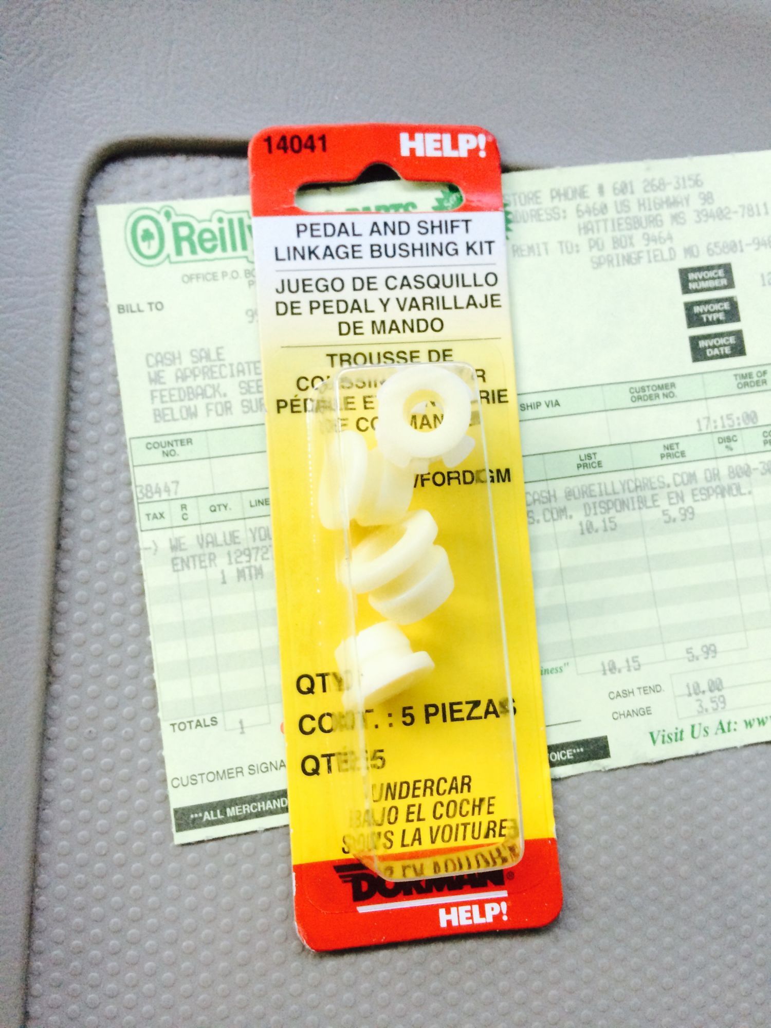

Chances are this is all you will need to repair your cable...
http://www.ecklerscorvette.com/corve...1997-2004.html
And here's a cheaper alternative :
http://www.dormanproducts.com/itemde...1&SEName=14041

Cable looks good on transmission end , and shifter end, cable moves back and forth when I shift .could it be possible sheath that covers cable slipped ?

From: Brea CA
Just dealt with this. the cable sheath came out of its mount on one end preventing the shifter from working properly.
Had to drop the exhaust and tunnel plate to change it.
Gary

Good move replacing the cable. I replaced the plastic bushing on the shift lever earlier this year. Thought I was all set for 6 bucks, but then it failed again 2 months later, luckily it came off in my driveway. Looking back I'm sure the cable problem was the culprit and was putting pressure on that bushing causing it to fail again.
