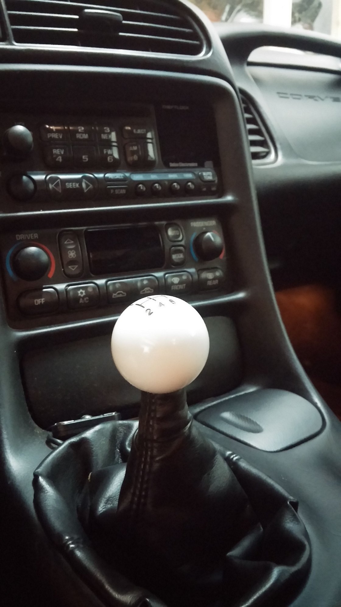

I cut 7/8" from the top and then another 7/8" from the bottom. The shifting was shortened significantly. I also make my own ***** so the c6 was not a factor.

I also cut down my factory shifter by IIRC 1 1/4", and bought a **** from TwistedShifterz with deep threads so the **** sits low.

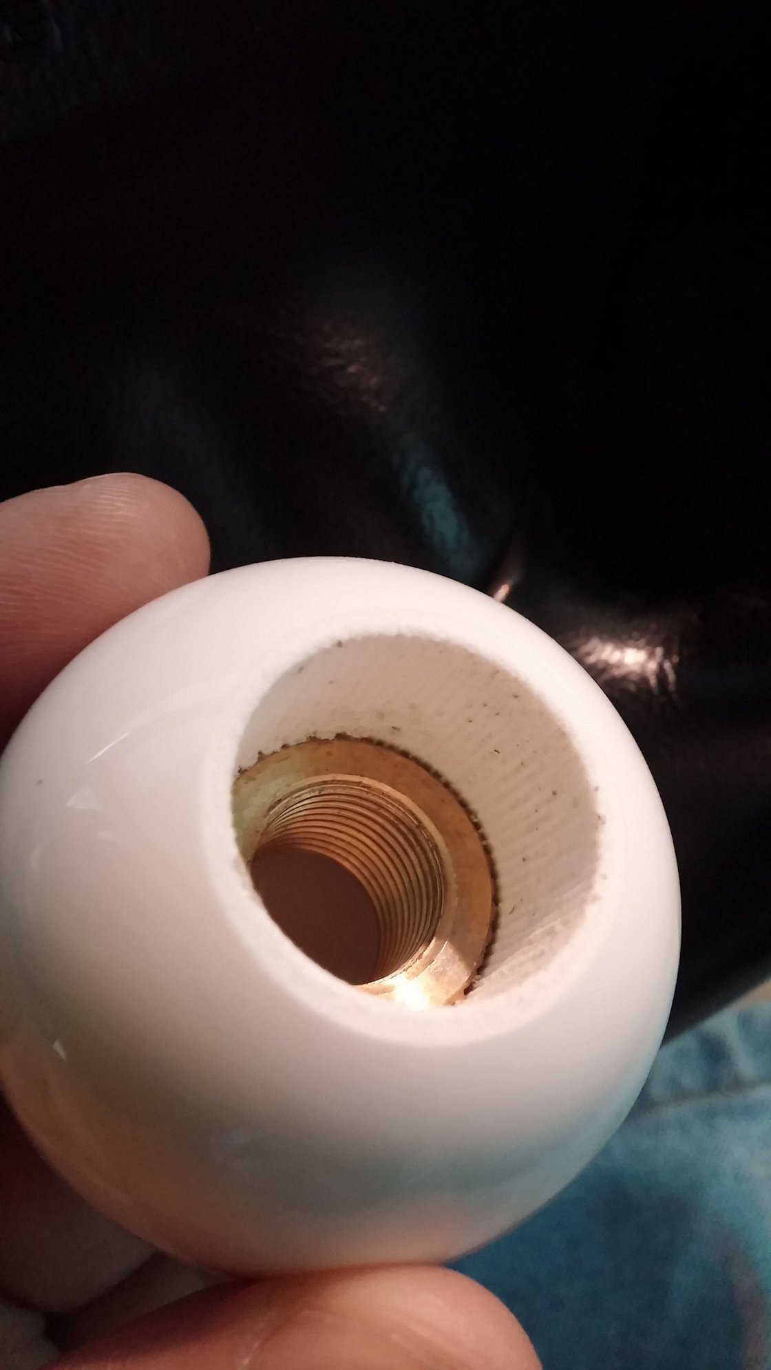

The stock shifter as you know is horrible so a long time ago I put in a Hurst. It is adjustable but even with the lightest settings it was still way too stiff. It felt precise but tookalot of effort to shift it and it never loosened up. Then it started vibrating at certain speeds. Hurst's answer was that the way they are and you can't fix it. Eventually I went to a C6 Z06 shifter. It is a direct bolt-in. I threaded it for a C5 ****. I threaded it allthe way down to where it gets fatter. I had a custom made **** that I wanted to use from my C5 shifter. This shifter is perfect, precise without extra effort and the position is great. Reasonable cost too. You can get a great price from TPS Mak. Also, for people who want a great selection of custom ***** go to www.speedawg.com.

Exactly what I do with mine. I bottom the threads to about 1/8" from the top. Some i flare at the bottom so they overlap the boot.
