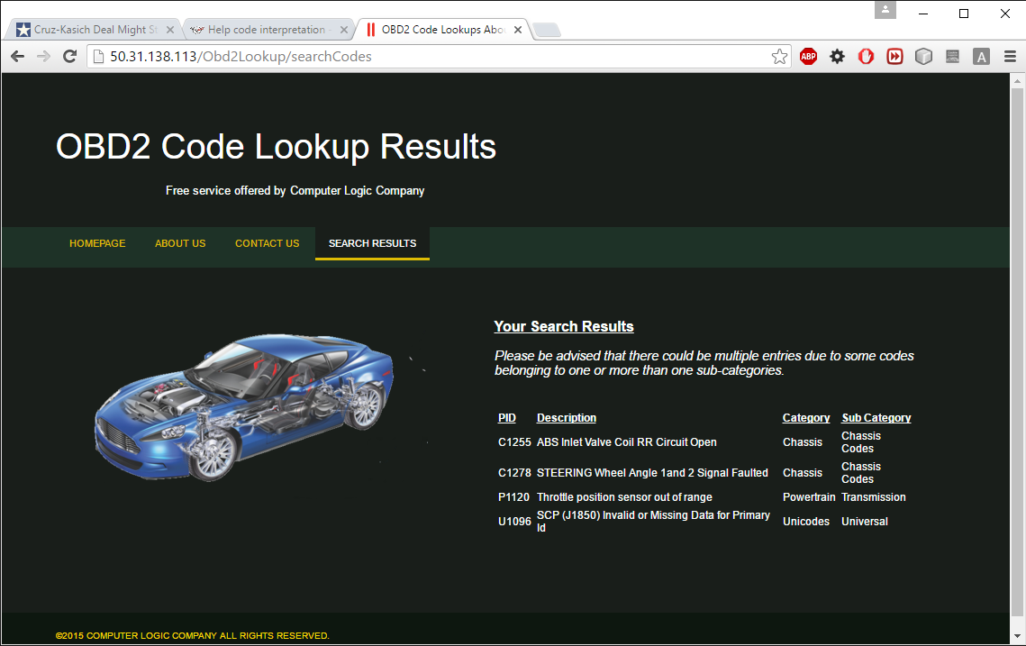

For future reference
http://computer-logic.us/Obd2Lookup
Here is a screenshot
