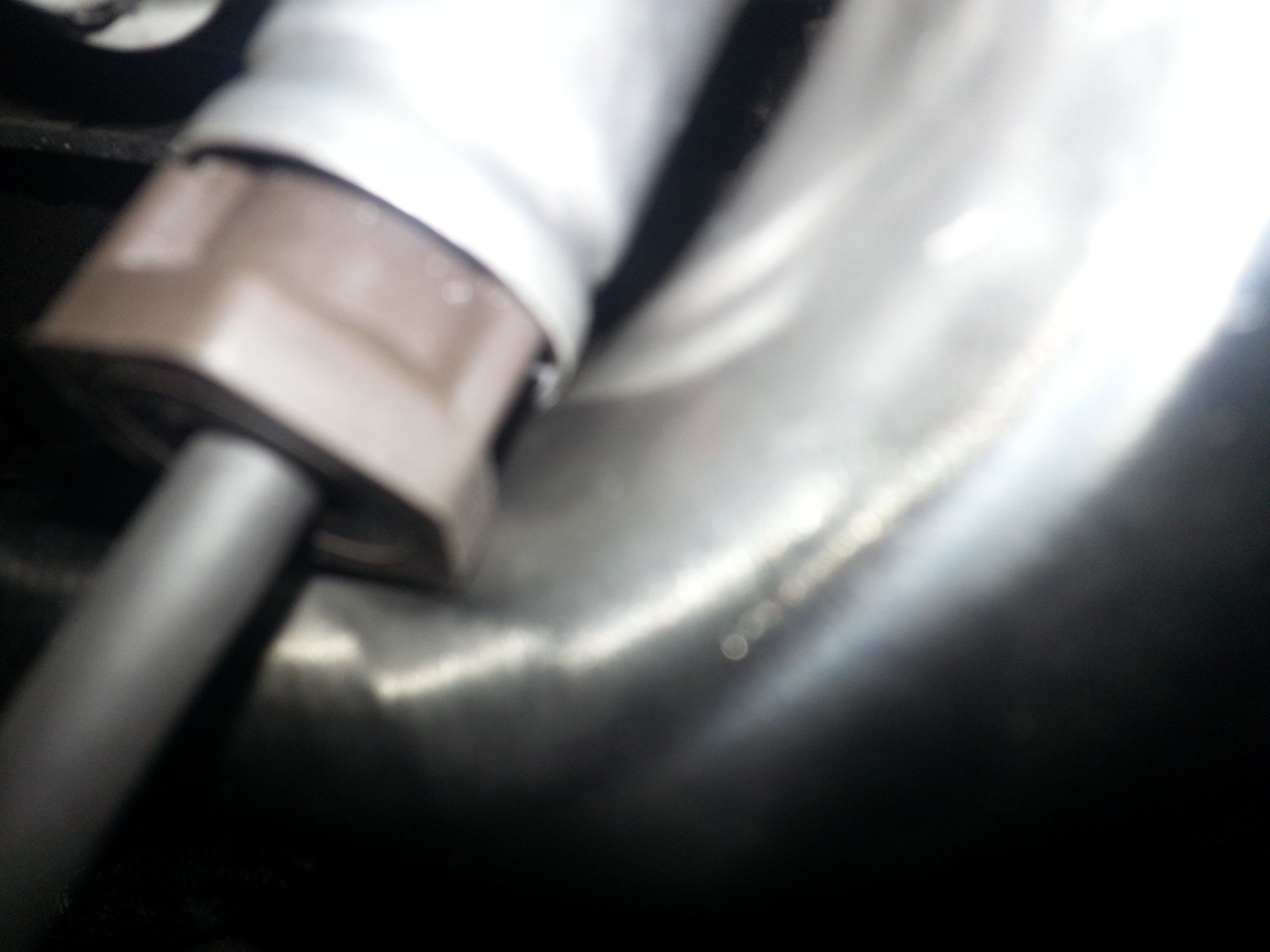

02 sensors connect without touching by about a millimeter. Still have the same plug resting on the header tube issue...its actually tighter than before ugghh.
Guess I'll try to live with it, not pulling them off again.

appliance guy's Avatar
appliance guy
Joined: Dec 2015
Posts: 156
Likes: 8
From: Florence South Carolina
To LG headers

Get some Coolsox to insulate that wire from the header, or get aftermarket wires with a 45 degree bend to clear the header. I've had the Coolsox for over 10 years, and MSD wires, and no problems. I've got the older version of Pros, and they're the best, IMO.
