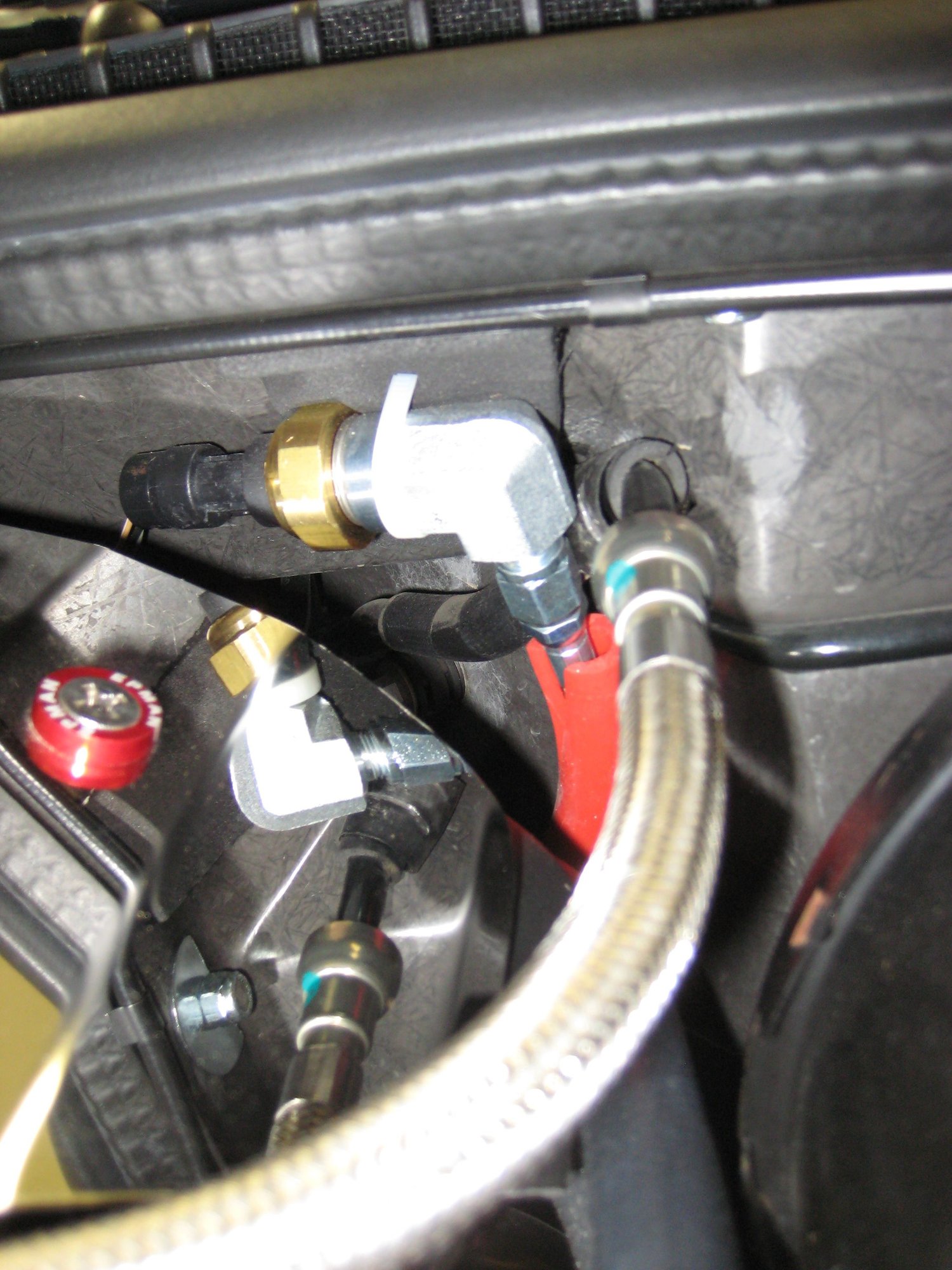

I was going to post this in the tech section but I thought I might get more feedback (or crap,LOL) in the General section. I posted more than a year ago that at this certain overpass/on-off ramps my oil pressure goes to zero, I am first alerted by the DIC with the warning low oil pressure with the dinging, then look to see my gauge on zero. By this time I am past the ramps and everything goes back to normal. This would happen very few times (twice a summer maybe) now the last 7 out of 8 times it happens, only at this particular spot ??? I had relocated the sender when I installed my LS 6 intake two winters ago. Very Very strange, another note is, if I have my Radar detector on it always goes crazy at this spot ????
Should I try a different sender ???? 40 Bucks ???

Perhaps some type of high frequency signal in that area? There is a tiny printed circuit board in the OPS. Never cut one open but it may have some component(s) that could be interfered with by such a signal.
Does the radio or any other electronics have problems or just the OPS and the radar detector?
If it's worth the $40 to you to try a replacement, do it. Not certain a replacement will act any differently.
Nope, nothing else ????

I would try to make sure this is an electrical issue and not an real oil pickup problem. If you feel its just a sensor issue, change it than everything else in the circuit chain. You can try using a heat gun/hairdryer while parked it it's heat related. Also try shaking the harness and the sensor maybe its a bad connection or ground problem. Good luck.

Or temporarily wrap a couple pieces of aluminum foil around the sensor and it's fittings. Not some tiny thing, make a "tent" and make sure it's grounded. Think Faraday Cage.

Make sure your "cage" is grounded. You could use a little 8" - 10" test lead that has a small alligator clip on each end. One end to the foil and the other to a known ground.
