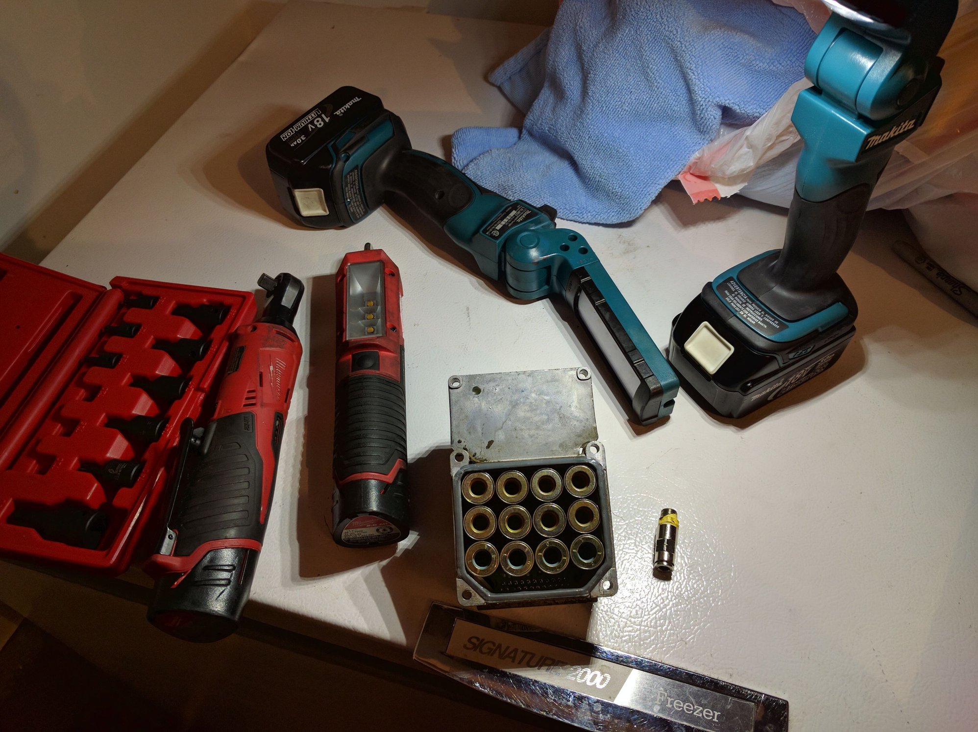

Got the ebtcm fixed, silicone and back in. Waiting for the new methanol injector and found I need to tap the white and black wires on the aem 4 pin plug. Going to add a female t tap to each wire and then plug them into port 1 and 5 on the hptuners mpvi plug.
Couple pics of ebtcm...

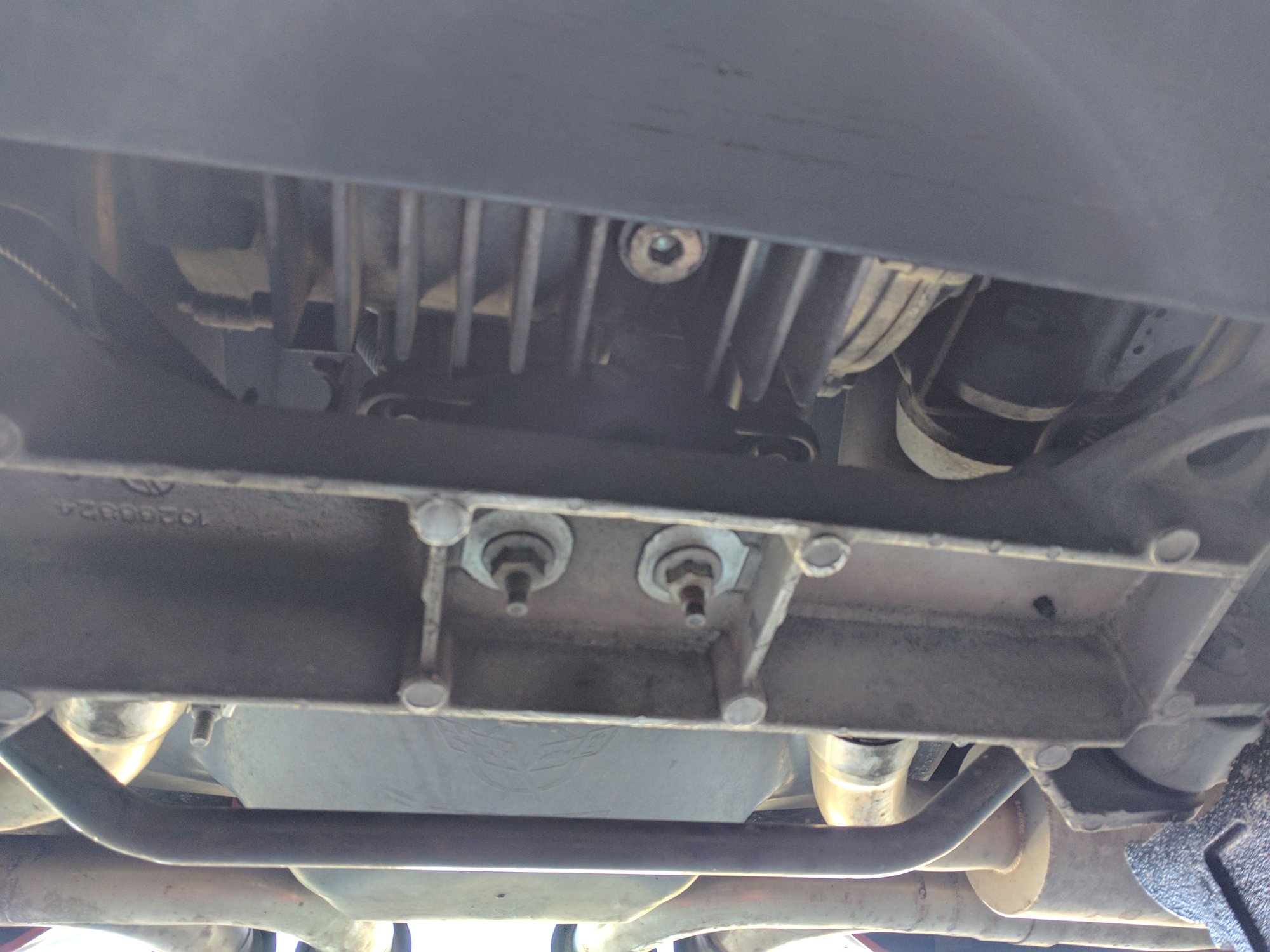

Just completed installing the engine mounts, took notes on a couple of areas throughout the install that will help save time if/when I ever have to do it again. There is information on Intake Manifold, Supercharger, Engine Mount and Upper control arm DIY/Install along with a collection of torque specs.
They are attached in the word document with references for some of my material. Hope they help someone else down the line, if not at least I will have documentation the next time I do this cause I always seem to forget the tricks of the trade by the time I have to do it again.

Have some feedback regarding the mounts, they did noticeably increase NVH at idle. Not a lot but it is noticeable. Car feels a little more responsive.

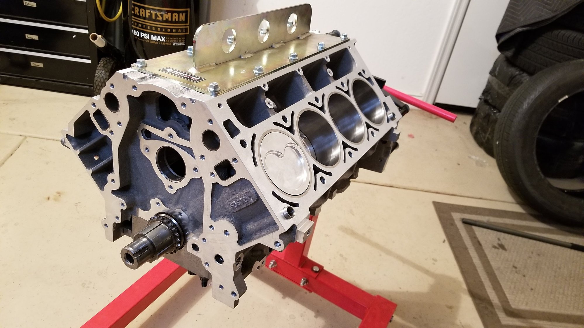

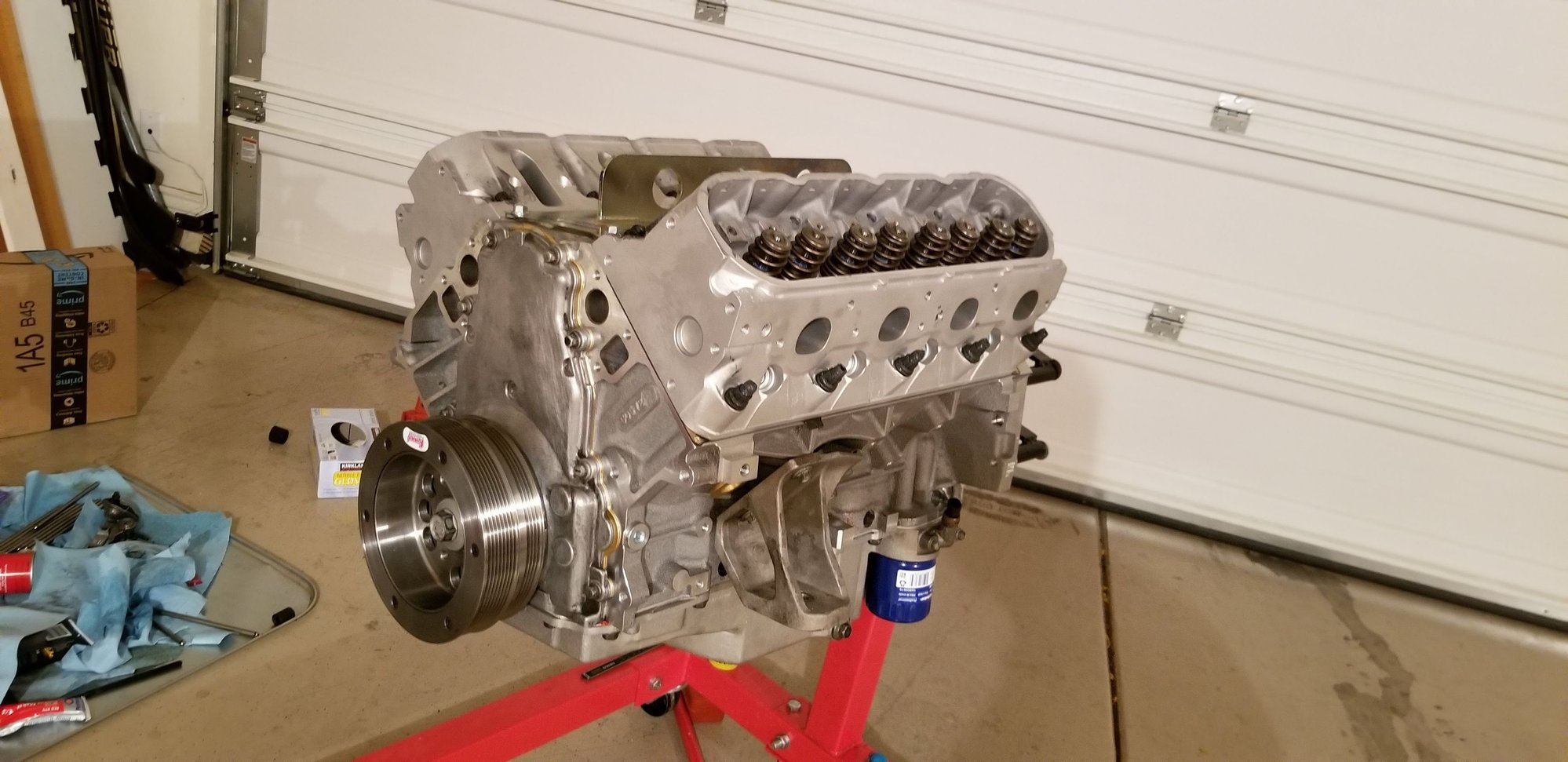

Been a long time since updating this thread. Need to do it so I don't forget. I blew my engine about a year and half ago, piston 3 and 7 had cracked ring lands. I had a methanol injector failure and did not gap my rings for boost during my first rebuild. Also may have had a short to injector 7 pigtail because of a broken wire. School of hard knocks, was determined to do a better job on round 2 and be ultra thorough.
Below are my notes, rebuilt shortblock with with 3.903 Lunati forged pistons-20cc dish, Lunati rods arp 2000 bolts, arp main and head studs and clevite h bearings with rings gapped at .020 for boost. Main and rod bearings clearances set to .020-.021. Switched to ls3 oil pan, notched windage for arp studs to clear, put on c5r timing chain. Put on new 10295 oil pump and aligned it.
​​​​​​Upgraded balancer to a summit one used arp crank bolt, pinned it, btr trunion kit, pac 1218 springs and vengeance cam. Replaced valve guides and intake valves to Manley. Measured ptv at .210. Installed rockers using EOIC method. New ls7 lifters and trays.
Replaced crank position and low oil level sensors. Used new Gaskets throughout, removed ops extension because the braided line leaked. Installed dewitts radiator and spal fans. Replaced all Coolant hoses and Coolant tank. Replaced flywheel with fidanza light weight one, measured for clutch shim. Installed new tr6 plugs and Hinson wires with air gap, new pcv and one way check valve between catch can and IM.
Trimmed supercharger shroud, replaced all tensioner pulleys on supercharger. Had injectors flow tested and cleaned. Replaced pig tail to cylinder 7 fuel injector. Replaced brake lines, switched to oem pads. Running 10w-40 oil. Replaced supercharger oil. Used redline power steering fluid. Added acdelco Coolant dye in case of leaks. Fixed ac not blowing cold by replacing hose from back of IM to pcm. Installed Hinson shorter engine mounts. Did big 3 0 gauge wire upgrade and saw better dic voltage. Switched to speed density tune, picked up Casper harness to break out iat from maf harness.
