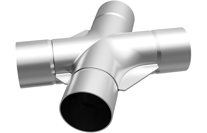

Do you know what the other unit is made out of? We didnt see that info in the link, but our unit will be build completely from stainless steel, and has a lifetime warranty. As mentioned by grantv, all of our products are mandrel-bent for the best flow and performance. If your pipe spacing is a bit further apart, we offer the style pictured below, which may be easier for your exhaust shop to install. Please let us know if you have any other questions!

Magnaflow and grant. I am currently running stock mid with a custom axleback. The one from you magnaflow that I have posted. I saw someone selling a stock catback with the exact same one on theirs. So Im sure Itll fit if I get the one with the inlet and outlet set at 2.5".
As much as my setup makes it sound half cammed and half stock cam, I just need to put the x in to smooth it out.
I think that one magnaflow that you posted is more for camaros and firebirds because of how their piping is routed. I need the one I posted for a straighter flow and not so much curves. Ill be ordering it soon. I just wish I could find the site where I found it for 40 bucks.
