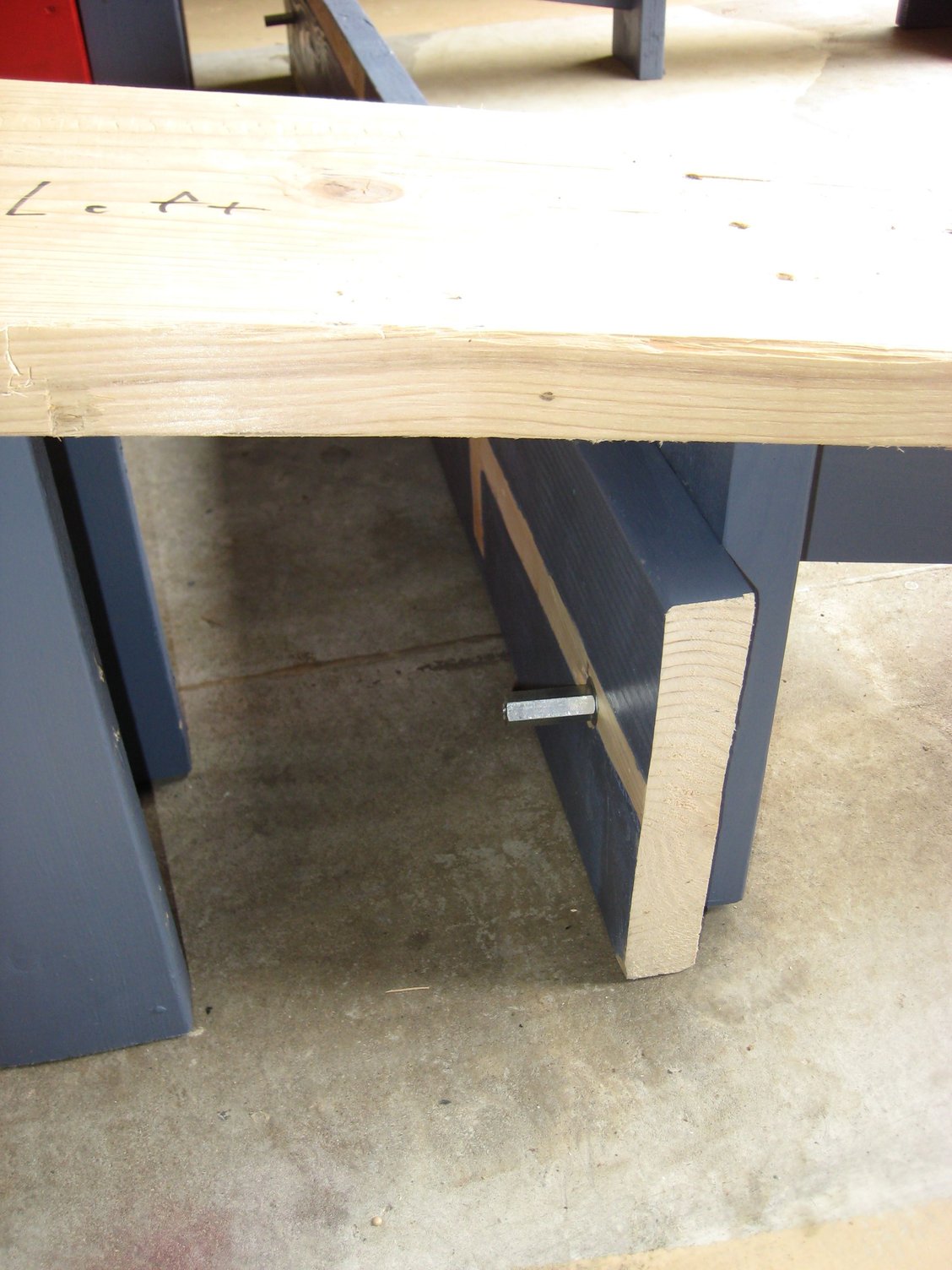

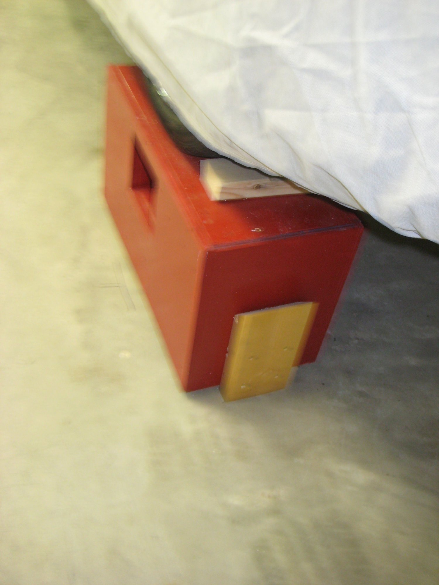

I made them and the car is 21 inches off the floor.

You asked and it's picture full, any questions ask, I think the pic's are self explanatory.

The drive on ramps are 2x12's and 8 feet long the holding system(putting pieces together is what is called "French Cleat" 2 45 degree cuts)

that's what the carts are for, can wheel them anywhere, stack the centers and they go along the wall (don't take much space) and all four corners stack on the same cart, they go between the garage doors no biggie. and winter time the Vette stays on them all winter. The ramps go in my unfinished third stall, and I have no Wife !!!
