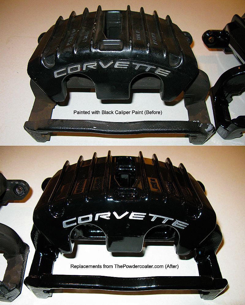

Painted my rotors right after I first bought the car, but finally decided to go the powder-coating route several years ago to eliminate the maintenance.
I feel your pain removing the Caliper Bracket Bolts. I tried everything as you did. Tried breaker bar, extender, and even finally bought a more powerful impact wrench - NOTHING! I finally decided that they were "welded" on! Then I read a post which suggested applying "heat" to the bolt heads first. In desperation, I tried that carefully using a Propane torch and they all came out like "butter" with the impact wrench once that red Locktite was softened by the heat. I also replaced my rotors later after I had the powder-coated calipers installed, but switched to using a Heat-Gun over the Torch to help protect the powder coating and that worked just as well. So "heat" is the secret (as Bill suggested).
I also had the Spring Clips pop off when removing the rear rotors, I found that inventing some new profanities helped!
New calipers with old rotors (rotors have since been replaced)...

Overall, I'm not ecstatic about the final product. It's looks good, but I thought it would be better. I may decide to get some high heat rattle can paint, and do them again. This time I'd take them off completely. For now, they'll stay as is.
