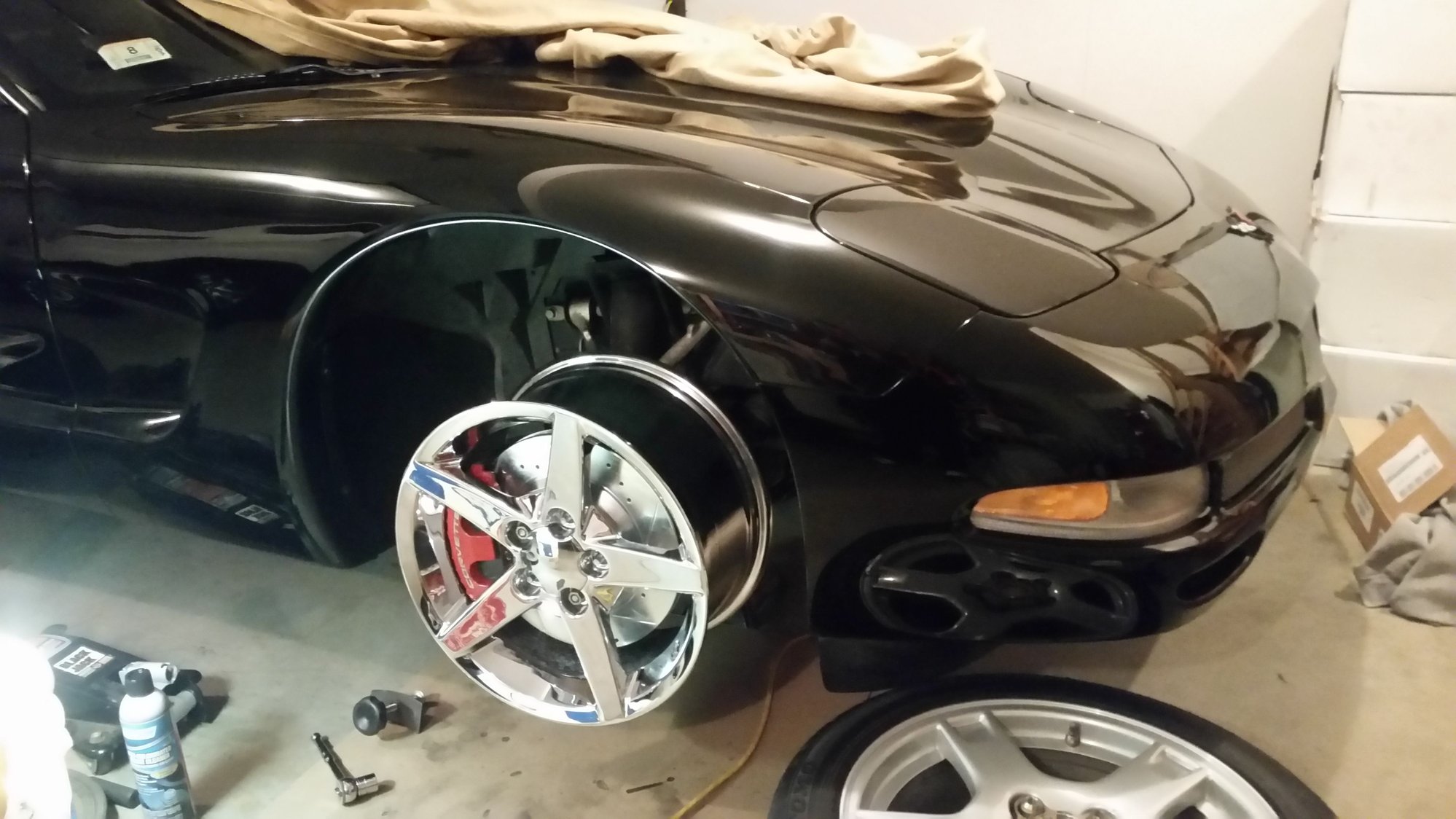

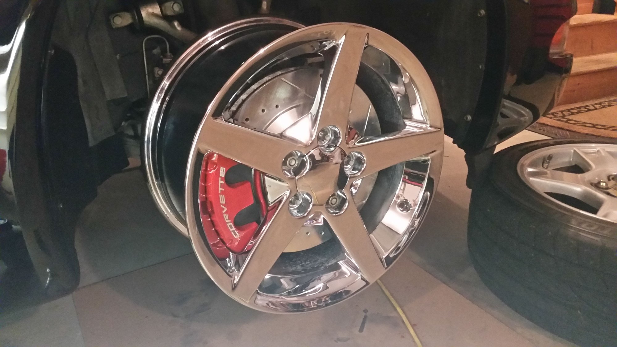

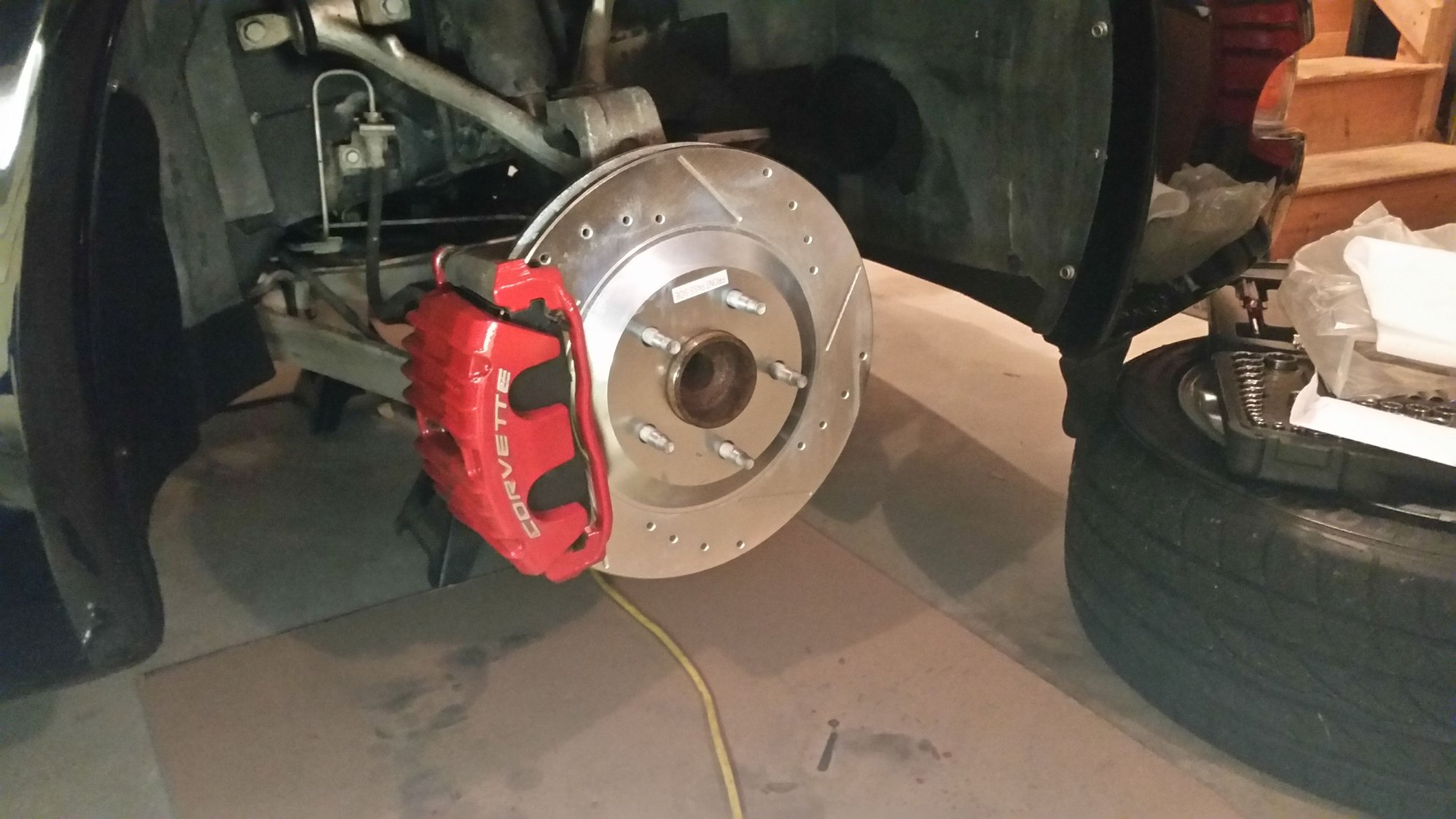

Got into my "to do list" last week (had the week off from work). Started with the easy stuff, like soldering the HVAC so now I have a bright display again!
Installed my stainless vent screens. Super easy and I took the advise of several members and used Velcro so removal for cleaning will be easy. I picked up two packages of oval shaped, low profile self stick Velcro in the craft department of the local Walmart. Cost was less than $5.
Now, for the PIA!!! Yesterday I figured I'd end vacation with doing my pads, rotors and painting my calipers. Jacked the car up onto my jack stands. Removed all the wheels. Removed the caliper bolts and moved the calipers. Now the @!@**$^@%^! part!!! The damn bracket bolts wouldn't budge! Tried a ratchet, hit it with my hand, then a hammer, nothing! Borrowed a cordless impact wrench..... nope! Buddy brought over a compressor and air wrench..... nada!! Tried a curved breaker bar..... with every ounce of strength I had, FINALLY got them to break loose. Now, I had to this x8 because EVERY !@(*$&@^#$%#@ bolt was tighter than...... well, lets just say they were LOCKED in there! With only 60k miles, I assume they've never been done before.
Add to this, while removing the driver rear rotor, the e-brake stuck to the rotor and I somehow pulled the retainer clip that holds the pads to the hub. Not having a clue how it was on..... I wasted nearly 1.5 hours trying to get THAT damn thing back in place. Just when I quit..... I got it back.
Now, time to prep the calipers and brackets for paint. I got the G2 kit so figured it would be quick and easy. Well, it was easy, but not quick. Cleaning and prep was effortless. Once everything was cleaned and dried, I mixed the paint and reactor and started painting. The little brush supplied doesn't cover a lot of area per stroke. Plus, I couldn't find a comfortable spot to sit, kneel, squat while holding the caliper and trying to paint it. Apply paint to caliper and bracket, move onto the next one. Repeat until I do all four corners. Now, apply second coat, to each corner. Repeat for a THIRD coat. By this point, my back is killing me from trying to position myself to comfortably paint. It was a good 2 hours to paint all four calipers and all four brackets, three times each (and I didn't paint every surface, only those that can easily be seen). Once I was done, I hobbled around my house looking like a 137 year old. I still ache today and I still have to "sand" off the lettering on the front calipers and install the new rotors and pads, and put it all back together!
Now, I just watched the install video for the Vararam CAI, as I was thinking about buying one. Yeah....... not so sure I'll be doing that!
Oh, pics coming after I get it back together!
