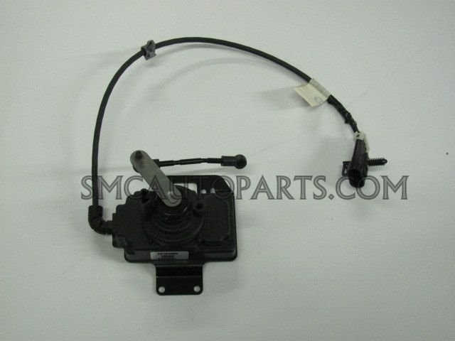

Stock 02' with F45 suspension 75k miles. Top bolt for the arm of the Electric Suspension Position Sensor part #22153636 has broken off leaving it lose and hanging down. (Curious why this didn't throw an error code btw).
Is this part/sensor only found on the F45 suspension? I'm already chasing down a front and rear suspension squeak and have lubed sway bar bushings already. Found some scrape marks on the bottom tube of the shocks.
Interesting the parts department at my local Chevy dealer is now showing 2 of the 4 F45 shocks as "discontinued". Wonder how they would handle the request to replace them? Would they brake down and order simulators or reprogram? I know they're $900!! but what if someone wanted to keep the option?
So.. will I still need #221153636 Electric Suspension Position Sensor if I scrap the F45? Its a $500 part, should I try fix the connecting bolt?Hurting anything with the arm floating in the wind? Would prefer to reprogram vs simulators if I scrap the F45. Will it be tough to find someone to do the reprogram?

Real question is do I need to replace this part (Electric Suspension Position Sensor) if I'm planning on scrapping the F45? I'm I hurting anything with the arm of this sensor not connect to the frame?

What part broke? The Arm or the link?
The upper part of the link is a black plastic cup or bowl - far right in your box. A small bolt with a round head fits in the bowl so it can pivot. Other end of the bolt screws directly into a threaded hole in the upper A arm. This small bolt snapped. Ball end of the bolt still in the bowl-other have still in the A arm. The link not sold separately and the bolt itself is very unique to say the least.

Can this sensor be taken out completely if the f45 is being deleted?

If you take all of it out you will need a Tech II to delete the F45/F55 RPO
