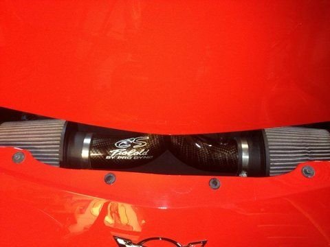

This is what I have. Not a true cai. Am not looking for HP gains. At the time I added this the other ones had not been developed. Anything you go to is better than stock. Stock is very restricted.
